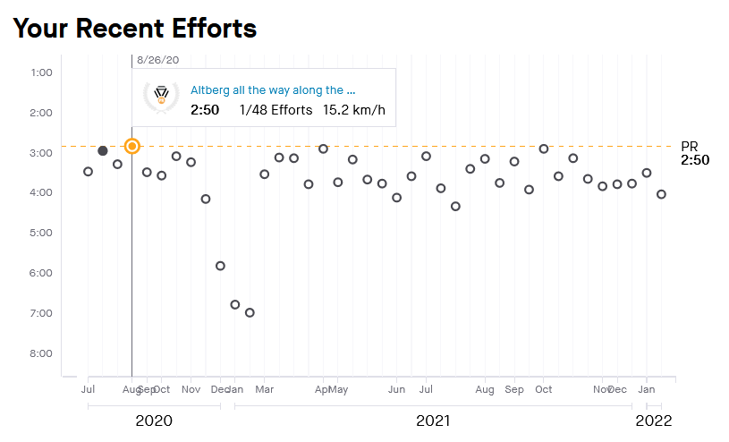

In the mean time, I can share some insights from a downhill segment that I ride on most of my local muni rides: Gubristunnel the real DH | Strava Ride Segment in Regensdorf, Switzerland. It’s quite bumpy with roots and some rocks, but nothing too extreme. It can be quite muddy depending on the season. The part in the middle is very flat and requires pedaling.
In total, I have ridden this trail 48 times. Here are my segment times:
I will ignore those times above 5 mins since I was probably stopped by something or tried a section multiple times. For 30 rides, I had a HRM. 17 rides on a normal muni (mostly 29", a few 27.5", geared 29", and 36"), 13 rides on a freewheel (mostly 29", some 26").
Now some stats:
Average segment time:
  • normal 3:21
  • freewheel 3:49
Average heartrate:
  • normal 133 bpm
  • freewheel 123 bpm
Indeed, on average the FW is slower and I have a lower heartrate riding it. I think this is mostly due to how I ride with the freewheel on my home trails: I try to pedal as little as possible and brakecoast as much as possible, while it would certainly be faster to pedal through certain technical or flat sections. Therefore, the freewheel times are much slower, but also more relaxed.

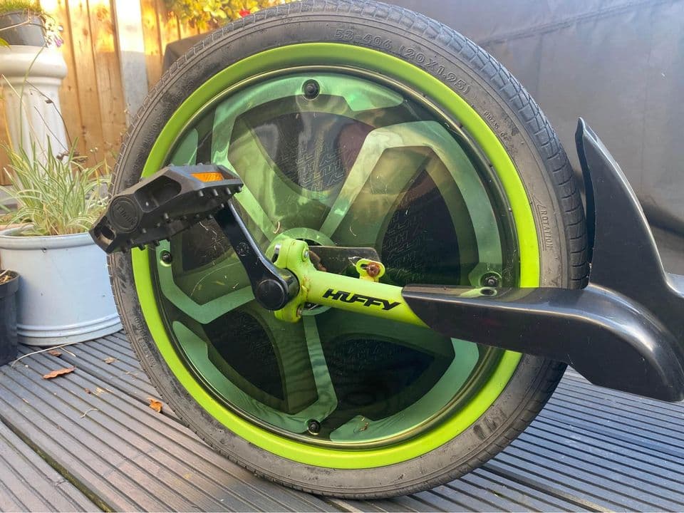

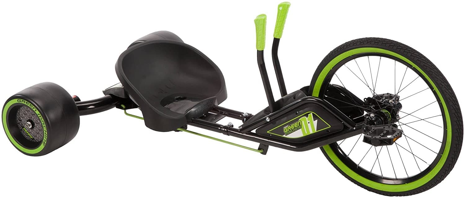

There are drift trikes with a freewheel and coaster brakes (huffy green machine I think), so it could be relatively easy to try one out. There was actually some random guy who built one into a unicycle in Berlin, (found the ad on the classifieds), but at that time I didn’t have the money to buy it out of curiosity.
I don’t think it will be amazing because it will be harder to get the pedals horizontal when you want them to be, but it would be fun to try.
Ooh, I wasn’t aware that Huffy had made one with a coaster brake.
I might have to try and get my hands on one now.
It seems to be the Green Machine RT (p98305-r) which has the coaster brake.
This one with the big chunky steel frame:
You can just see the reaction arm for the coaster brake through the wheel.
Oh, and some of the other ones too.
That makes searching simultaneously harder and easier than it was.
