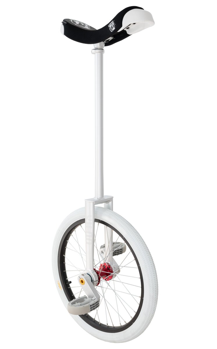

Freestyle Unicycle: QU-AX Profi PEAK
A year and a half has passed since the launch of this model. Are there any real customer reviews? Did any of the freestylers switch to this model? Who thinks about the comparison of this model with the Eclipse / Equinox?
I am thinking about buying a freestyle unicycle, and I cannot finally decide on the choice of a model.
