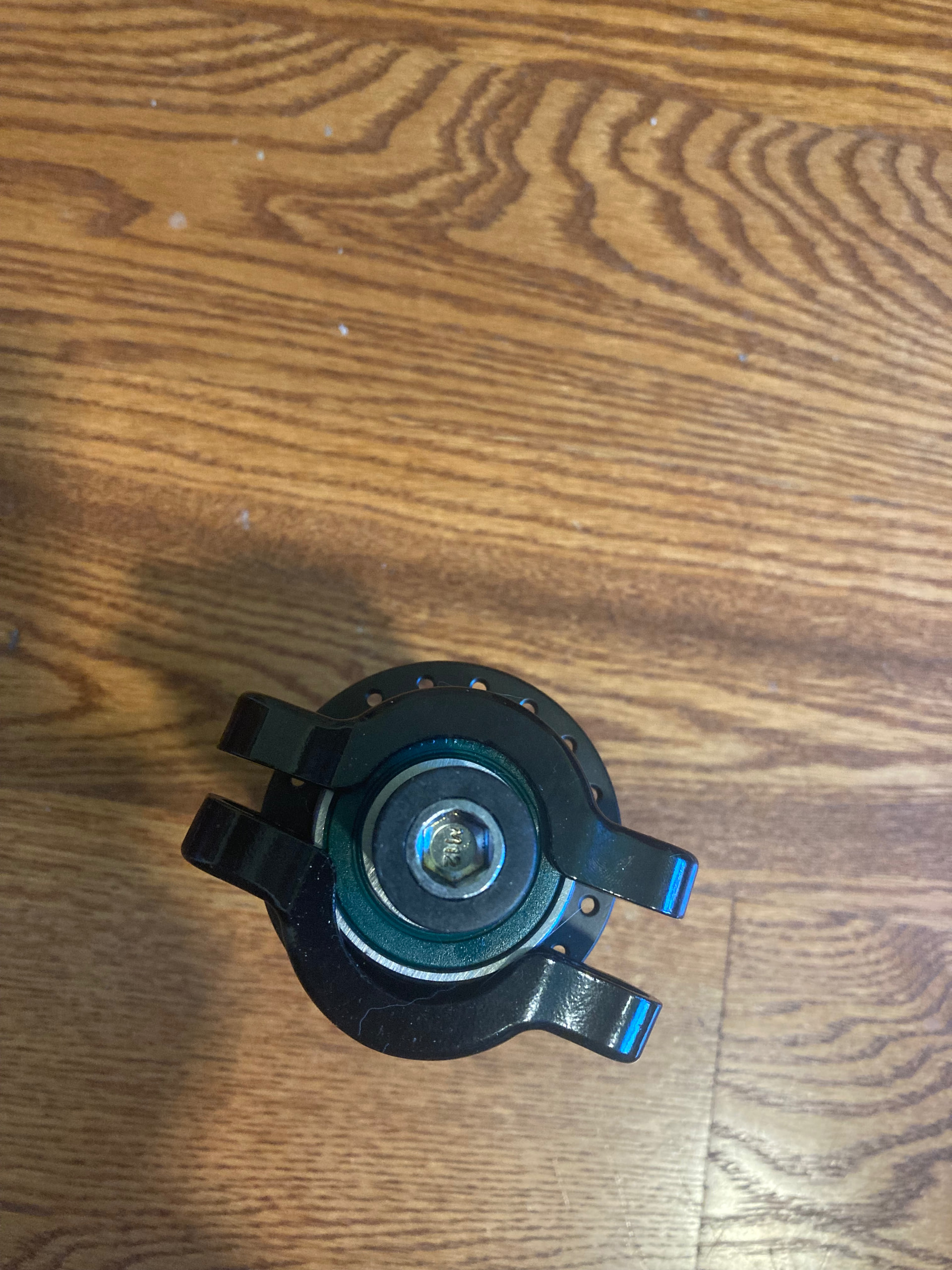

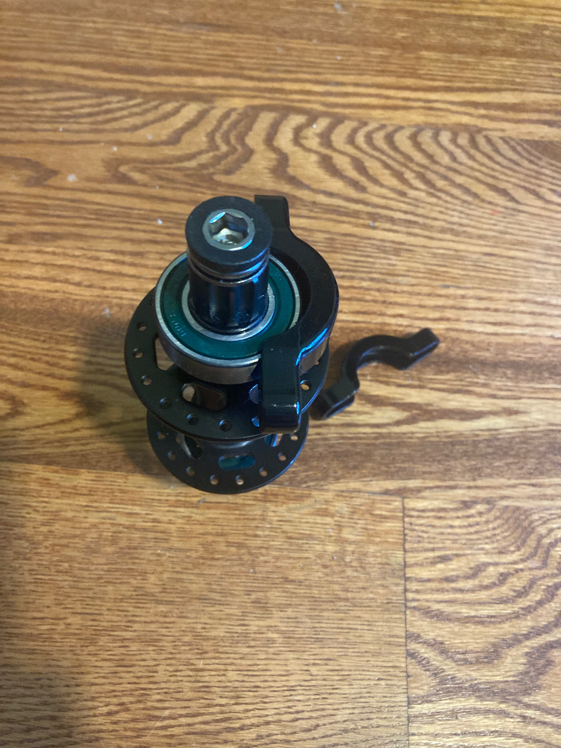

So a while ago I got a urc M4O frame, and today when I tried to put it on a uni I was building, one of the frame bracket parts did not fit on the bearing. I tried both bearings, and two hubs, but it won’t go on. The parts of my other urc frame fits easily, and so does the other bracket. What should I do?

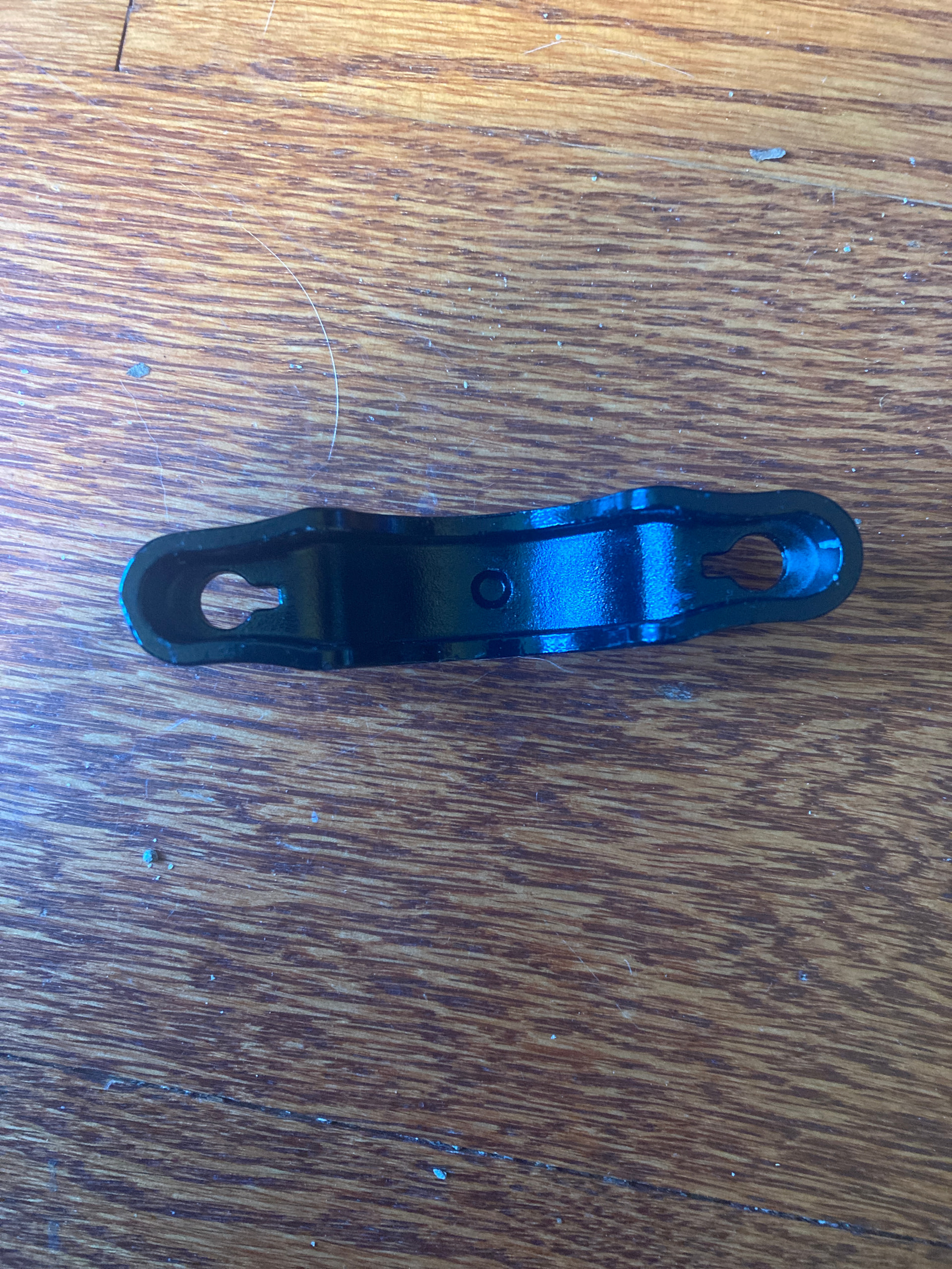

Is there paint on the inside where the bearing fits into the bearing cap? If so, maybe you can scrape off the paint so the bearing will fit in.
I don’t think think the paint it doing anything, it’s just a normal thin layer. The metal is probably just bent
It looks like the bottom bracket in your photo may have been made for a 40mm bearing. I am assuming you have 42mm bearing on that hub. Could this be the case?
Have you measured the difference in mm between your “old/current” urc bottom bracket, and your “new” urc bottom bracket?
Well, the frame fits and so does the other piece, so I’m pretty sure that the frame is meant to fit 42mm
Yes, but is the bottom bracket the correct one for the frame? I don’t know how the M4O warehouse is set up, and whether frames and bottom brackets are held in different “bins”. I’m just wondering if 40mm bottom brackets were matched with a 42mm-bearing frame. Could that be a thing? That’s why I was asking about measuring the bottom brackets.

My first, reaction. Weird.
However, it’s obvious.
The “depth” geometry are different.

As suggested by others I‘d figure out if the shell was made for 40mm bearings. If it is, get a replacement. If it seems to be made for 42mm bearings I‘d put it in a vice to try and flatten it bit. This would at the same time widen the opening a bit; hopefully enough for the bearing to fit.
The shell is definitely made for 42mm bearings. The thing won’t even go on a 40mm bearing without being hammered in.

If all else fails and a hammer is in order put the cap hump up on a piece of wood then with a block of wood on top hit the block with only enough force to spread the cap slightly. You can also use a vice with two pieces of wood to keep the jaws from maring your cap then very carefully tighten to spread the cap. Do it in a very slow calculated manner stopping to check your fit often, continue untill the bearing fits and the holes line up.
