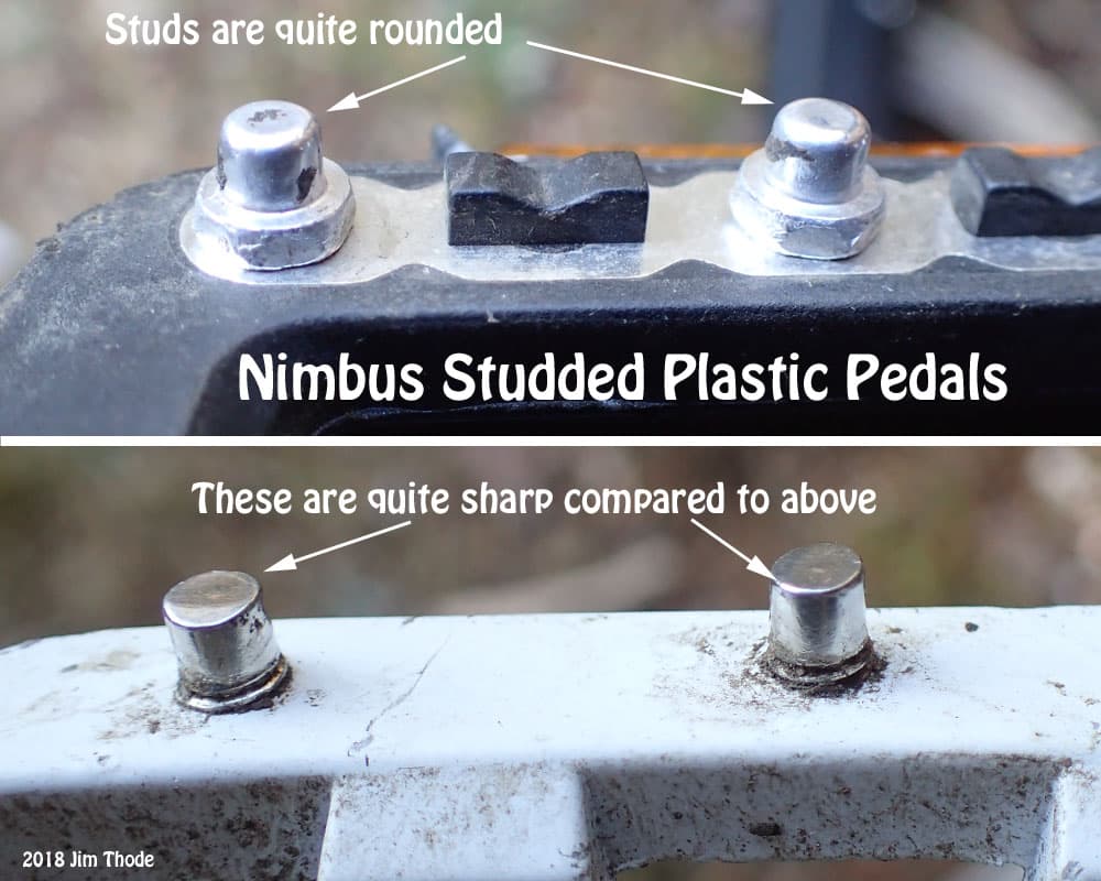

I‘ve got those Nimbus pedals with the rounded studs on my muni. Pretty much the perfect balance between grip and ease of repositioning the feet for my taste (but I can understand that others are missing the firm grip they desire). Interesting fact: The newer version of this pedal has studs with quite sharp edges, comparable to the studs of the other pedal in your picture. But since they are a bigger diameter than the old ones, the grip is the same - at least with my shoes.

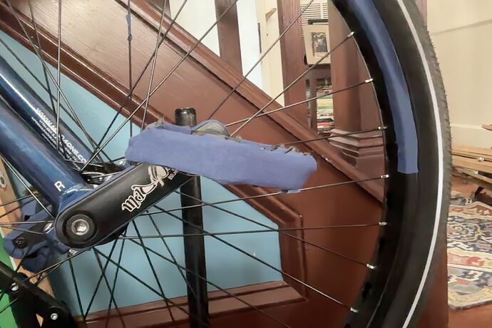

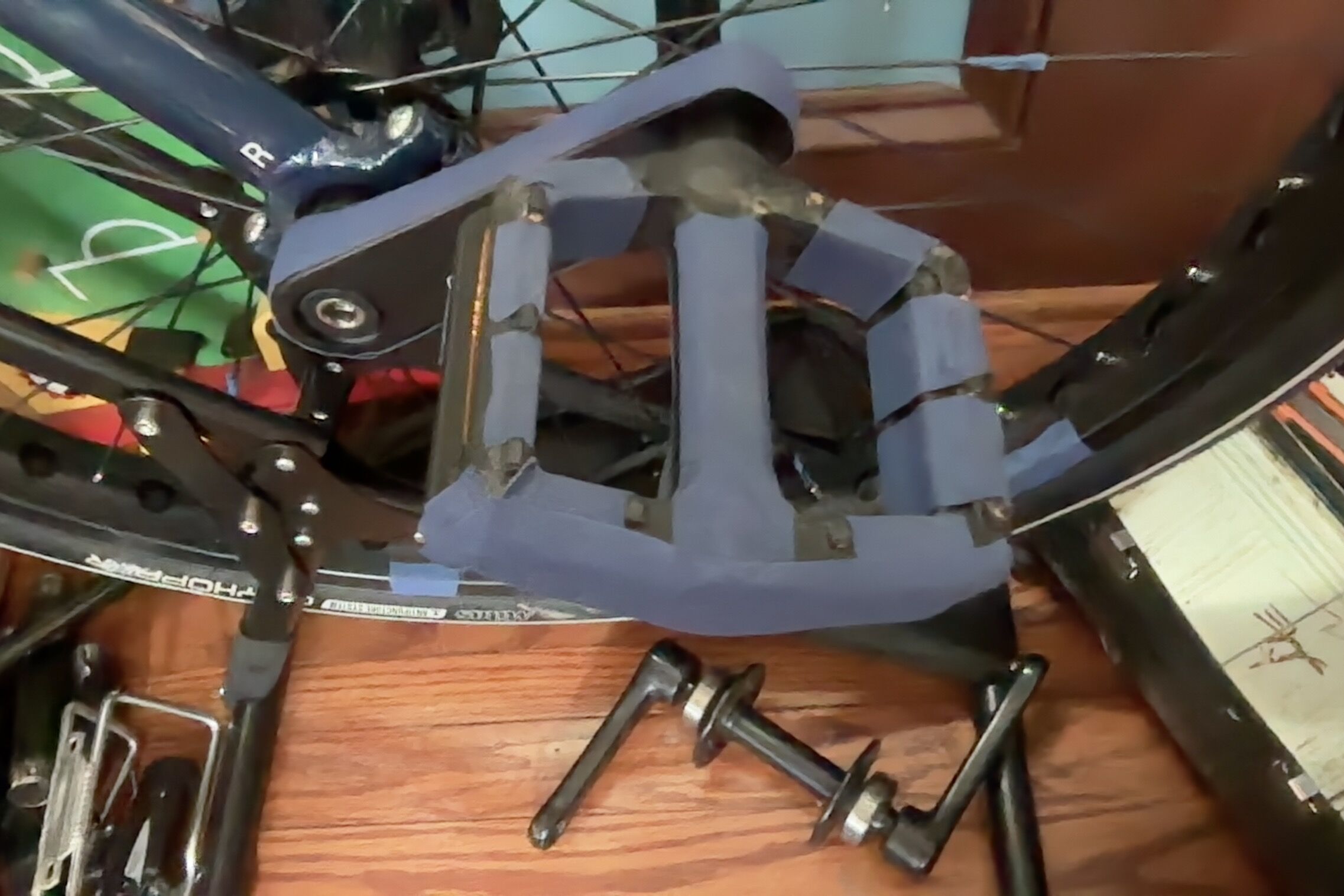

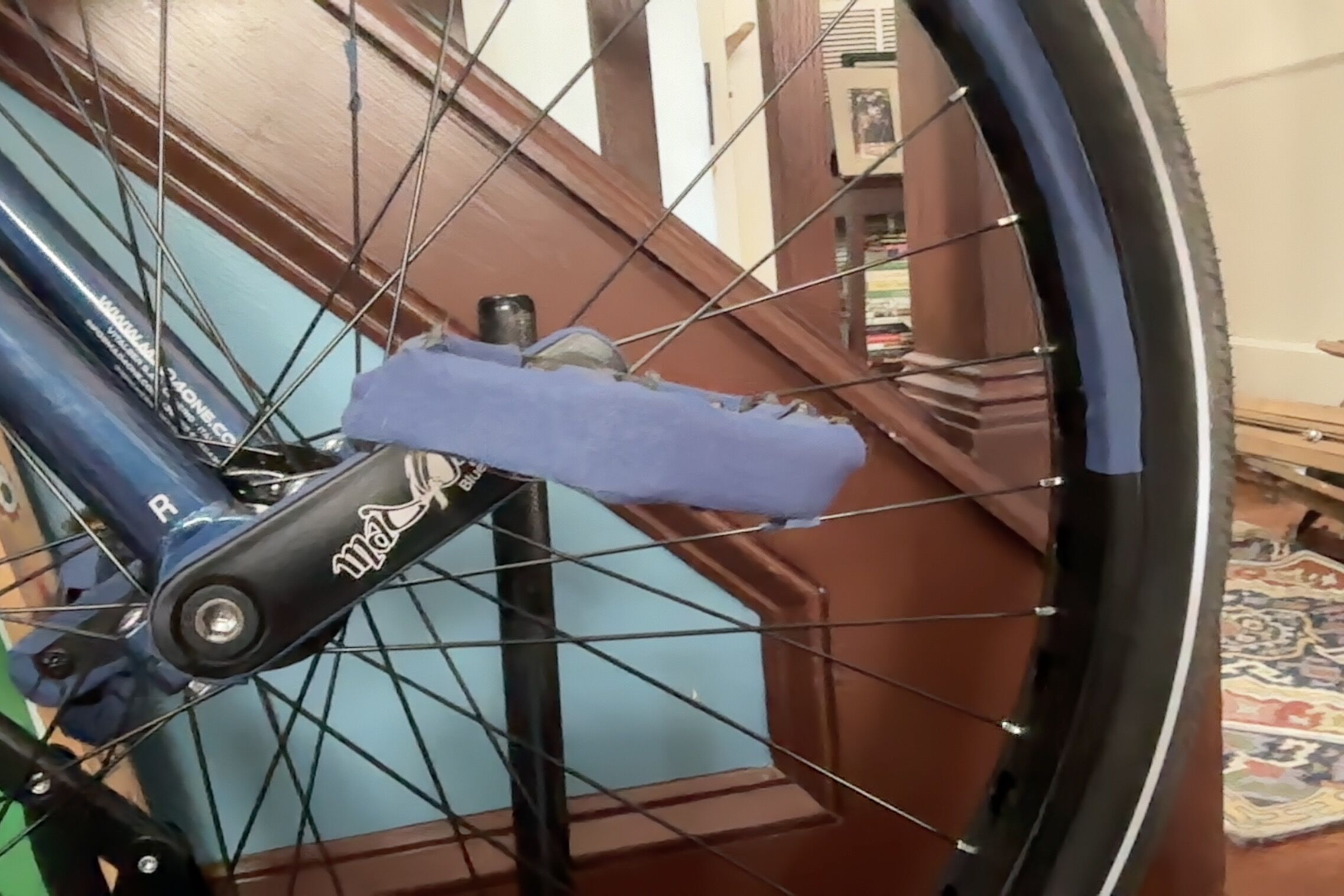

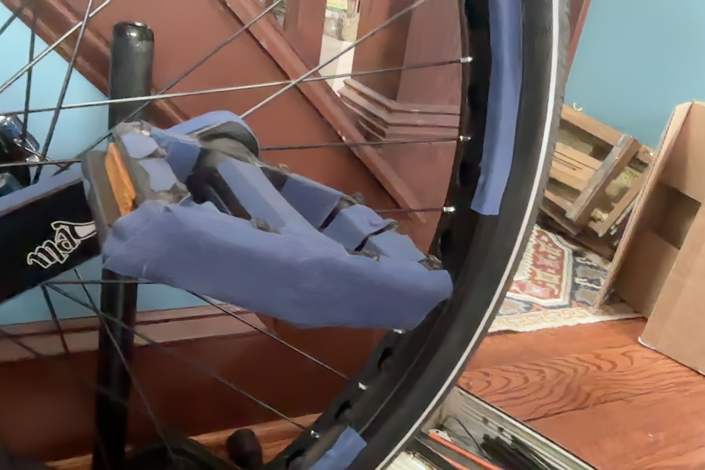

Maybe try hockey tape. It is very grippy, and if you put some on the sides of the pedals, when it falls it doesn’t get ripped up, acting as pedal protectors.
Your uni reminds me of this:
:rofl:
My old roller skates were the same, by the way.
