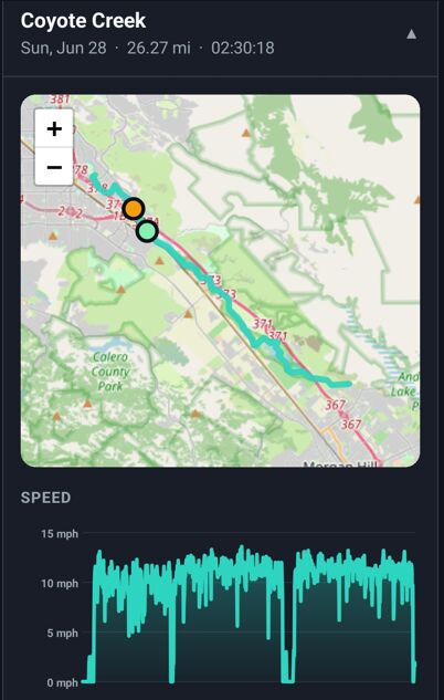

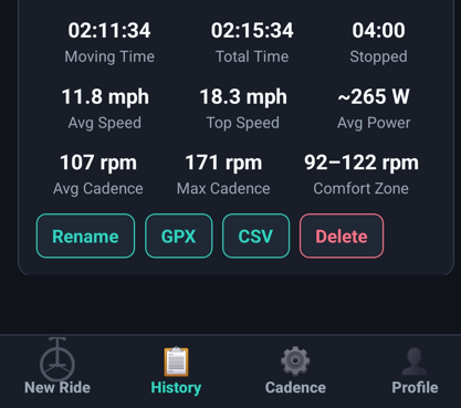

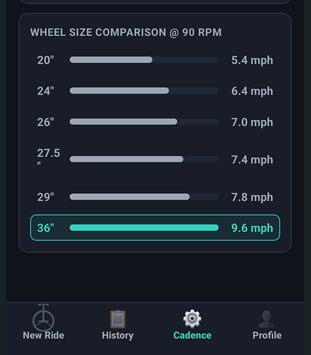

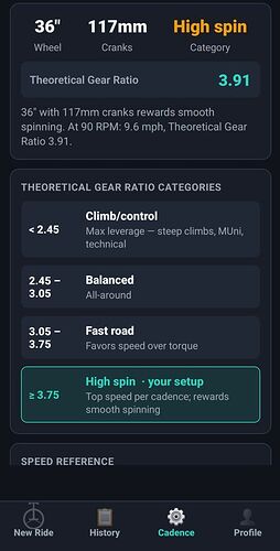

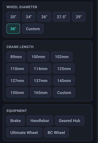

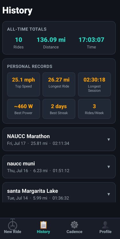

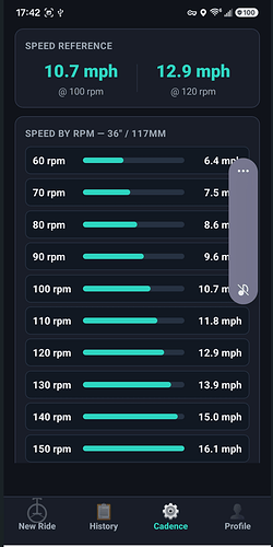

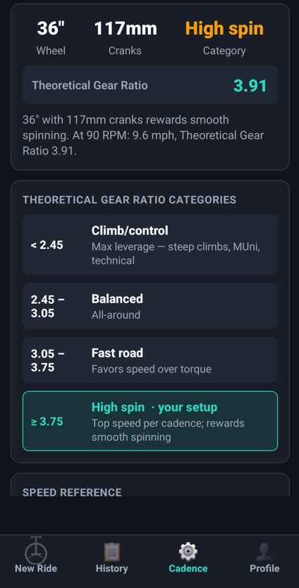

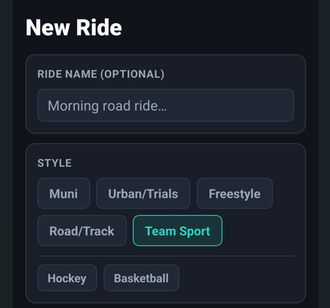

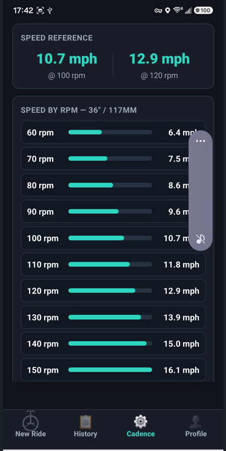

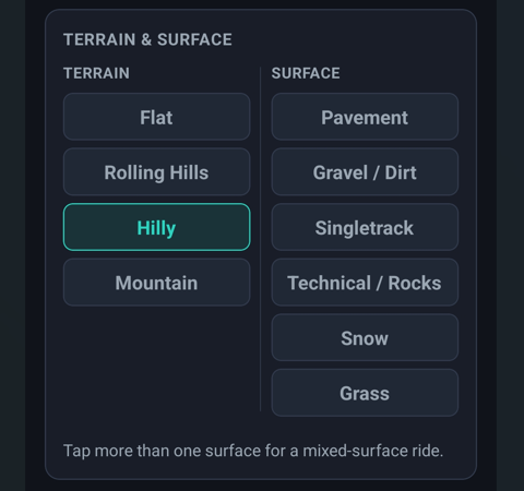

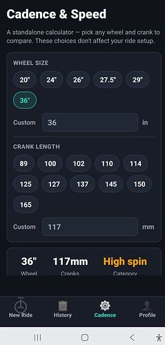

I have been creating a unicycle tracker for the last half year and want to get feedback. Just got back from NAUCC, where I got some great feedback from people. Attached are screenshots of 3 tabs: a new ride tab, a history tab, and a cadence tab. The cadence tab is really charts and data for how different cranks and wheel size will affect riding. I would appreciate feedback to create an app that suits the unicycling community. The profile tab asks for age, weight, experience level, and gives the choice of imperial or metric measurements.

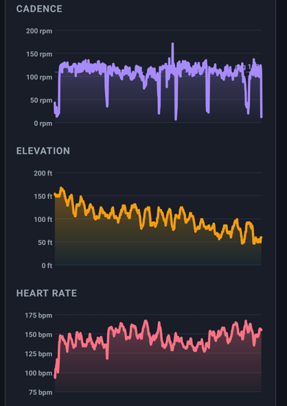

I added a cadence sensor to eliminate faulty data from the GPS that gave absurd speeds and, therefore, cadence numbers. This addresses the very high speeds and cadences below and has given me very accurate data on recent rides. This is a common problem with Strava in my experience, when I ride a MUNI and see speeds over 20 mph from a completed ride.
There is also now a notes section in the current recording ride section and history section.

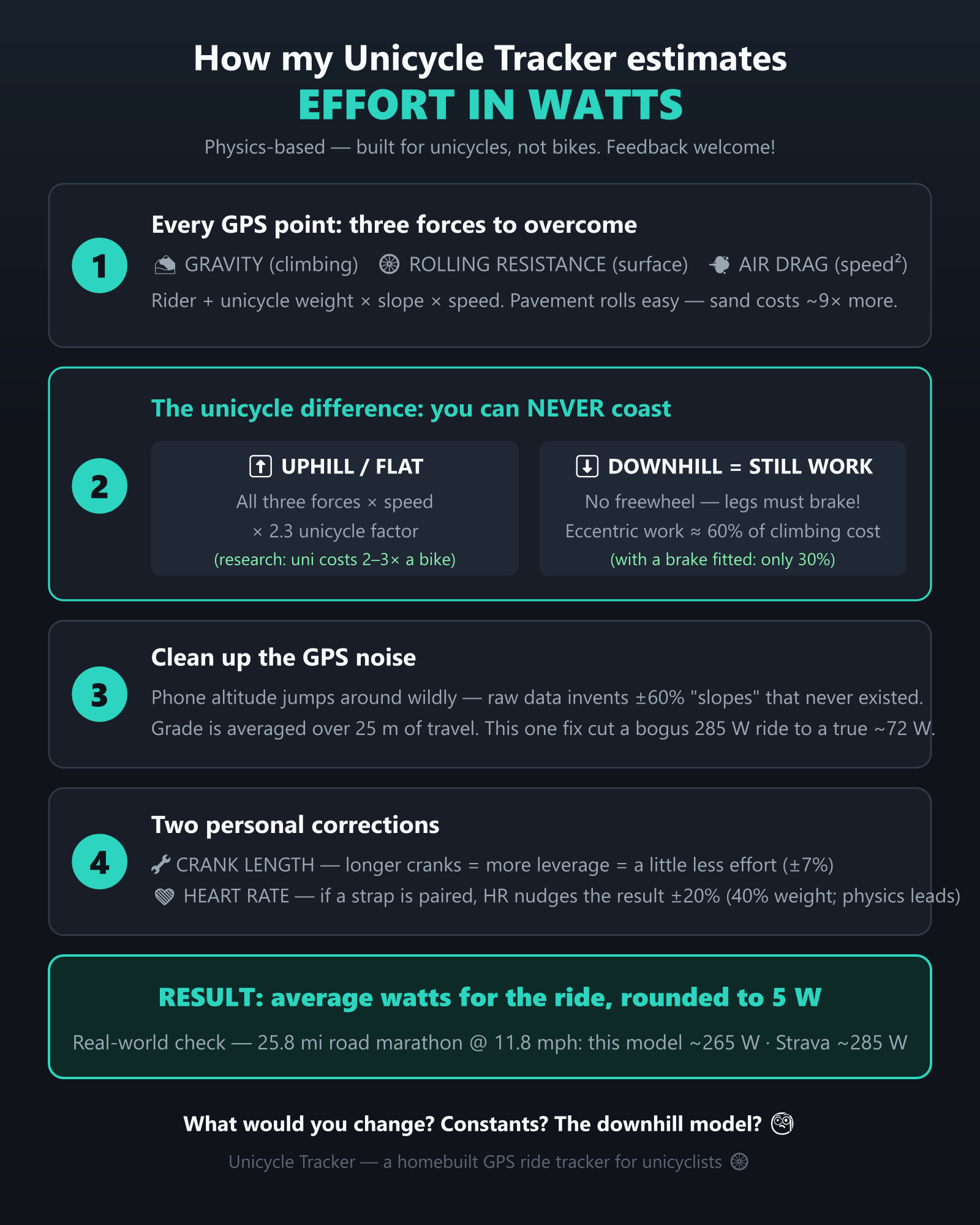

At the very bottom is how I am trying to create unicycle-specific effort numbers (power in watts).
All feedback will be valued.

One thing I like to check is my detailed pace per kilometer with the associated elevation gain/ loss.

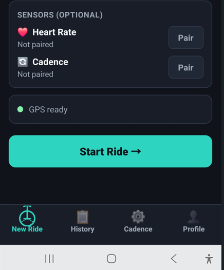

And which devices would be pairable for the heartrate function?
I’m using an older Fitbit to track myself.
I’d be very interested in this. Am currently logging on Garmin but obviously that lacks unique features for unicycles.
Speed/cadence sensors are relatively cheap and assuming they are BT or ANT+ are pretty interchangeable.
Would warn against Garmin cadence sensors as they are only designed to go up to 180rpm. Maybe a feature to treat a speed sensor as both a speed and cadence sensor would be useful for ungeared riding…

I like to be able to see simple graph reports, daily, weekly, monthly totals. maybe the ability to name and define particular equipment and select from a list. is this going to be phone only or phone/web interface. If it added extra features for Cycling, I would probably ditch Strava. (if it is going to add features for cycling, having a pike park feature that automatically deletes the lift miles and elevation would be stellar.

if you don’t have it already, I recommend adding a feature for saving settings for your unicycles and tracking miles on them. That way users won’t have to pick the crank length and wheel size every ride, and they’ll be able to see how many miles they’ve racked up
2-3x power consumption vs bike may be an overestimate. On my G36er, riding at a zone 2 HR, I usually average 11 mph. In the same zone (and same routes) on my bike, I average 15 mph.
Thanksfor the feedback. Great suggestion. I will put default ridership under profile. Also, power measurement observation is true. On flat vig wheel, efforts closer, but on hilly MUNI, effort gap increases. Cheers

I agree with your approach to calculating a power estimate but personally I think it is pretty irrelevant, although I guess users might like to look at their history years down the track and pick out notable ride summaries (by effort, speed, distance, total ascent/descent).
And I guess some multi unicycle owners would like a chance to label a ride with the unicycle they were riding.
I don’t think you should make it dependent on a cadence sensor (a nice thing to have but presumably only a few riders have them), but I agree that a lot of effort needs to be put into GPS raw data (smoothing, adjusting from recent past and perhaps future GPS points, eliminating outliers based on unicycling expectations; maybe even adjusting by checking against map data).
