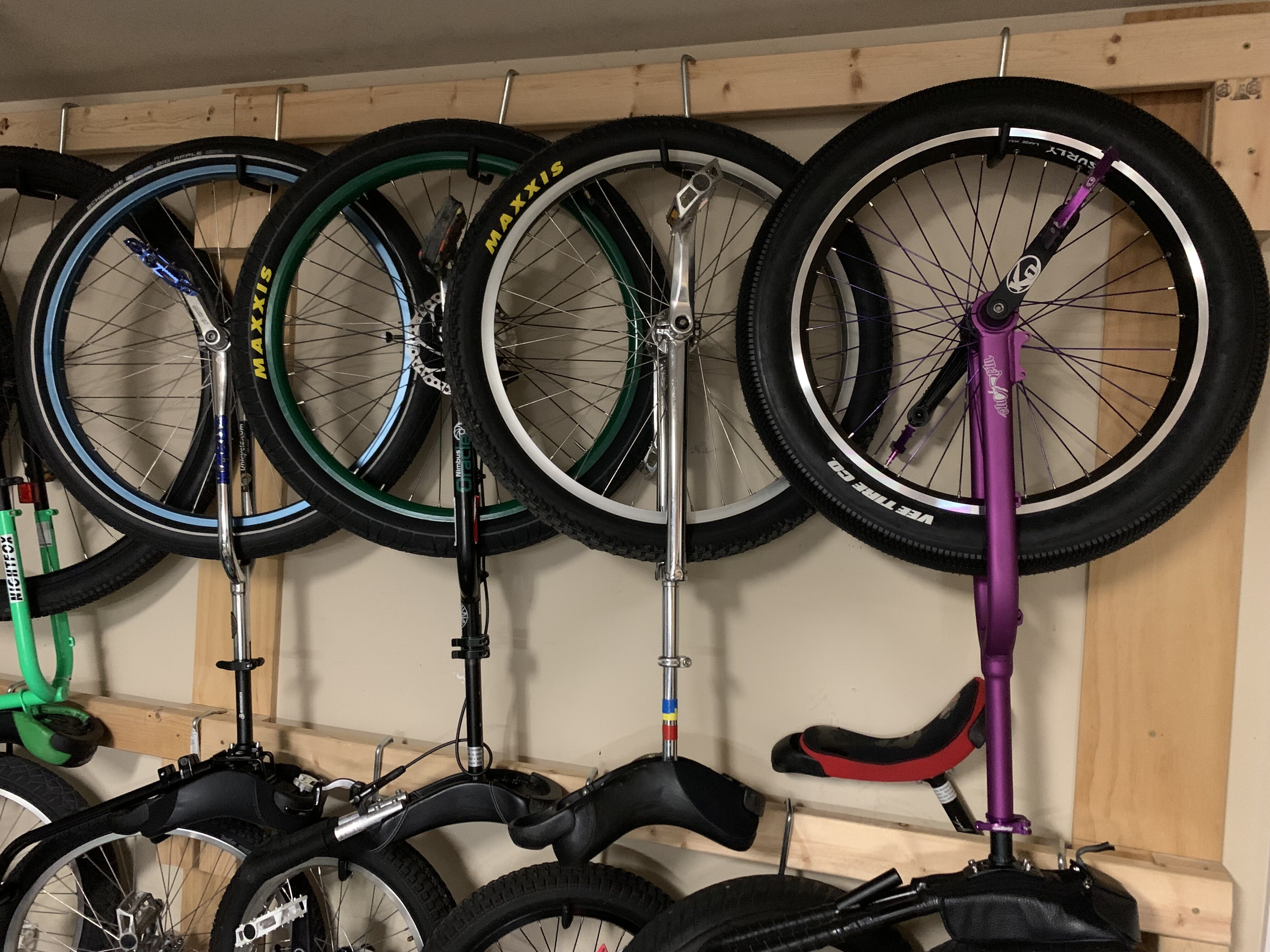

Recently, I installed a Vee Speedster 24x3.5” tire. While the tire width only increased .35”, the diameter of the tire increased quite a bit. The tire diameter is now 26.5”. The initial ride was yesterday, and the tire handles amazingly well on concrete.

This is how the tire compares to (left to right) Schwalbe Big Apple 28x2.35, Maxxis Hookworm 27.5x2.5, Maxxis Holy Roller 26x2.4, Vee Tire Speedster 24x3.5
