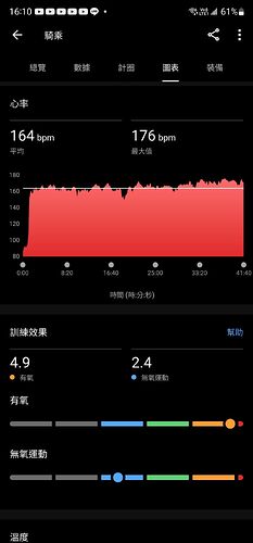

I’ve been observing a very curious effect for a while. When riding a 36er, I can easily pump up to an extremely high heart rate and have it sustained, but without a heavy panting.

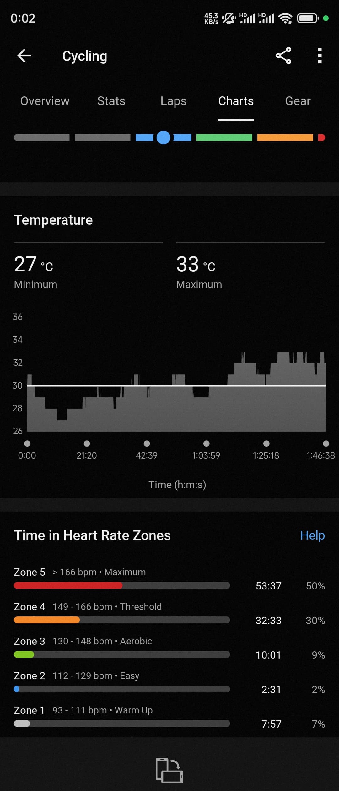

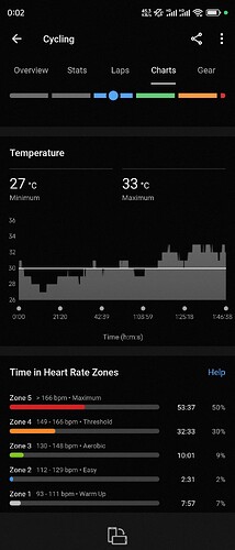

Take this recent 27km ride as an example. The average speed was 17km/h. On a mostly flat road. About half the time, my HR was in zone 5, i.e. >166bpm. If I were running or biking under such a HR, I woundn’t be lasting 5 minutes before I need to take a break. But apparently on a unicycle I don’t feel the urge to have a rest at all. I don’t pant for breath, don’t sweat crazily; I don’t even need to drink a lot. This is truly intriguing to me. Every time Garmin tells me I’ve done a great job on anaerobic training, I feel like I was cheating.

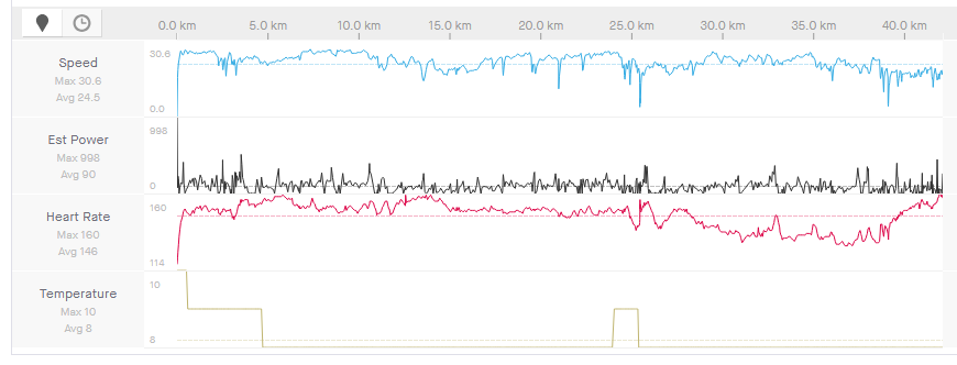

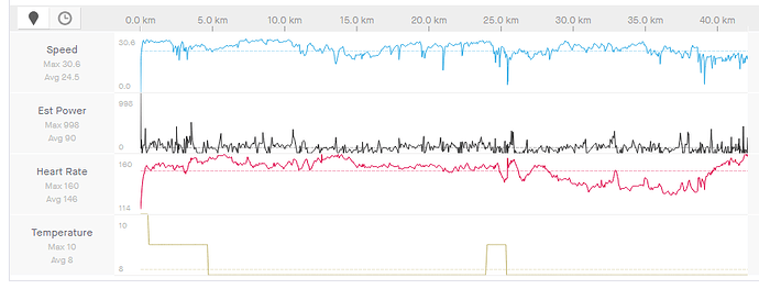

Also… conditions. Here is a ride I did a few years ago. Look at my heartrate drop at about 28km with no change in speed. Looks odd until you realise I changed direction and had a tail wind!

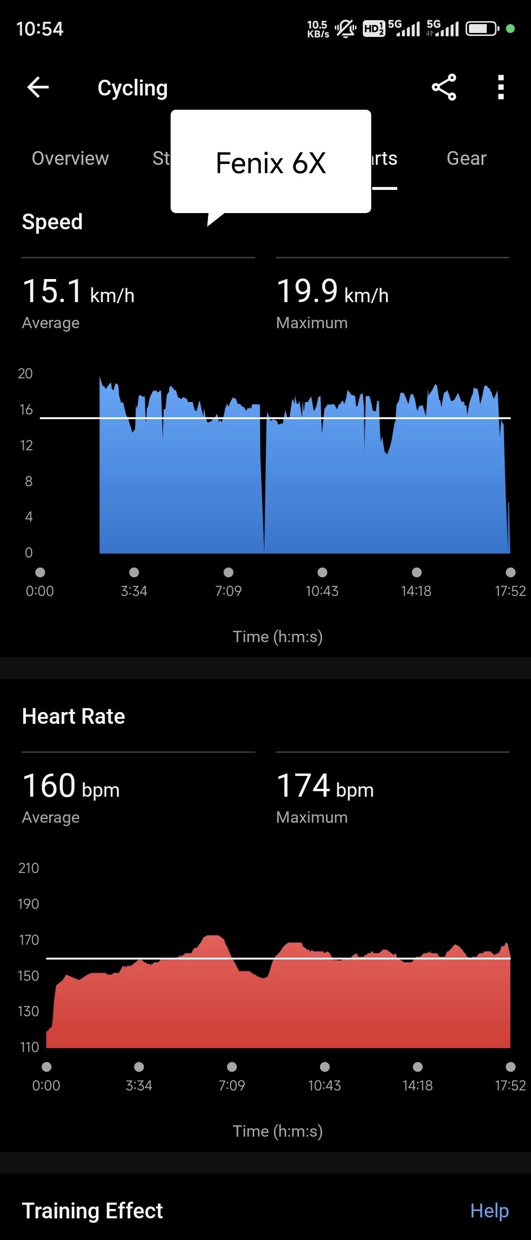

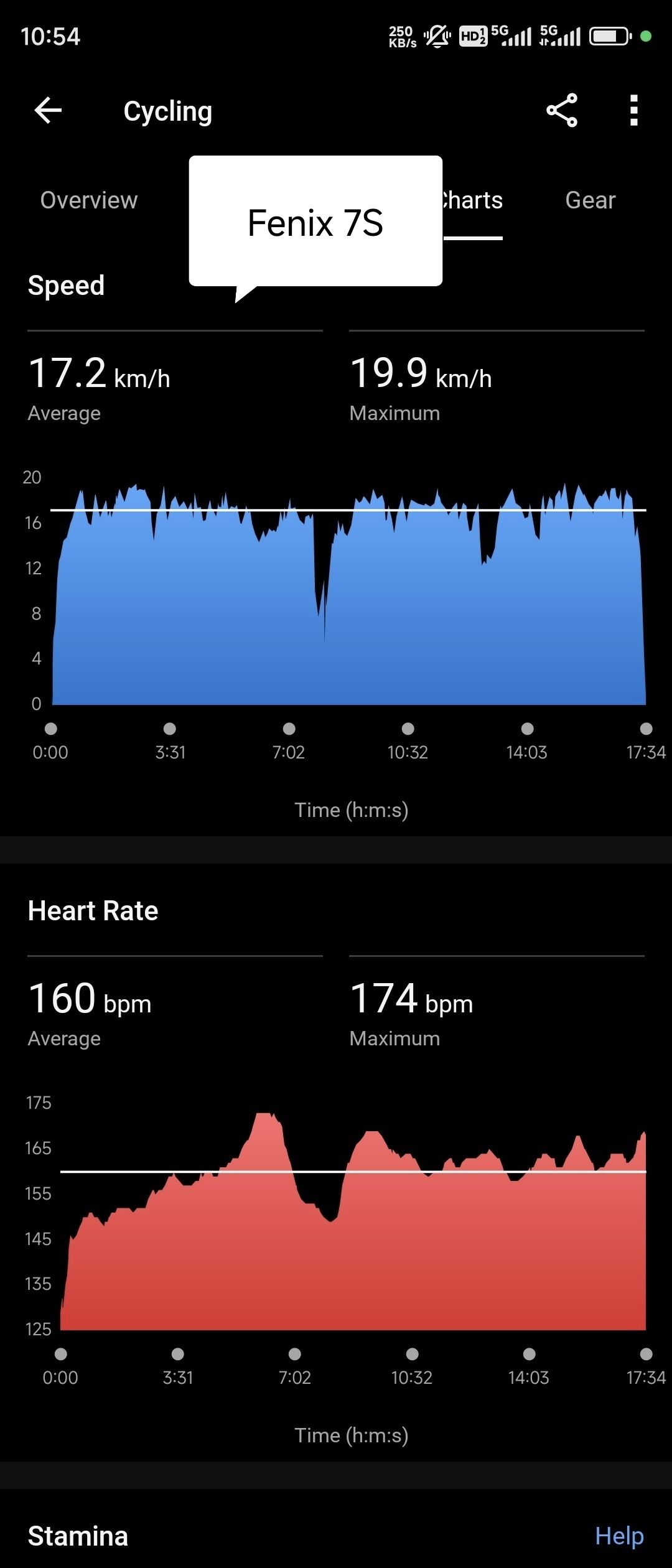

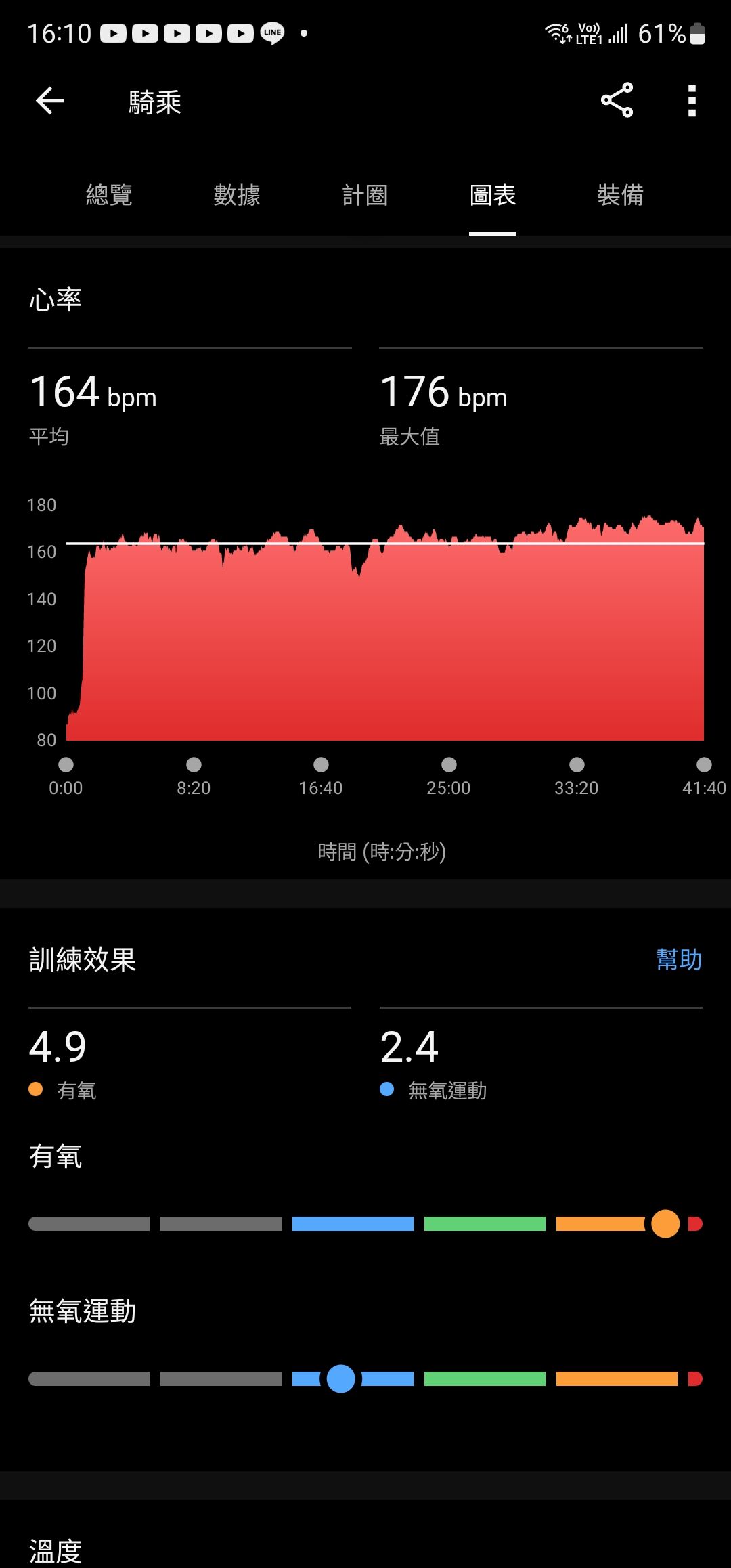

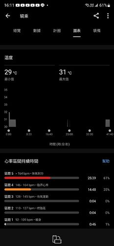

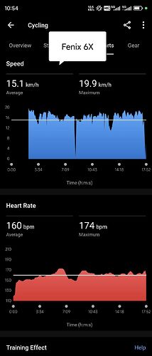

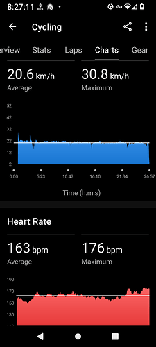

So today I took my old Garmin Fenix 6X along with the new 7S out for an experiment. I put the 7S on my left wrist and the 6X on the right one, and started a 5km test ride on my 36er. Here are the HR charts from both watches:
The 6X has missed the first few minutes, maybe a GPS issue, but their HR charts are definitely well-aligned.

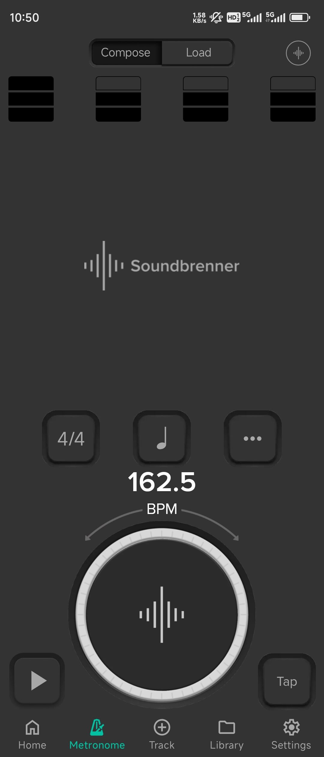

At the end of the ride, when both watch reads at 165bpm (and dropping), I took a metrenome app and measured my HR manually. Turns out the watches are accurate enough!
So that rules out the measurement errors. I DO have extremely HR as it seems. So what now? Is it a bad thing? Should i quit 36ing?

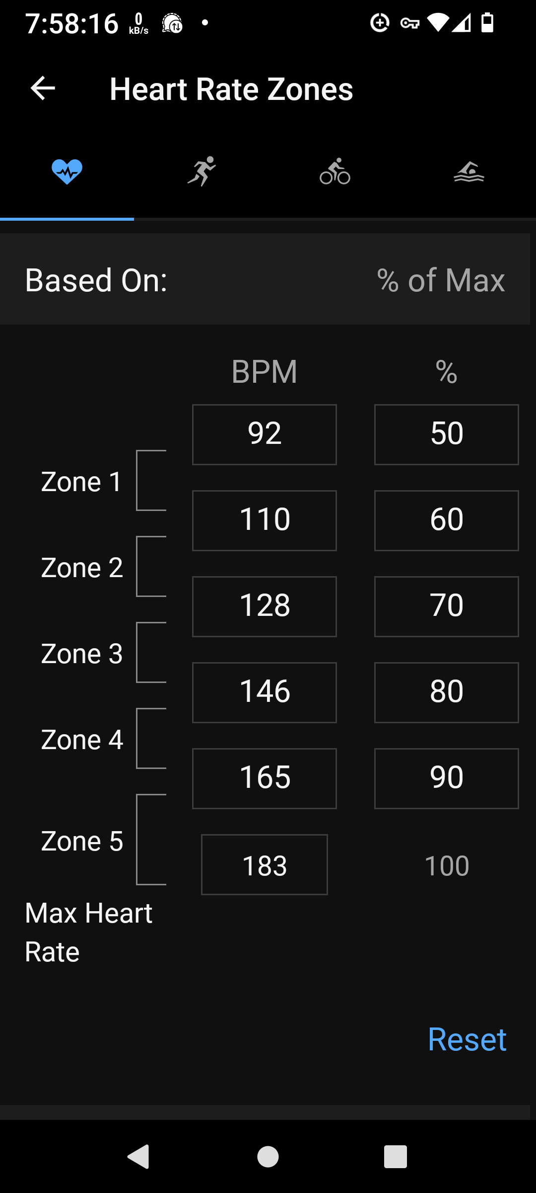

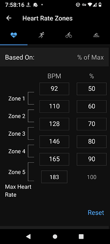

Are you sure your max HR is set correctly? Age based formulas don’t work, you need to figure it out by doing some max HR test (plenty of options out there, generally a warmup-hard effort for 10 minutes or so-sprint finish, measure HR at the end).
Heart rate drift (heart rate increasing for the same effort) is normal over prolonged exercise, it’s one of the things that makes heartrate an imperfect measure of effort. So the part of it increasing towards the end is normal, especially in hot weather the HR increases to send blood around for cooling, but that doesn’t tell us anything about our oxygen intake.
From your description of perceived effort vs. measured HR description I would suspect your max heartrate being a bit higher than you have it set.
I’m 53 years old and your charts look almost the same as mine. I would suggest adjusting your heart rate zones. For Garmin Connect: Changing Heart Rate Zones in Garmin Connect | Garmin Customer Support
My predicted max 220-age=167 is really off. I’ve adjusted my zones and my max to 183.
There’s generally nothing wrong with having a high heart rate as long as it correlates to good performance. Actually, having a high heart rate is somewhat correlated with good aerobic performance (the more range between resting and max, the better). A younger cycling friend of mine had a max of like 230 or so. I encouraged him to start training with a heart rate monitor, and he sent me his chart from a race with an average of 214 for an hour race! He later became a semi-pro racer and won the East Coast region for about 3 years.
So numbers look fine to me, you just need to update your max and your zones to match you.

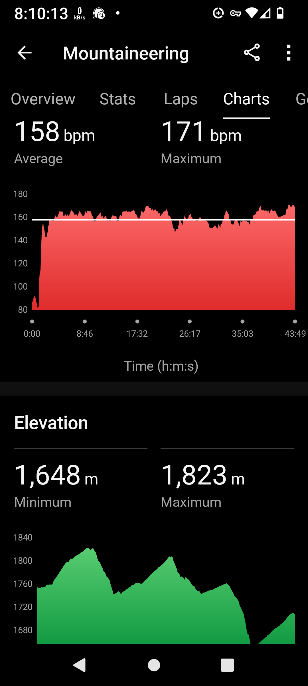

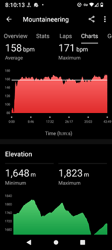

This is my HR chart from a Cross Country Muni race in Villanders Italy last year. I rode this on a 29+ with 110mm cranks and there are 3 big climbs (see elevation below in green), so my heart rate varies quite a bit. Note this is about 40 minutes effort compared to your under 20 minute effort.
Incidentally, I will be doing the race on the exact same course next weekend on June 2nd. My expectation is that my heart rate chart will look almost the same (hovering around my lactate threshold), but my hope is that I will be under 40 minutes (official 42:19 in 2023) meaning about 2-3 minutes faster, as my leg strength has improved (last year I was recovering from an ACL knee surgery and could only train about 80% max exertion).
I’m planning to pre-ride the course again this Saturday, then train the beginning of the week (at least one >1000m climbing ride) and then taper the 4 days before the race.

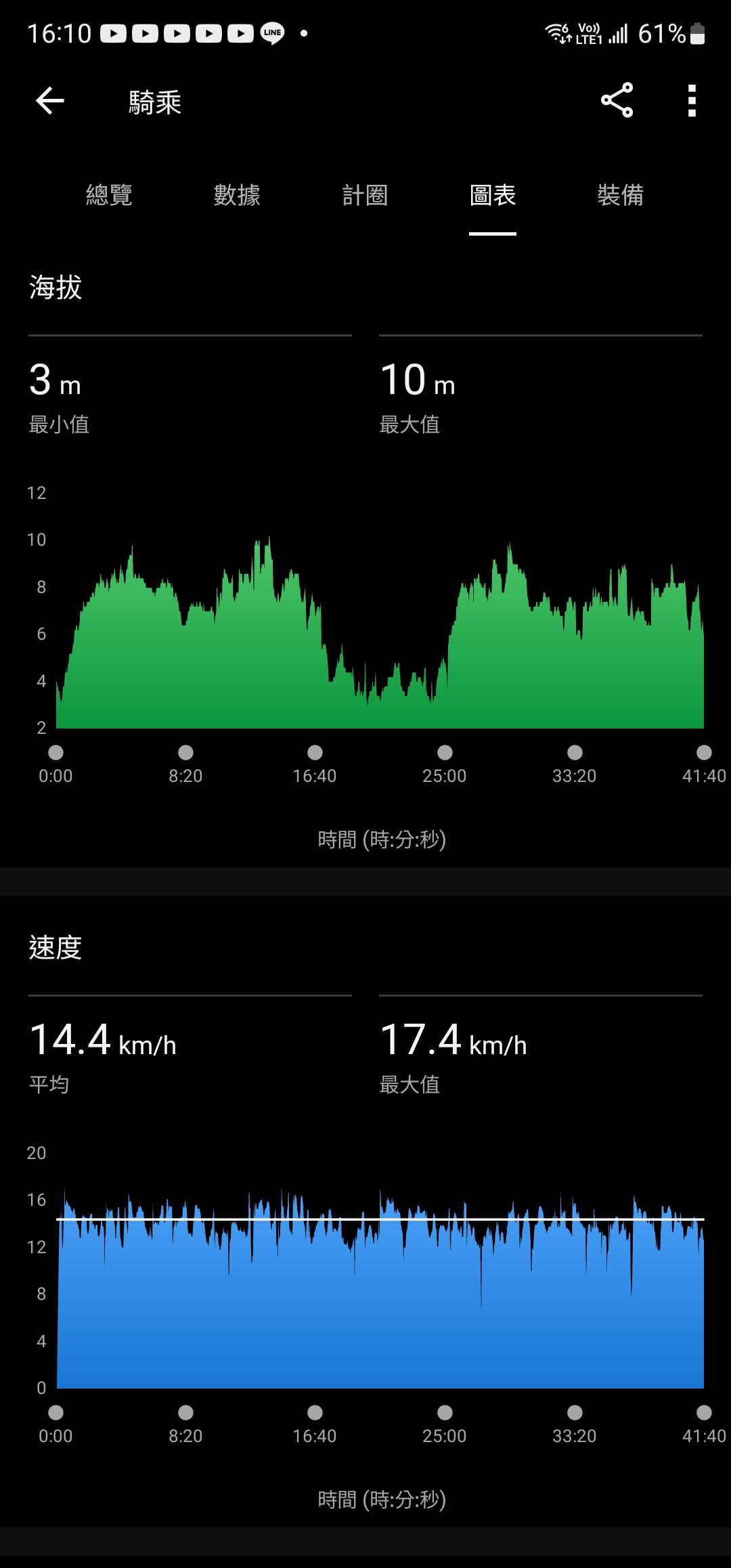

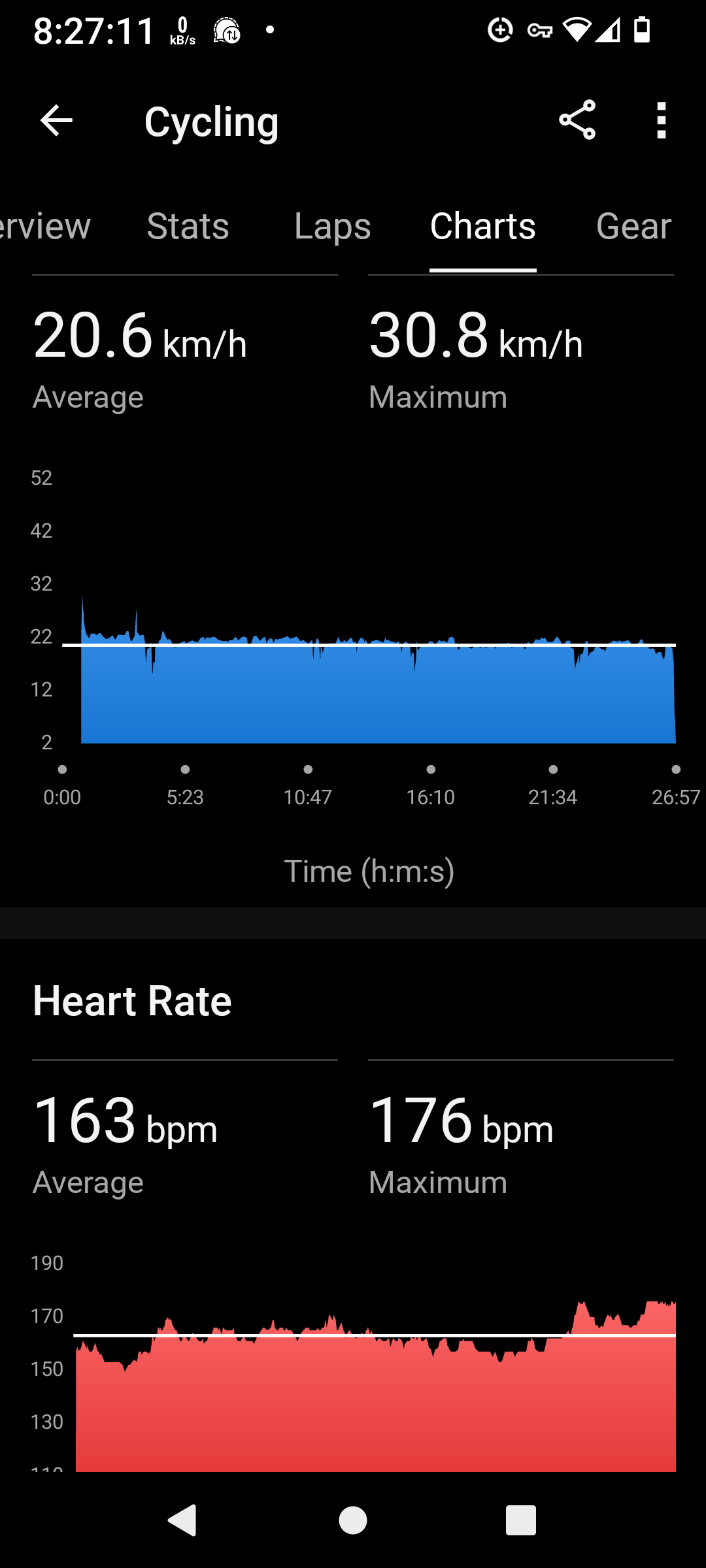

Here’s from my 10k race at the French Nationals fall of 2023 (I was slow as I was tired from the Muni races and I think trial the day before - and I’m not so good on the road anyway). This is on my 36 ungeared with 100mm cranks. (But obviously my max is higher than the predicted 167). The displayed max of 30km/h is unfortunately wrong.
I have a similar HR chart for 10K training on a 24er. But I was much slower. I’m 40 years old.
Nice. Your zones look a bit low to me too: 25 minutes in zone 5 above LT is a lot!! unless that was your all out year best max effort and you felt like you were about to die (and you felt totally exhausted for multiple days), then I would raise your max/zone ranges maybe 4-5 beats. You can estimate the LT threshold subjectively (e.g. if you can’t talk in full sentences then you are above) and get pretty close although a lab lactate test is the “correct” way to determine it. I used to do one about every other year back when I was MTB racing. I haven’t done one in about 15 years but I don’t think mine has changed much (although my max has reduced with age) - LT used to be around 166/167 at age 35 (max 191), now age 53 about 165 (max approx 183).
