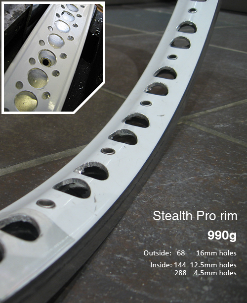

I’ve drilled the hub-side surface of my Stealth Pro rim with 16mm holes, two between each spoke (apart from at the valve and the seam). This is after previously drilling the tyre-side surface into a pretty doily pattern.
Tyre-side (hidden) holes saved 47g.
Hub-side (visible) holes saved 79g.
Final weight: 990g (saving of 126g).

Apparently the answer is no! It was going well until I tried to finish the wheel build and true it up at tension. It was a pain, and just wouldn’t go straight. It was also a little off circular, so I was trying to true that too.
It must have been enough out of round that the tyre (which I had installed nicely with a 29er tube) slowly peeked its bead over the rim. I held it at arm’s length as it went ‘BANG!’, then the tube bulged through the gap… and went BANG a second time. The tube wasn’t punctured so it stayed inflated, squashed out next to the side of the rim.
The ruption must have been enough to upset any equillibrium I had in the spoke tension, and this is the result. Luckily I wasn’t riding at the time.
So unfortunately this drilling pattern can be chalked up to experience.

I see this rim as a sacrifice to progress rather than a waste. Luckily I have another Stealth rim which I will put similar size single holes in, as I know from other people’s that that will work fine.
It may have been possible to build the wheel up without disaster by a more skilled builder… but I think this showed that it would not have taken much stress to kill it, and I wouldn’t like to ride something I wasn’t confident would stay together under me.

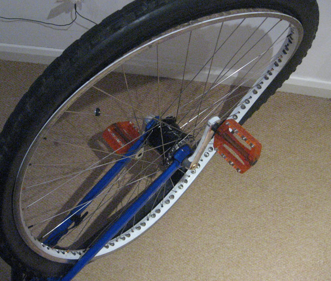

You’ll see my rim at unicon, it has 3/4" holes between each spoke hole (except for the rim join and the tube stem hole of course) - I think it’s down around 1025 grams, which really isn’t a huge gain for the effort and slight amount of extra flex, but it sure does look cool.
I think I’ve got 700kms on it or so at this point.

That still sounds like a good saving, and the lightest rim I’ve read about so far (that worked!). Did you drill the inside too, or just the visible surface?

The rim is drilled through both walls, however I haven’t removed any more metal from the inner wall as you have with your rim. I was actually expecting to lose more weight from it than I did given how much people were saving by drilling out Airfoils, but I think the walls are thinner on the nightrider to begin with. The rim did have significantly more flex after drilling, but it really has been fine through all the road riding (plus the odd curb) I’ve done with it.
