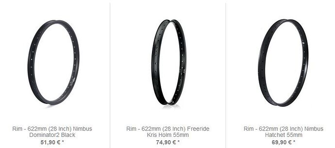

I’m choosing bits for my new mad4one 29" unicycle and I’m trying to decide whether to get the drilled or the un-drilled rim.
Drilled mad4one 29" rim:
Pros: Accelerates faster which helps when taking off from a stop, lighter (838 g), looks cool
Cons: Weaker, costs more (+5€), dirt can get inside holes, harder to clean
Un-drilled mad4one 29" rim:
Pros: Stronger, chheaper, better at keeping rotational momentum which is good when rolling over bumps, no holes for dirt to get into, very easy to wipe clean
Cons: Heavier (929 g), accelerates more slowly (is it noticeable though?), unexciting looks
Need to hear your opinions to help me decide. My gut tells me to go with the un-drilled because I have a uni with a drilled rim and it was a PITA to clean after riding through a muddy patch, but I have no idea how the extra weight will impact steering and overall feel. Cost really isn’t an issue because the difference is minuscule, but I included it in the comparison for completeness’ sake…Thanks in advance!

Hmm, municycle.com have just emailed me back and they have both the Nimbus 29" Hatchet rim and the KH 29" Freeride rim rims in stock!
I’ve never used such a wide rim (55 mm). How does a wide rim affect handling? What’s the narrowest tyre I’ll be able to run?

Also, the Nimbus rim is cheaper. The Mad4One rims are the heaviest and and don’t have eyelets, and yet they are more expensive. The Mad4One site says eyelets are only needed when using alu nipples to prevent (seizing I guess?), and mentions a number of disadvantages. In my opinion they didn’t add the steel eyelets because their rims were already too heavy to begin with, and also because it adds to cost.
