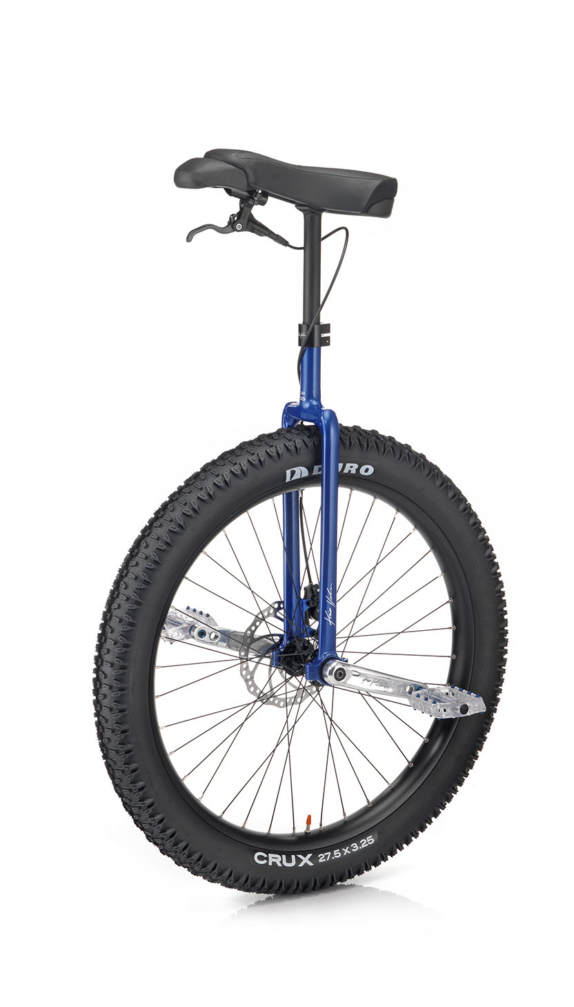

You can have your KH Uni in any color you want, as long as it is blue…
Unicycling is already a niche market, offering products for even more niche markets within that market doesn’t make a lot of sense. The people that are really specific about what they want aren’t really significant for manufacturers and dealers (I love UDC and most the manufacturers, not trying to talk crap, but I think that is the reality we live in).
If 90% of people who buy upwards of a Nimbus oracle want a disk brake, there is really no market for a model without one.
The steel frame versions of Quax and Nimbus tend not to come with a brake and they are much cheaper. If you don’t want a brake you can always go for one of those, they are top-notch unicycles. Nothing wrong with a steel frame: is only a bit heavier than an aluminum frame and also I’m guessing the steel is stronger than alumunium. I’ve got a Quax 26 muni steel frame, is bomb proof, it is an excellent Unicycle and I ride the same trials I do with my KH 26 (which I bought later on because I wanted to fit the Knard tyre). In most models of the top range Unicycles you are paying mainly for the upgrade to an Aluminum frame (with the disc brake ready mount), sometimes a lighter hub/more confy saddle. The thing is once you add up the extra cost of this upgrades the cost of adding the disc brake to the Unicycle is minimum. The cost of an average/low cost disc brake is minimal (but they have huge braking/modulation perfomance) . Therefore, to me, it makes sense that they fit the disc brake in the top range as default. You can always take it off and put it back on later on if you feel like you need it. ![]()
