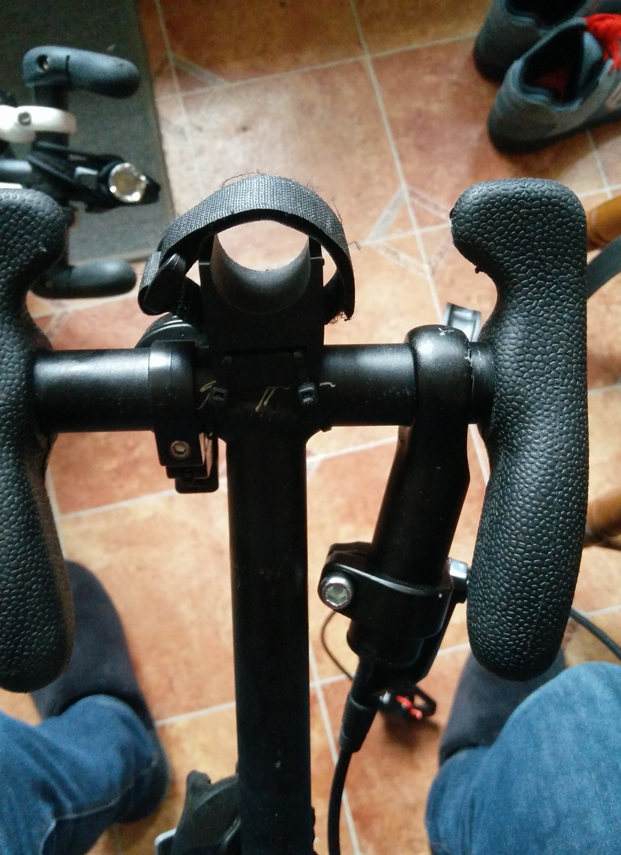

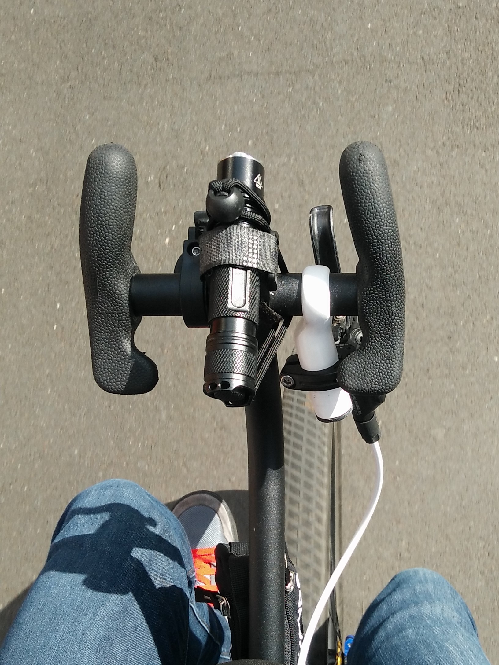

I’m using the udc t-bar that came with my nightfox, but I’ve cut it down pretty radically.

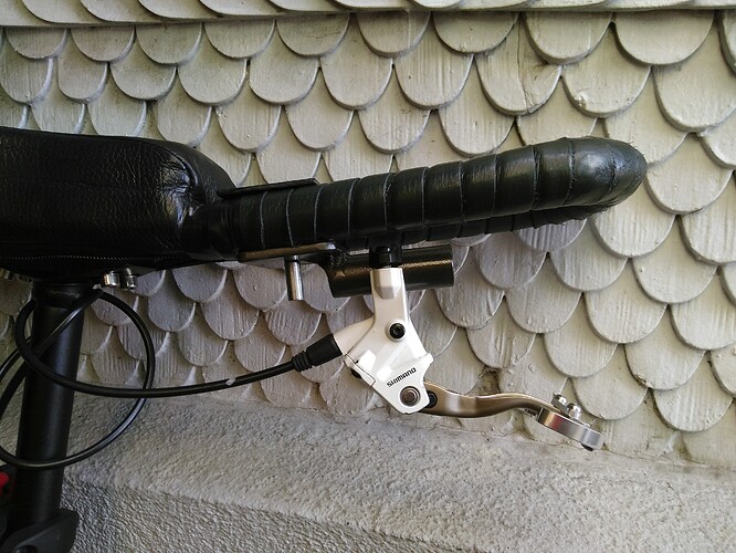

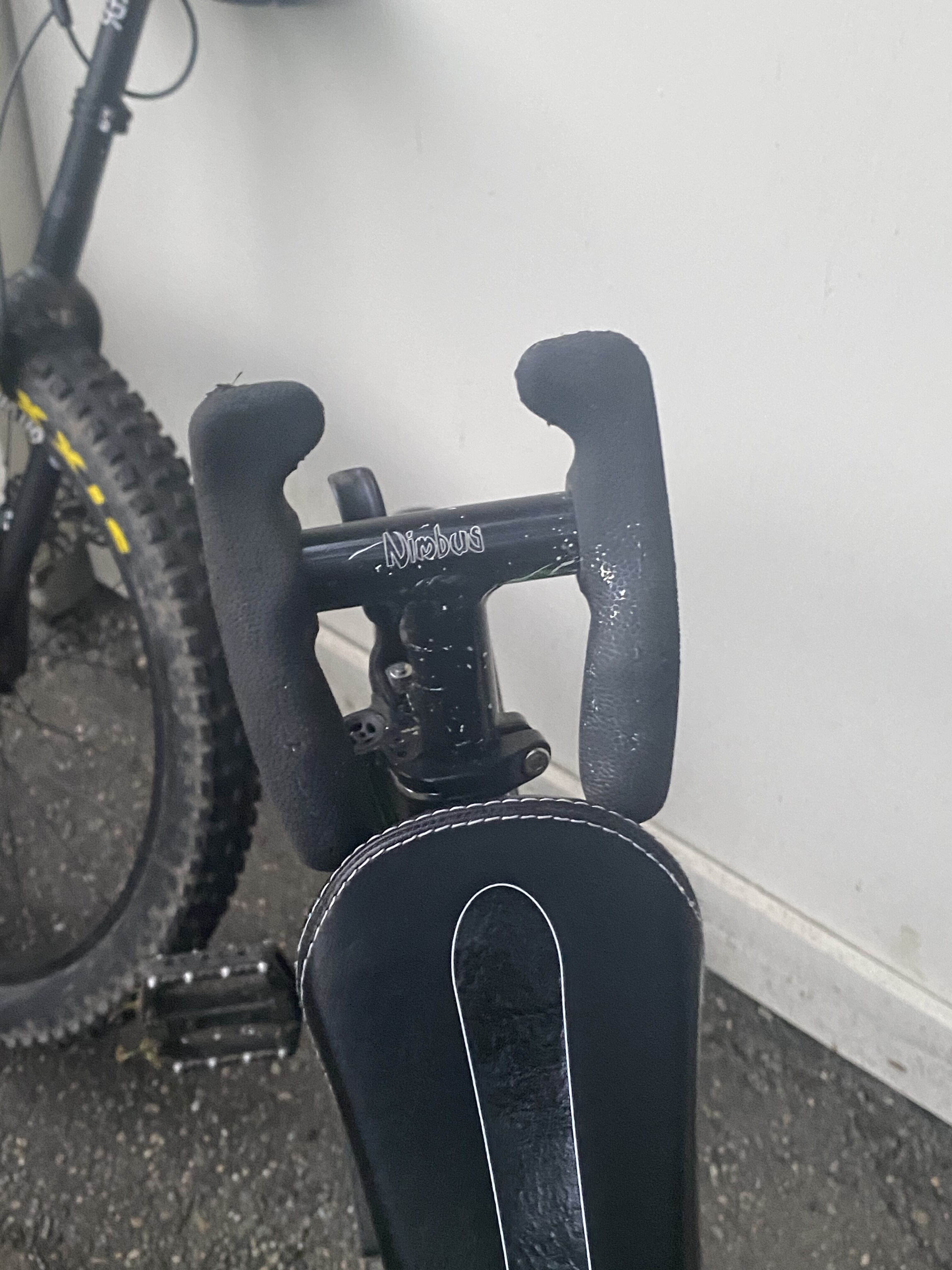

On my quax. I just use the saddle handle.
You can see it’s rotated only a little to the left as I didn’t want the angle to make it difficult to operate.
Have you considered adding a starfighter? You could the slide the lever back a bit (more protected) and easily brake with either hand.

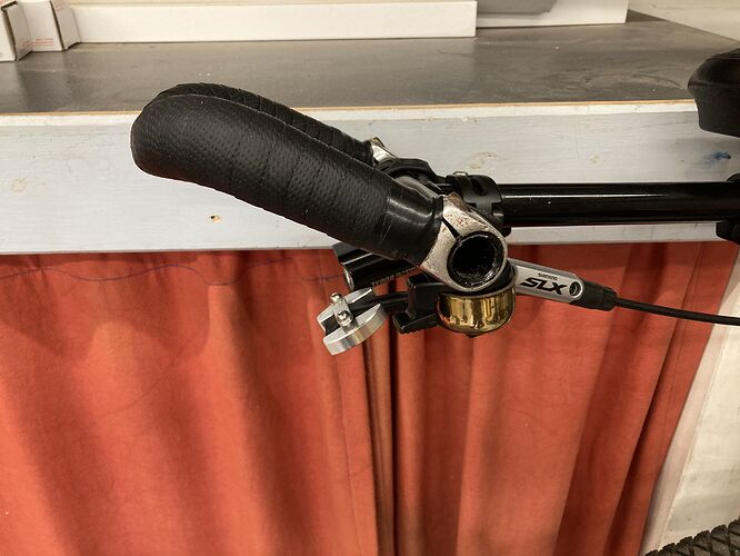

I use an unmodified bent KH T-bar, but with a shortened upside down handlebar riser to mount my brake to.
This allows you to get the lever closer to the grip, as well as adjust the angle of it independently.
It also works when you use the grips the other way around

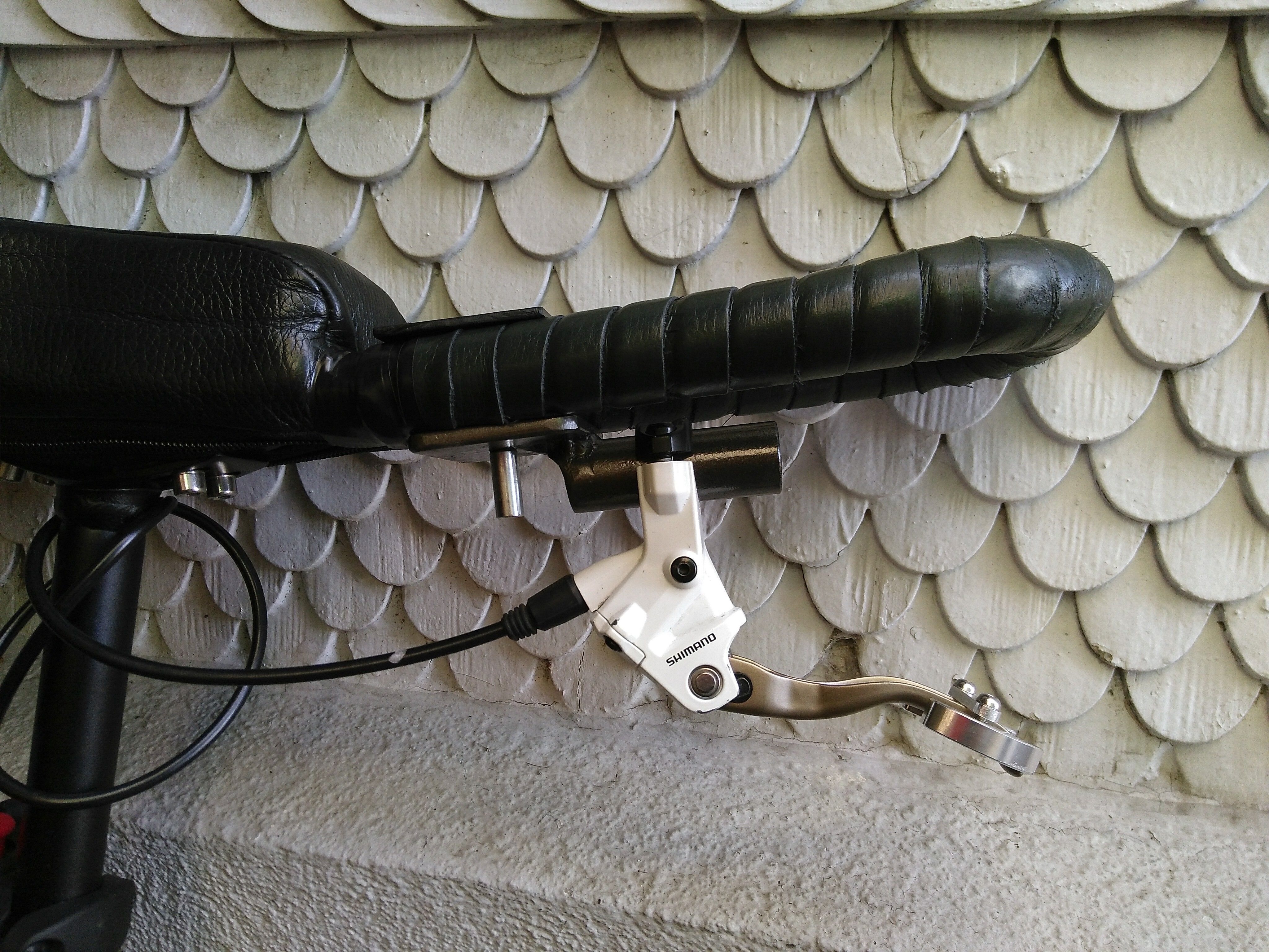

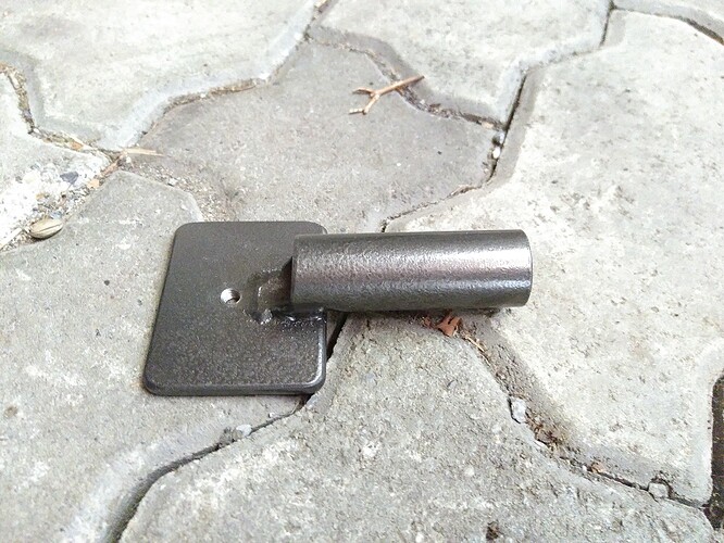

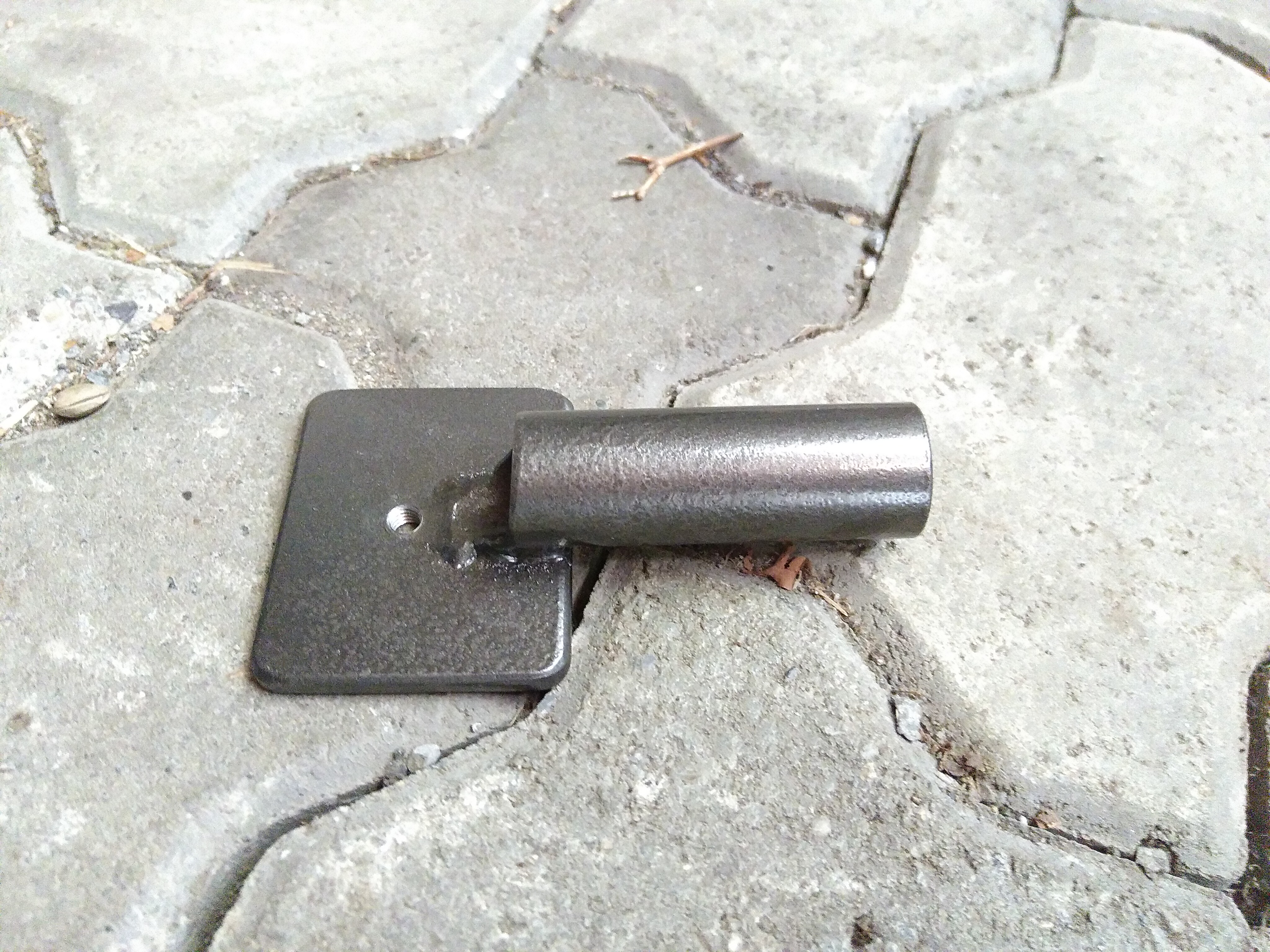

Because I like to brake with both hands I needed a brake adapter with the handlesaddle. The one I ordered with it was IMHO poorly built and didn’t fit my needs, so I had to build my own…
(I think I already posted those pictures in another thread…)

Awesome, I did the same thing for my HandleSaddle :wink:
