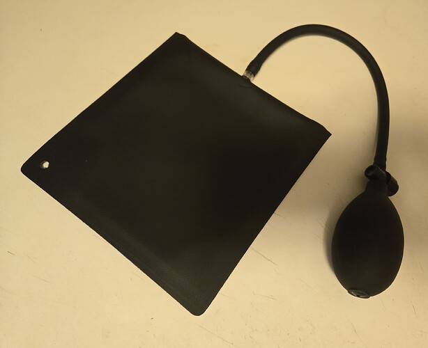

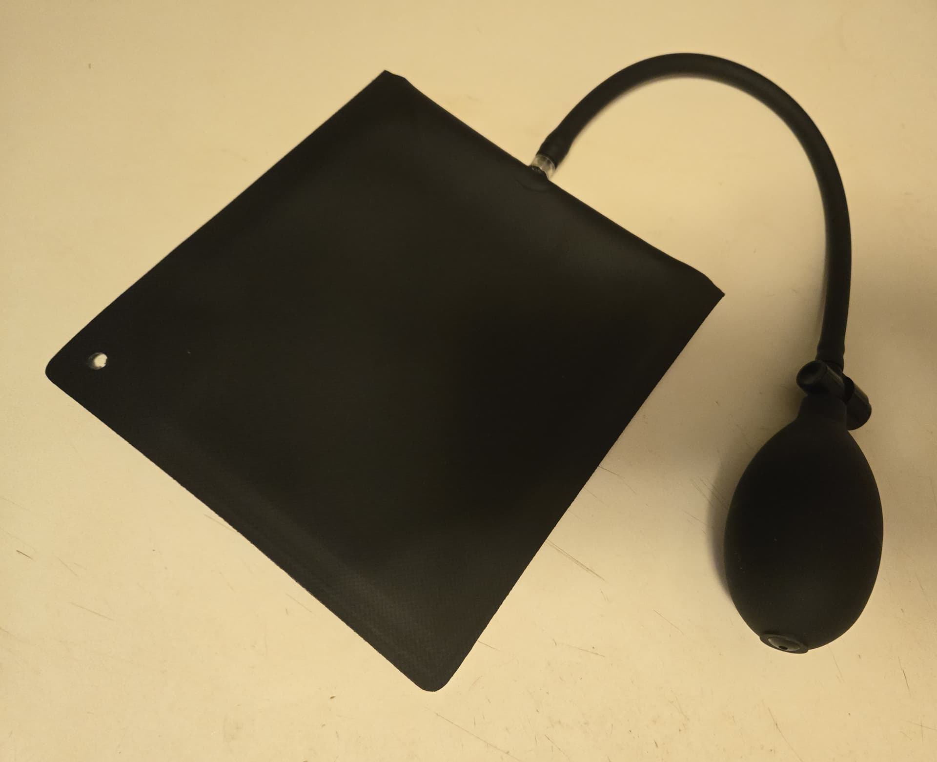

To assemble the air saddle I purchased this inflatable lifting cushion from Amazon:
https://www.amazon.com/QWORK-Inflatable-Lifting-Cushion-Installation/dp/B0CPX6NBWK/
It comes in a pack of four, which worked out nicely for me, since I will soon have a total of four unicycles. At $3.00 each, they are extremely affordable!

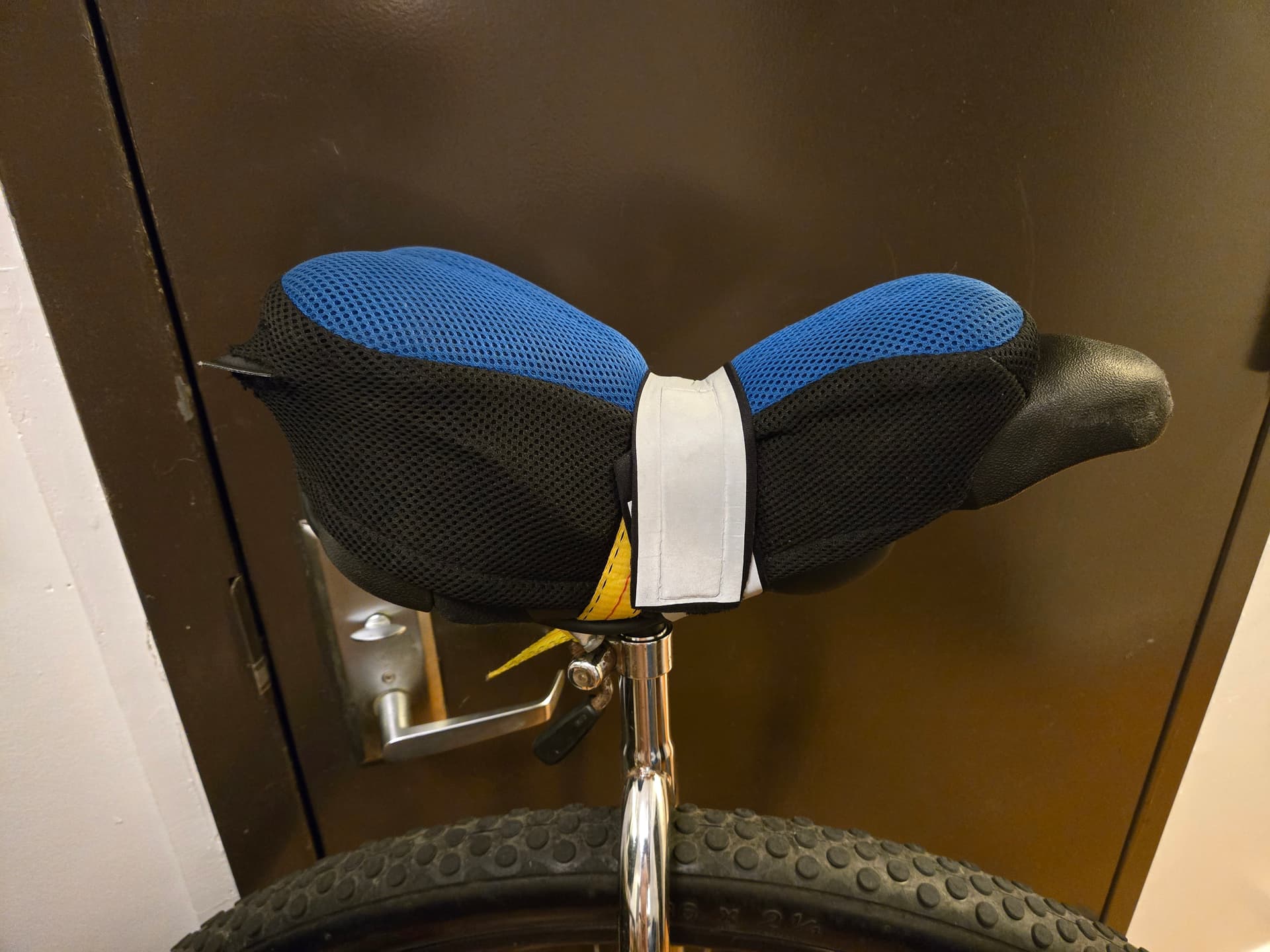

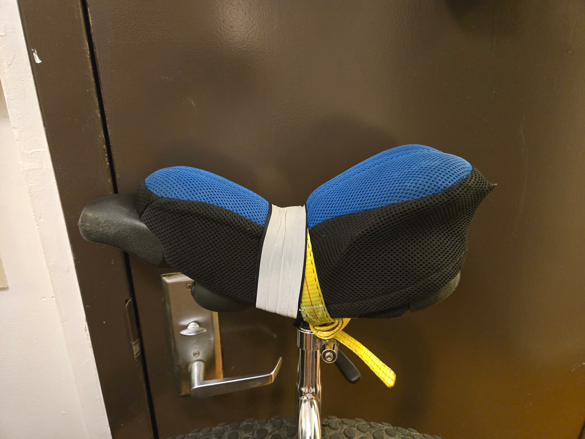

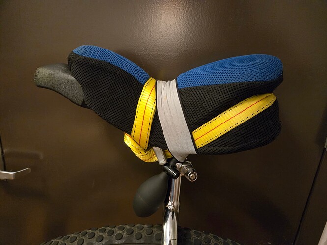

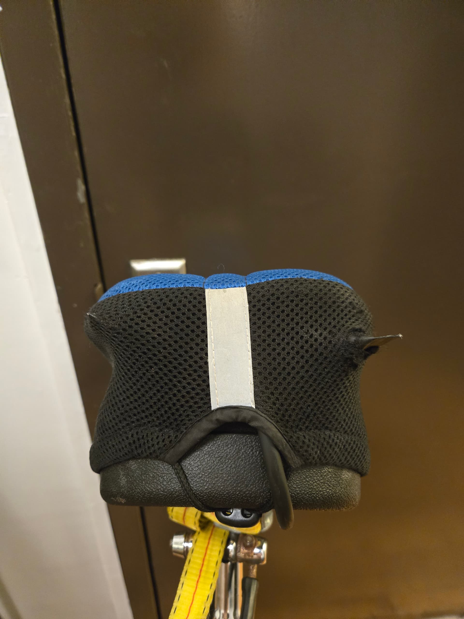

I inserted the cushion between my saddle and my saddle cover and then used an adjustable strap to keep the left and right sections of the air cushion that went beyond the top of the saddle folded against the sides of the saddle. After the assembly and returning from my test ride, I noticed that the sharp back corners of the cushion were poking a hole in my saddle cover. As you can see in the photo, the front corners of the air cushion are rounded, but the rear corners (the side where the pump hose is attached) are not rounded. To fix this issue I cut the two sharp corners off. Since I felt like the stiffness of the inflated air cushion would probably still be likely to eventually tear my saddle cover, I decided to strap it down, which seems to have solved the problem. My new DIY air saddle exceeded my expectations! It is by far the most comfortable unicycle saddle I have ever had and I really like that I am able to use the hand pump to adjust the level of inflation to the amount of air/cushioning I like most. If you are looking for a more comfortable unicycle saddle than what is currently available, I highly recommend assembling your own air saddle using an inflatable air cushion. If you do, please post to this thread to let us know if you used the same air cushion as I have or if you chose to use a different one and to also tell us about your experience assembling your new DIY air saddle and what you think of it. Thanks!
UPDATE: Don’t cut the corners off! Apparently doing so damaged the air cushion, so it no longer stays inflated. When I tested it prior to cutting off the corners, it worked great. Once I cut the corners off (just minimally), it caused a leak. I will re-assemble it with one of the other three cushions that I didn’t modify.
Also, the rear strap I used to hold the rear corners down isn’t really working, unfortunately. It keeps sliding down. Oh well, I guess two small holes in my saddle cover isn’t too bad a trade off for having an air saddle that is very comfortable.
