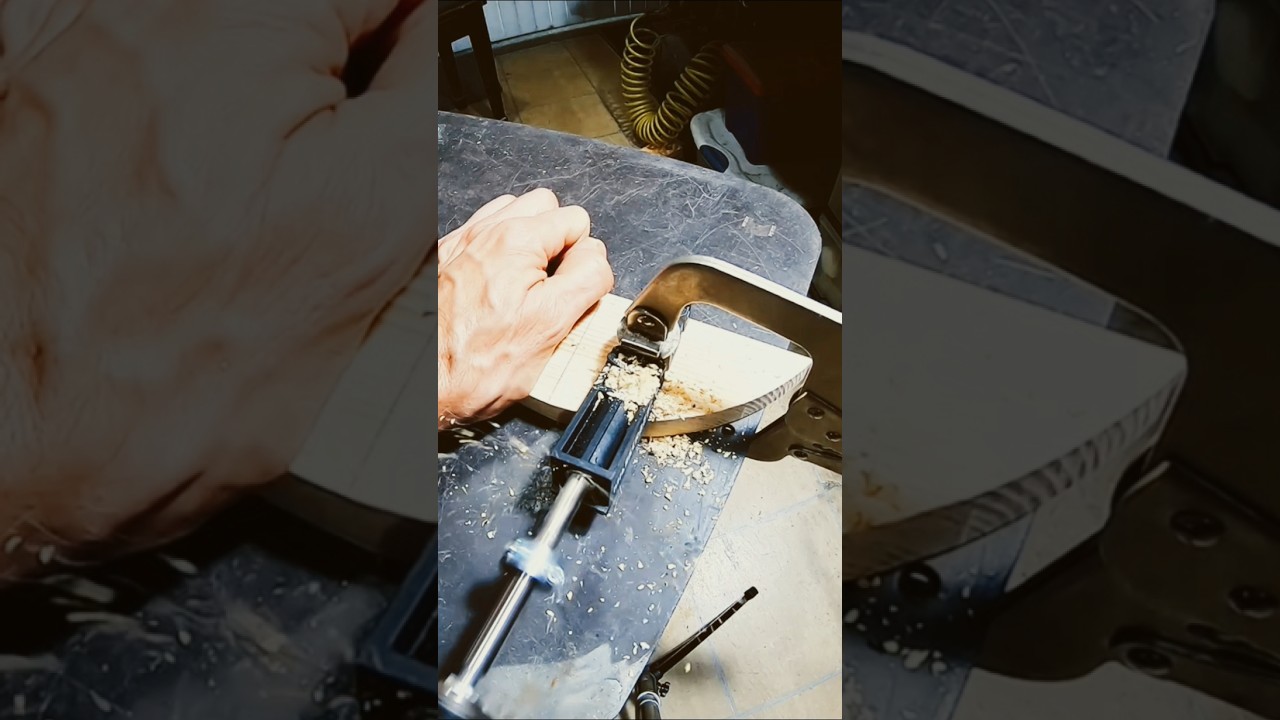

Here’s a rebuild of my 36er UW, and a short video showing me making my latest 26er UW with a carbon rim…and spokes! (Just cosmetic)
In the first clip of my 36er UW upgrade, you see me holding my left arm out in front of me in an awkward position, and that’s because I had my smartphone in an armband sleeve and I was talking into it to try to do narration while my hover drone was following me.
This video shows the making of my latest carbon rim 26er UW. A multi-day project condensed into just about 2 minutes.
Although the pedal mount is the most important part, I like your jigsaw jig most. The spokes look great.
Here is a pic showing most of the tools and supplies I use for making my UWs. It’s fun making these, and having made several improvements to the builds, they are now light and strong, and have a very stable, smooth feel. Also, having totally rebuilt and modified the Lunicycle pedal/leg supports, riding is dead easy with zero wheel rubbing that you would normally have to deal with using just standard pedals. Speaking of the Lunicycle, I still had the two 20" ovalized wheels that came with each Lunicycle, and I realized that I could use the crank holes that were welded into each wheel. But after cutting the sections out, I found that by splitting each down the middle, I’d have two right and two left or a total of 4 sets from both wheels!
