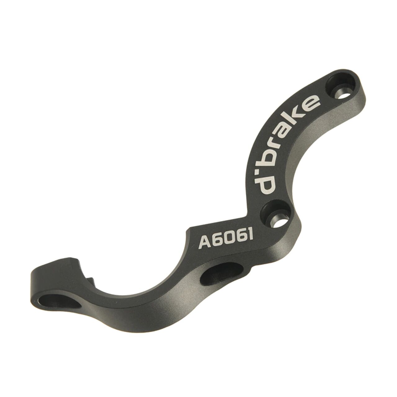

I’ve got no experience with rim brakes, but I did order one of these yesterday.
It’s a disk brake adaptor, so there are ways to retrofit older unicycles to disk brakes. Some of the Kris Holm cranks have holes for attaching brake disks to, so even if the hub is not configured for it you still can probably switch to disks if you really want to in the future.
Cool, where did you get that? is it used particularly for converting rim break to a disc break set up?
That’s available at unicycle.com under the brakes and mounts section. I’m not sure how well it will work on a KH unicycle however as it was designed for inboard brakes. It might be that you can simply reverse it and use it for outboard brakes as well. I’m sure there’s a way to retrofit it though.

If it’s 4 years old then it should be compatible with a disk brake already and all you’d need to do would be add the disk to the crank and the caliper to the mount.
KH unicycles have been created with disk brake compatibility since 2012.
The d’brake adapter has its down sides for use with an outboard disc (mounted on the crank rather than the hub) certain brake calipers, particularly mechanical ones, are thicker on one side. I tried a shimano mechanical caliper on my nimbus oracle 36 and the caliper hit the spokes.

If upgrading a non-disk ready (pre 2012) KH 36 you would do well with a d’Brake and Spirit cranks. With the proper 6mm spacer, the Spirit cranks put the disk 1.5 mm further away from the bearing centre than a hub mounted disk so you would likely need to add washers between the d’Brake and the caliper mount to push it out a bit. At this point it might work brilliantly, or you might have some chattering and resonance issues. This is fixed by adding a brace between the top bolt on the d’Brake and the frame. Search “Hugo Strut”.
