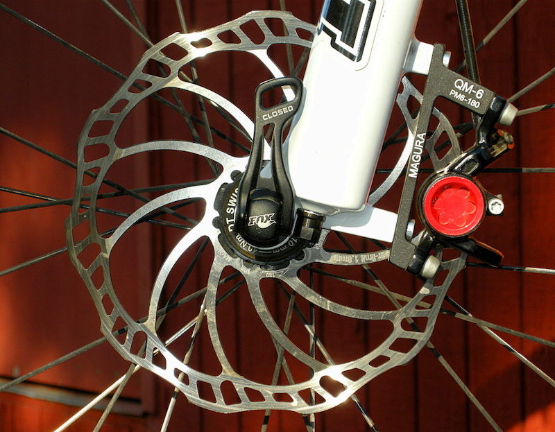

As with TopHat, I had similar problems with my mountain bke.
After buying it second-hand, everything was fine after a few weeks, but after that whenever I applied the brakes there’d be squeaking.
This escalated to actual vibration which could be felt through the forks at the front, and the frame at the back.
It got so bad that I took it to my LBS and it turned out that the problem was the shape of the rotor.
It was one o’ them fancy ones, and the guy at the shop told me that basically the uneven outer form of the rotor was causing oscillation every time I applied the brakes.
I switched to round rotors and the problem was sorted immediately, no more noise, no more vibration.
I did a quick google search on your rotor and it looks like on o’ them fancy ones too.
Not saying this might be the same problem, but it can’t hurt to switch to a round rotor (maybe borrow one off a b
ke buddy for an afternoon) to see what happens.

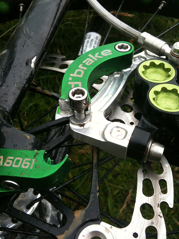

over the summer i was trying out my new disk brake muni, and going down some very steep slopes, and i usually get a very high pitch whine from my disk which i don’t mind, but it started to hum, louder and louder, to the point where the whole unicycle was shaking, then, while coming to a stop on a down hill section, the D’brake snapped! the humming must have been it starting to snap, i don’t know weather this is the cause for your noise but watch out for stress fractures around the bottom bolt for the calliper :slight_smile:
I don’t think that smiley face means what you think it means.
Try this: :astonished:
I’ll certainly be watching mine for that issue, thanks for the heads up.

Bummer, that must have been pretty exciting at the time :astonished:
I guess anything can break, but that’s the first one I heard of breaking. I have three D Brake rigs and they are doing fine, one is well over a year (Oregon) and has been ridden hard.
I will say that I prefer a welded on frame tab, but unless I have a similar breakage problem, I’ll just stick with the D Brake.
