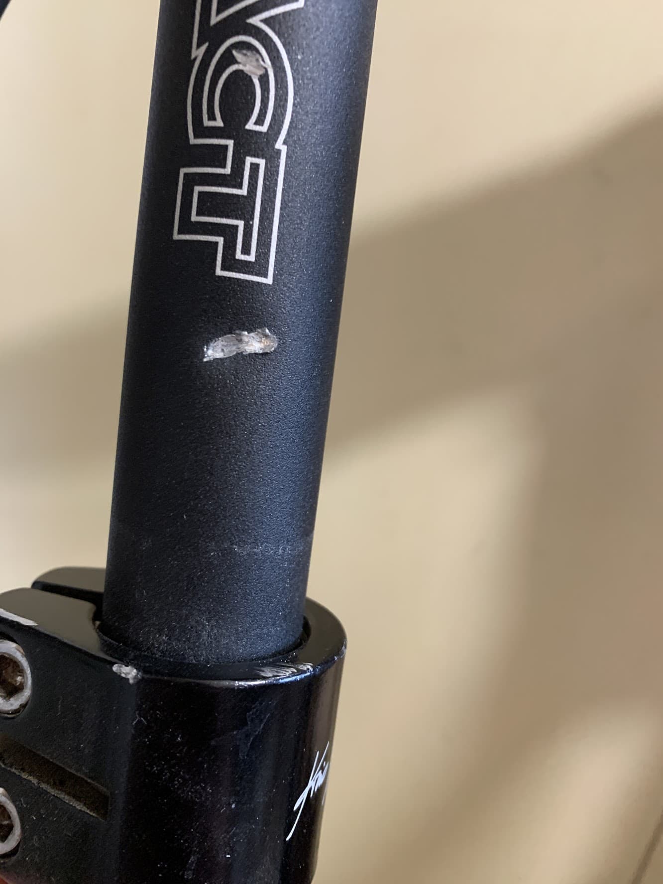

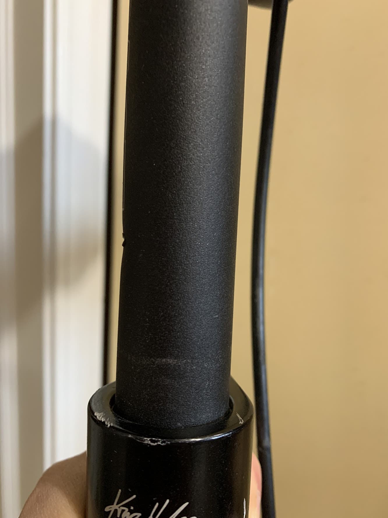

I have an Impact ALLinONE seatpost (27.2mm OD) with ~2mm aluminum wall thickness
It’s got a dent a bit less than 1mm deep, 8mm wide, on the right side.
I don’t think I ride super hard, and haven’ broken parts yet…
Is this going to break? Has anyone broken seatposts in the middle?

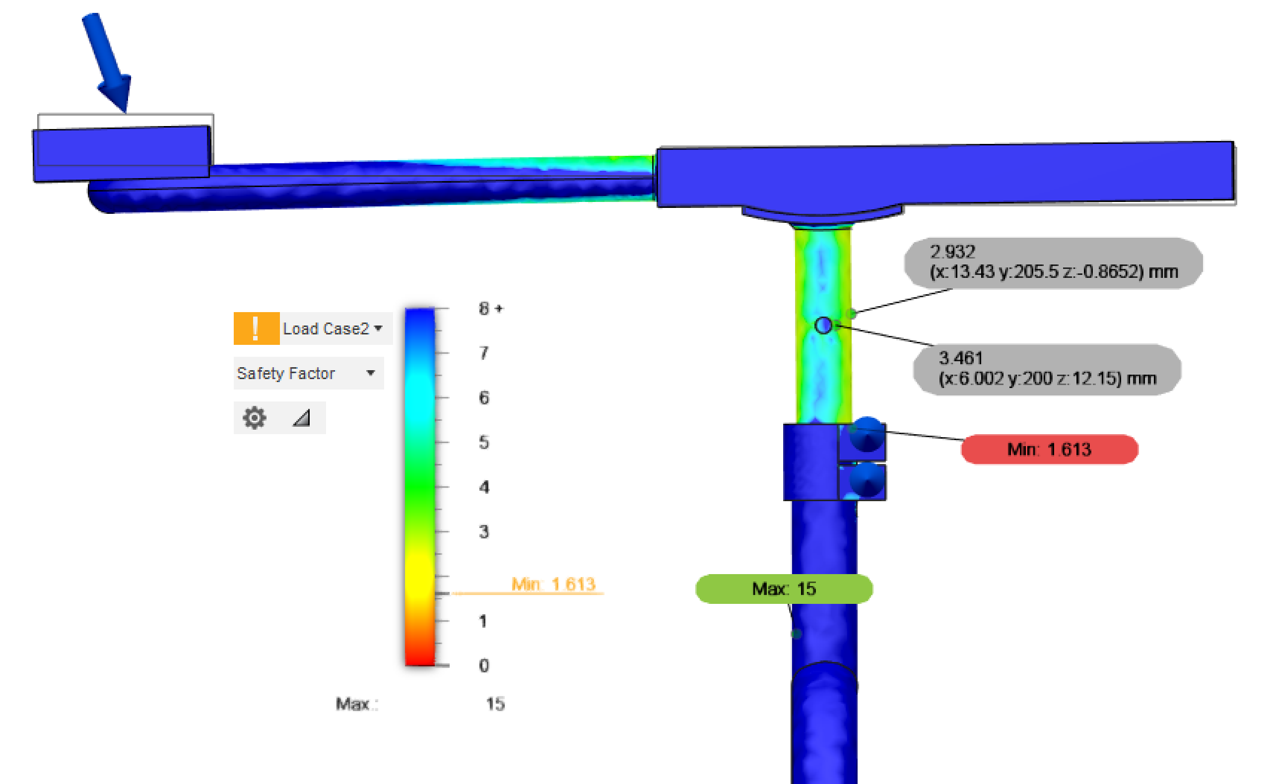

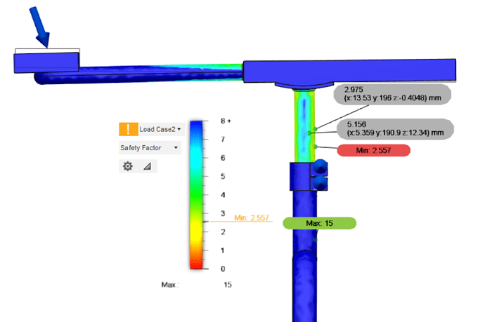

I tried simulating a similar setup with and without a 8mm hole on the side, with a 100lb load from the tip of the handlebar (20 degrees front back and 20 degrees left right). I see very little difference?
With hole: (There is high stress on the FRAME near the clamp.. happens on some of my simulations, but not sure if it’s “real” or not.)
Without hole:
Just from my experience with breaking seatposts, that’s not the place where they typically fail, and I personally wouldn’t worry about it. Fairly low stress area (as your simulations confirm), fairly minor dent, I don’t see any reason why it should fail significantly faster than a normal one.
Maybe keep an eye on it and check for cracks occasionally (which is a good habit anyway). I’ve pretty much never been surprised by a suddenly broken seatpost, they usually get a bit creaky or feeling soft with visible cracks before ultimate failure.
