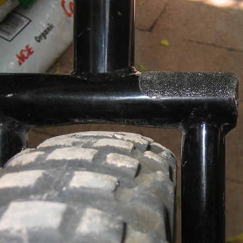

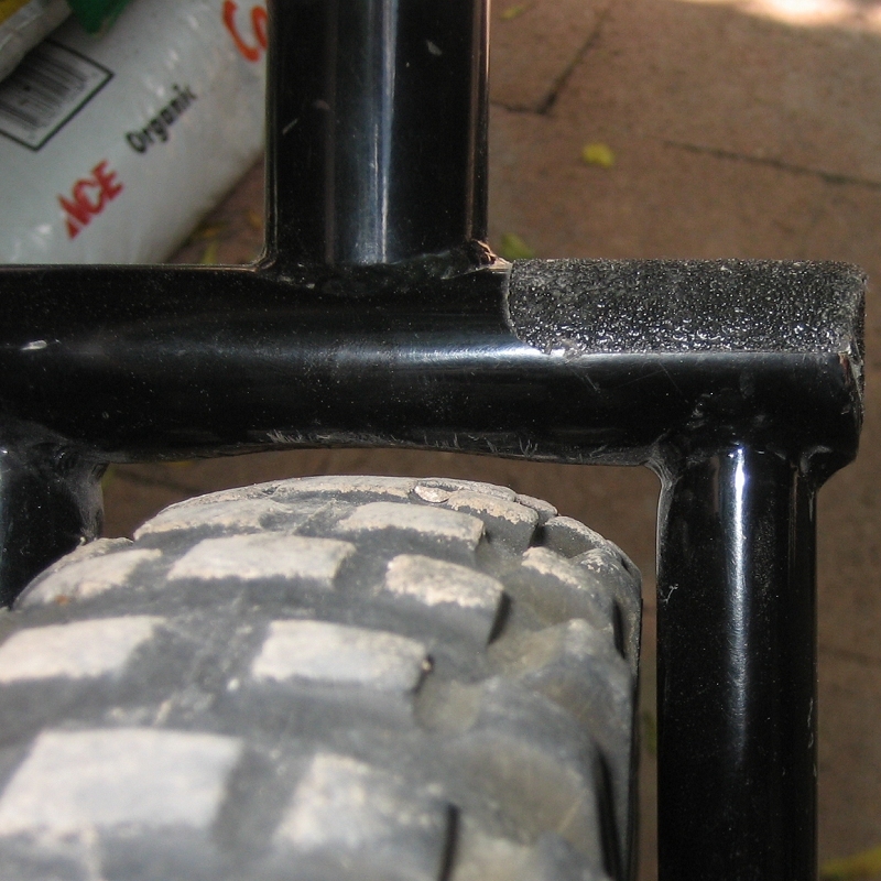

I wasn’t kidding; an LX frame will fit a trials tire under the right conditions (and with a hammer). Here’s a picture of my unicycle from several months ago… The tire is on an Alex dx32 rim and is fairly worn, and the frame had the legs bent outwards (to fit the hub) and a dent put in the bottom of the crown.
I got it to fit over wheelset the only thing is that I made it to wide.:frowning:
Any suggestions on how to make it smaller?
Stick the ends of your legs in a vice. Take it slow, moving the legs in and out will weaken them (ie tighten 1.5 cranks, loosen 2.5 cranks, check, tighten 3.0 cranks, etc.).
