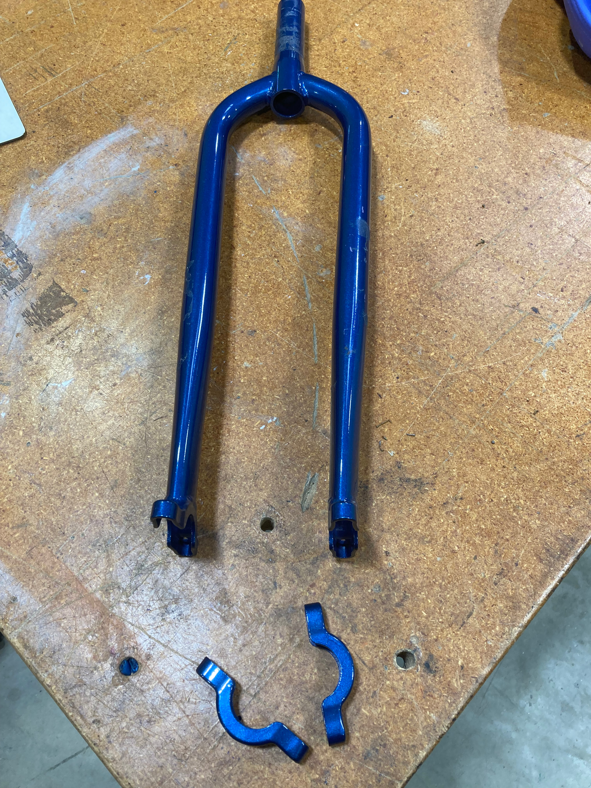

So for the next 5 days I will have the chance to weld stuff. I’ve been thinking of what to weld, when I realized that I have two URC steel frames. One of them is currently on a unicycle, but the other one of the bottom brackets is warped and I am unable to fix it. (Also, one is URC M and the other URC L). So I thought, why not cut the bearing housing off one at an angle, shave down the paint, and weld them together for a steel V frame? Any thoughts on which one (L/M) should keep the bearing housings, tips, cautions, or ideas? Thanks. Also, it will be MIG welding, and I have experience

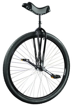

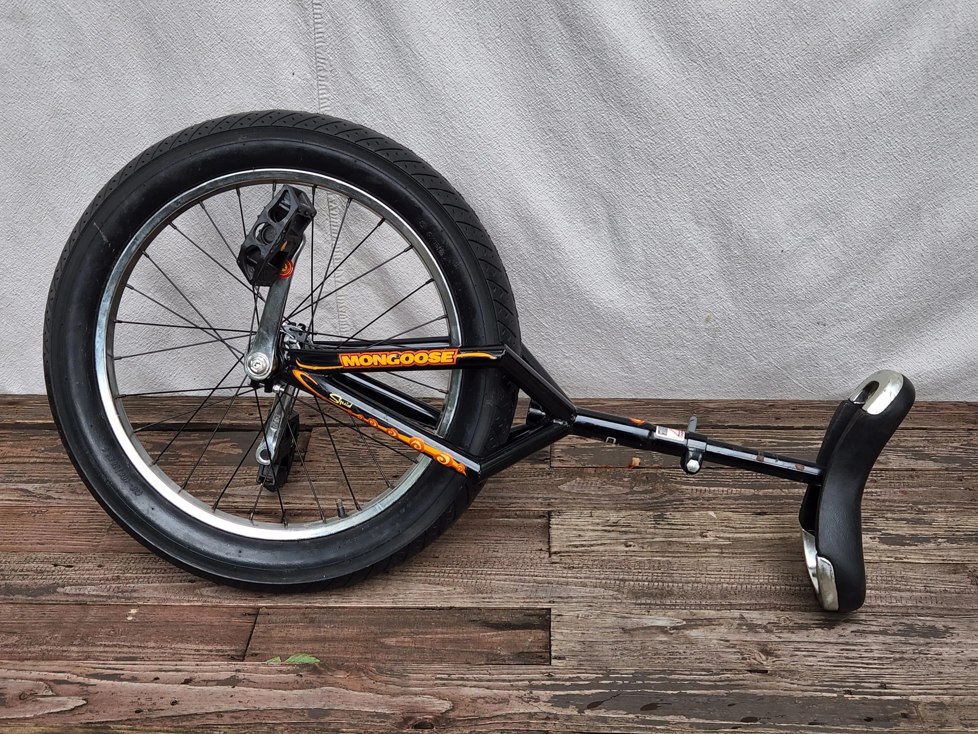

What kind of V-frame? Similar to the Nimbus Oregon or rather a custom speed machine?
Like
vs.
Either way, I guess if you make one frame out of two ordinary ones you’ll end up with a heavy lump of a unicycle, at least if they’re made of steel. Not sure it’s worth it. Then again, the process of trying and creating something new on your own certainly is.
More like the second one

How has no one posted these boat anchors (oops I mean squid frames)… Sorry i stole the images, my V2 frame is a bit awkward to reach…

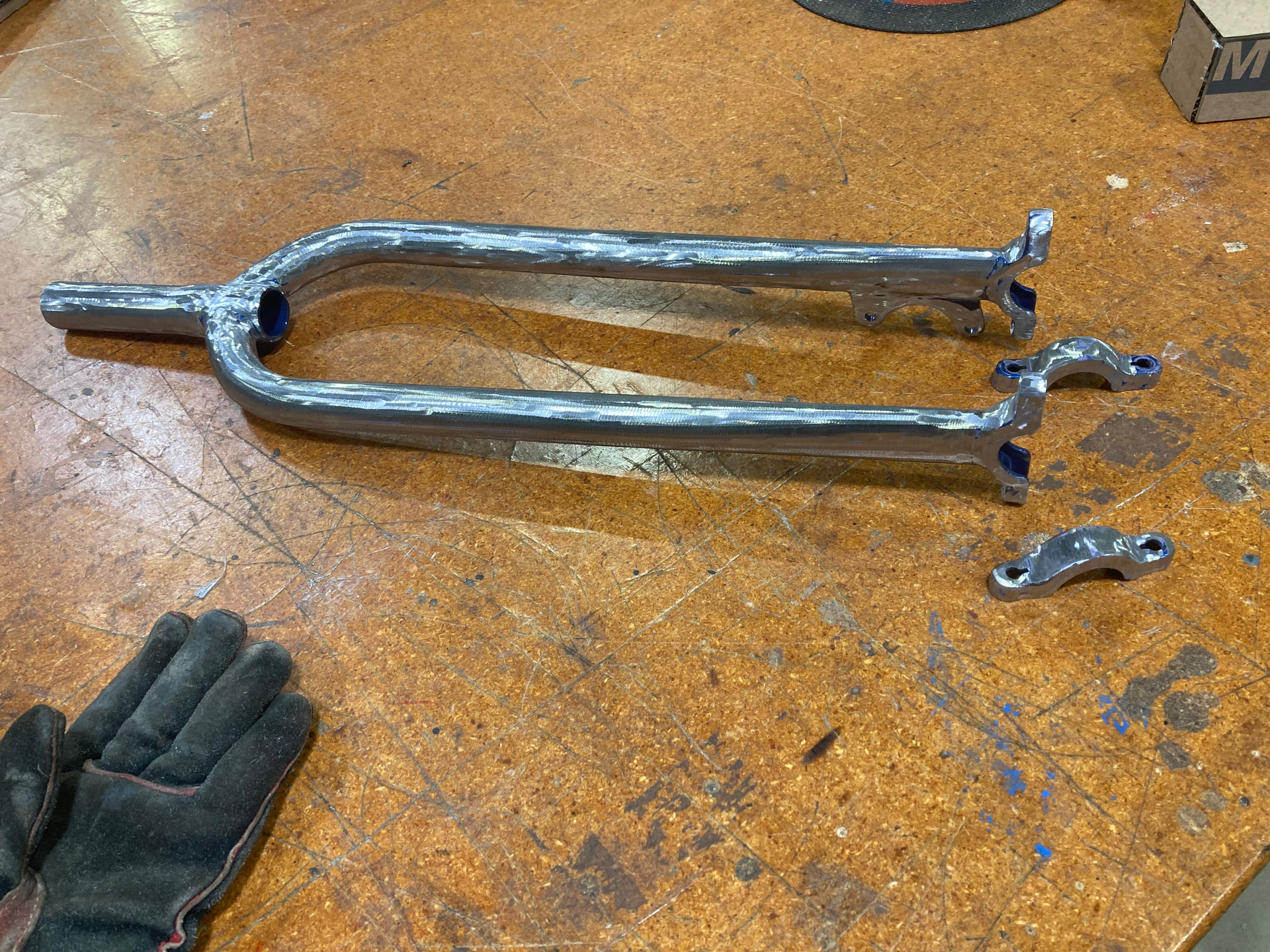

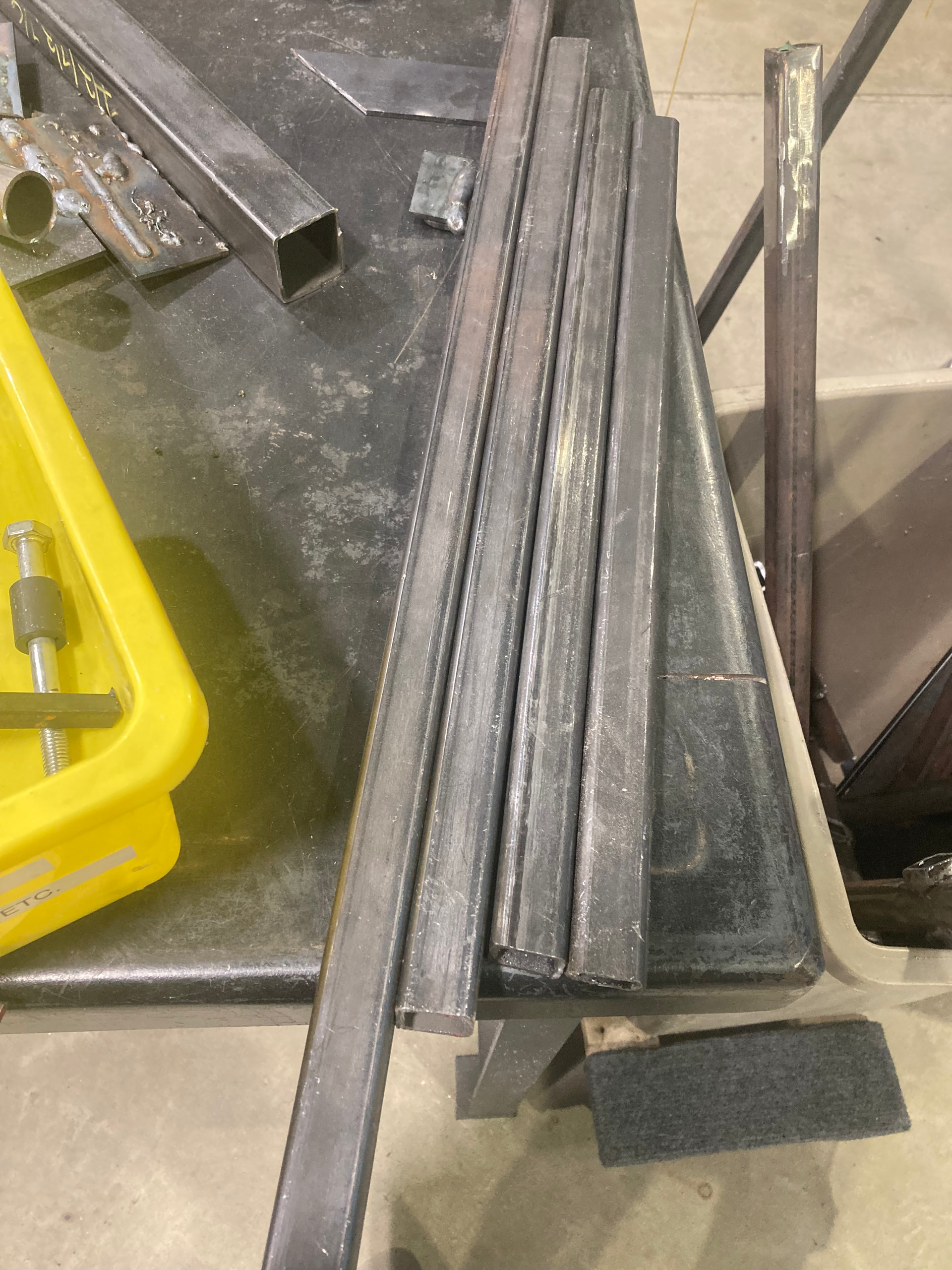

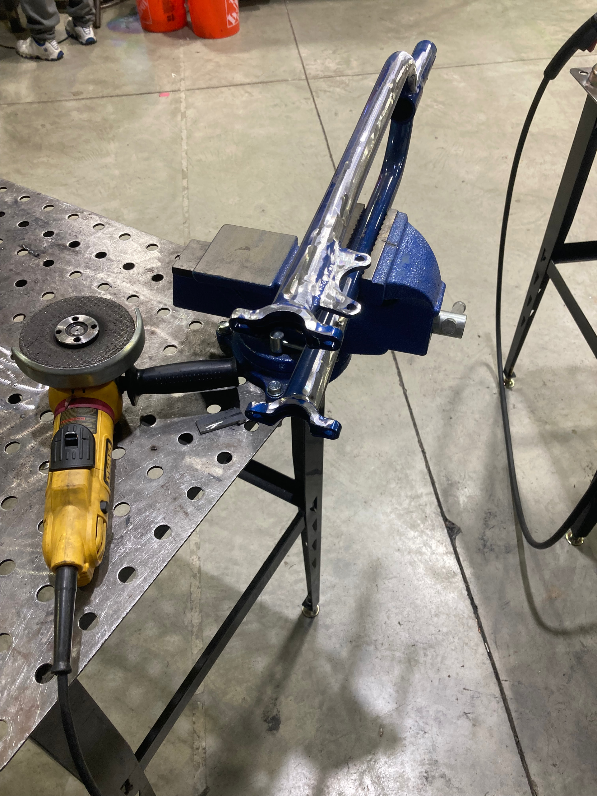

I changed my plans, no longer cutting one frame and welding it on another, I am instead using square steel bars to attach. I just finished grinding down the paint on the frame.

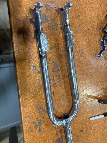

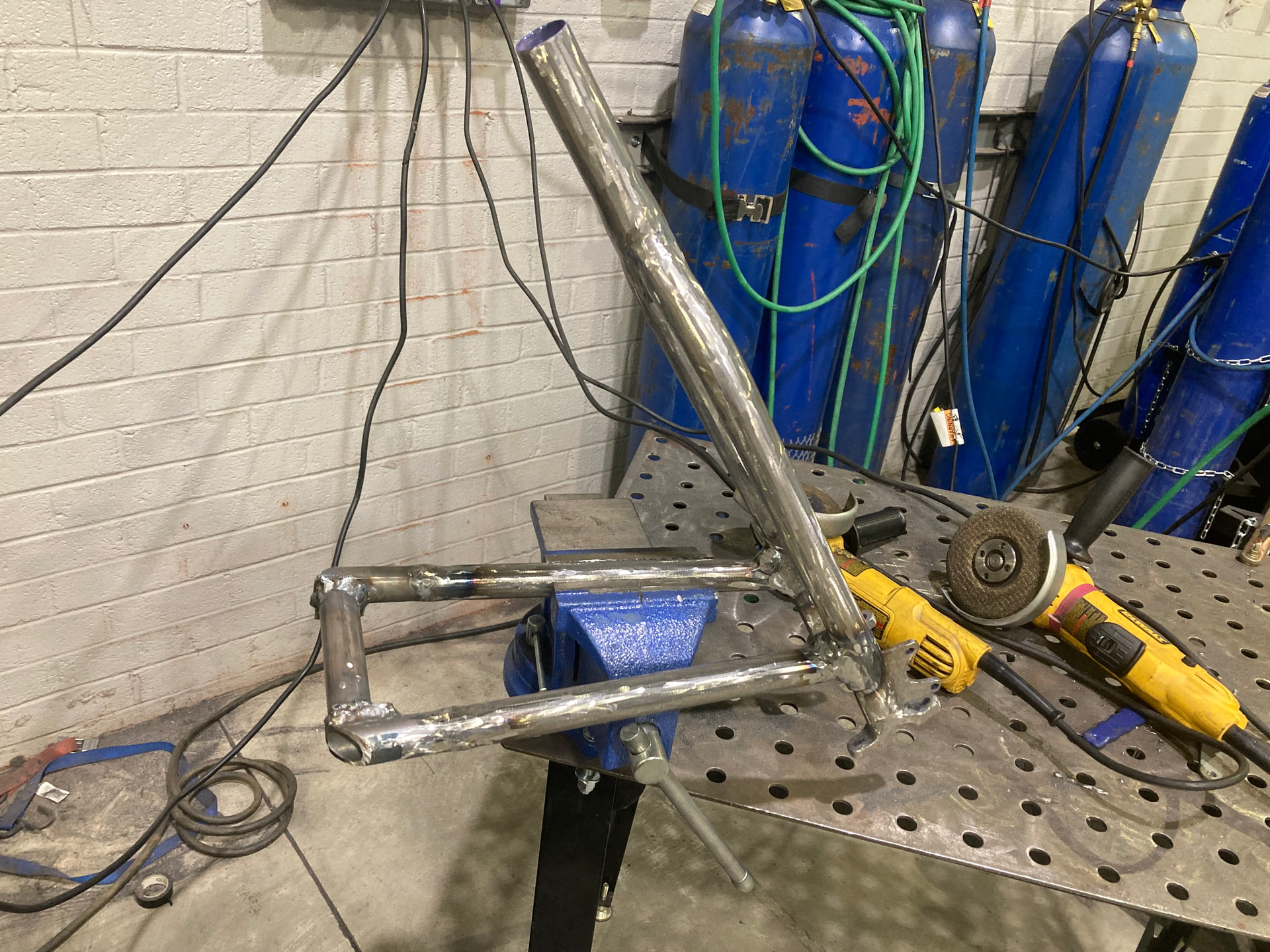

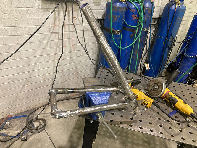

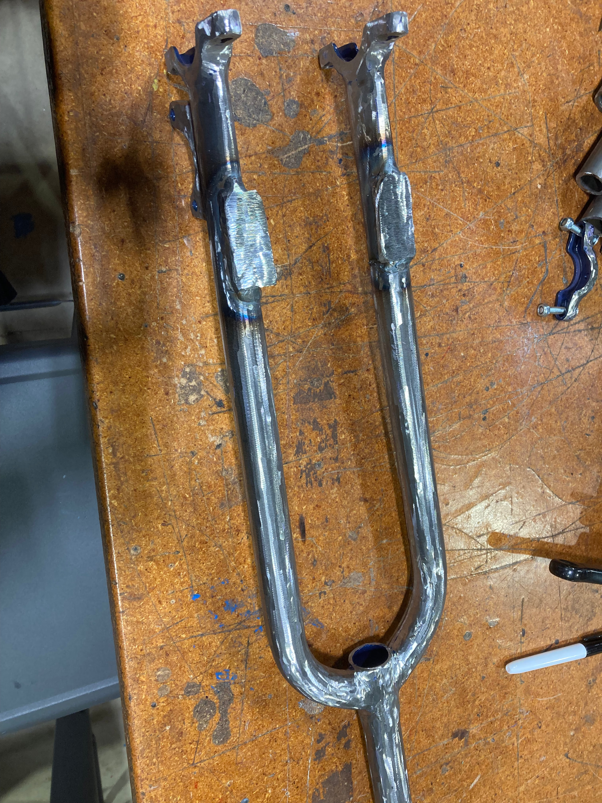

Did my first weld.. went well. I’ve since cut this piece in the center and grinded it down, don’t have a picture yet

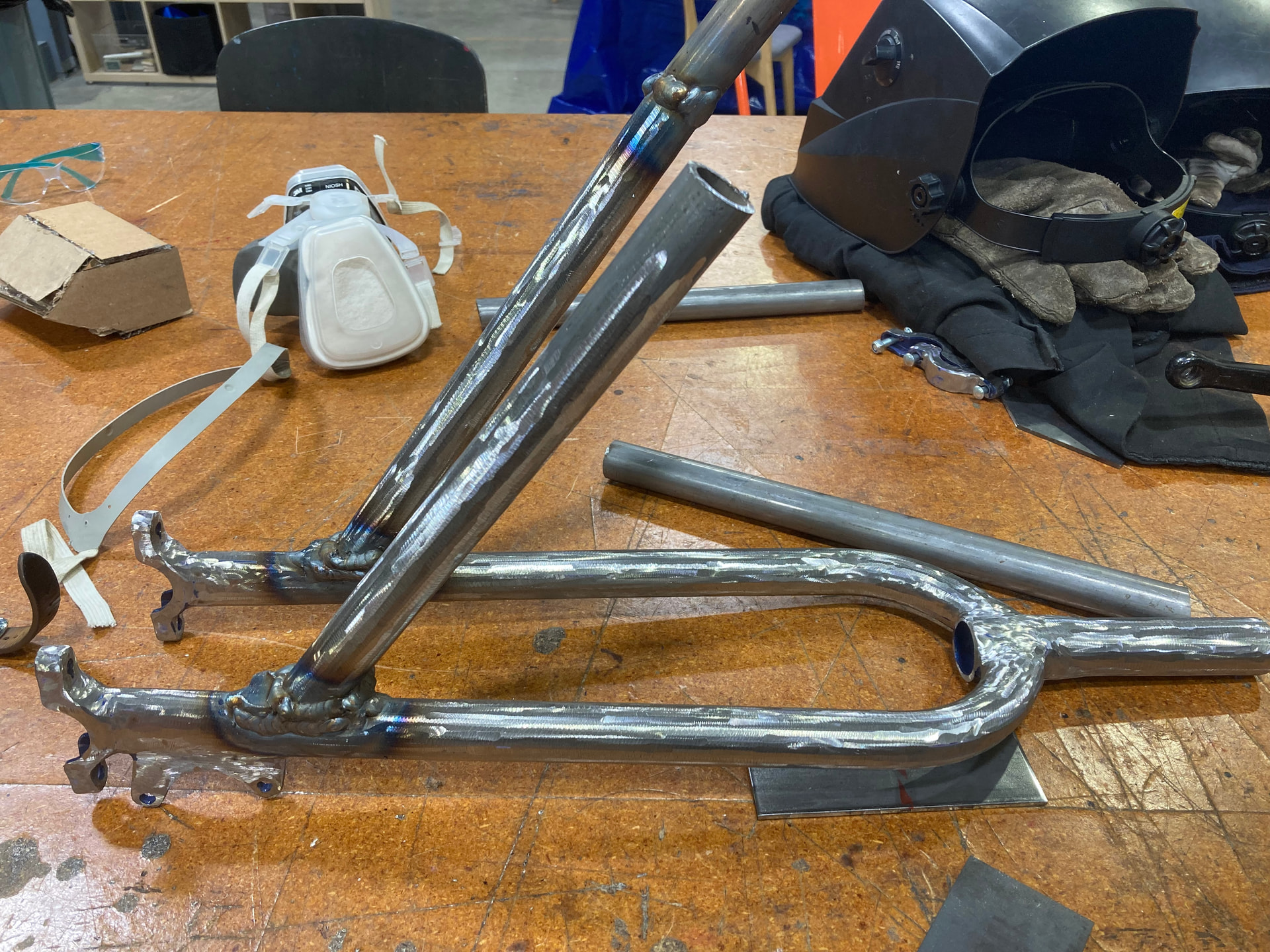

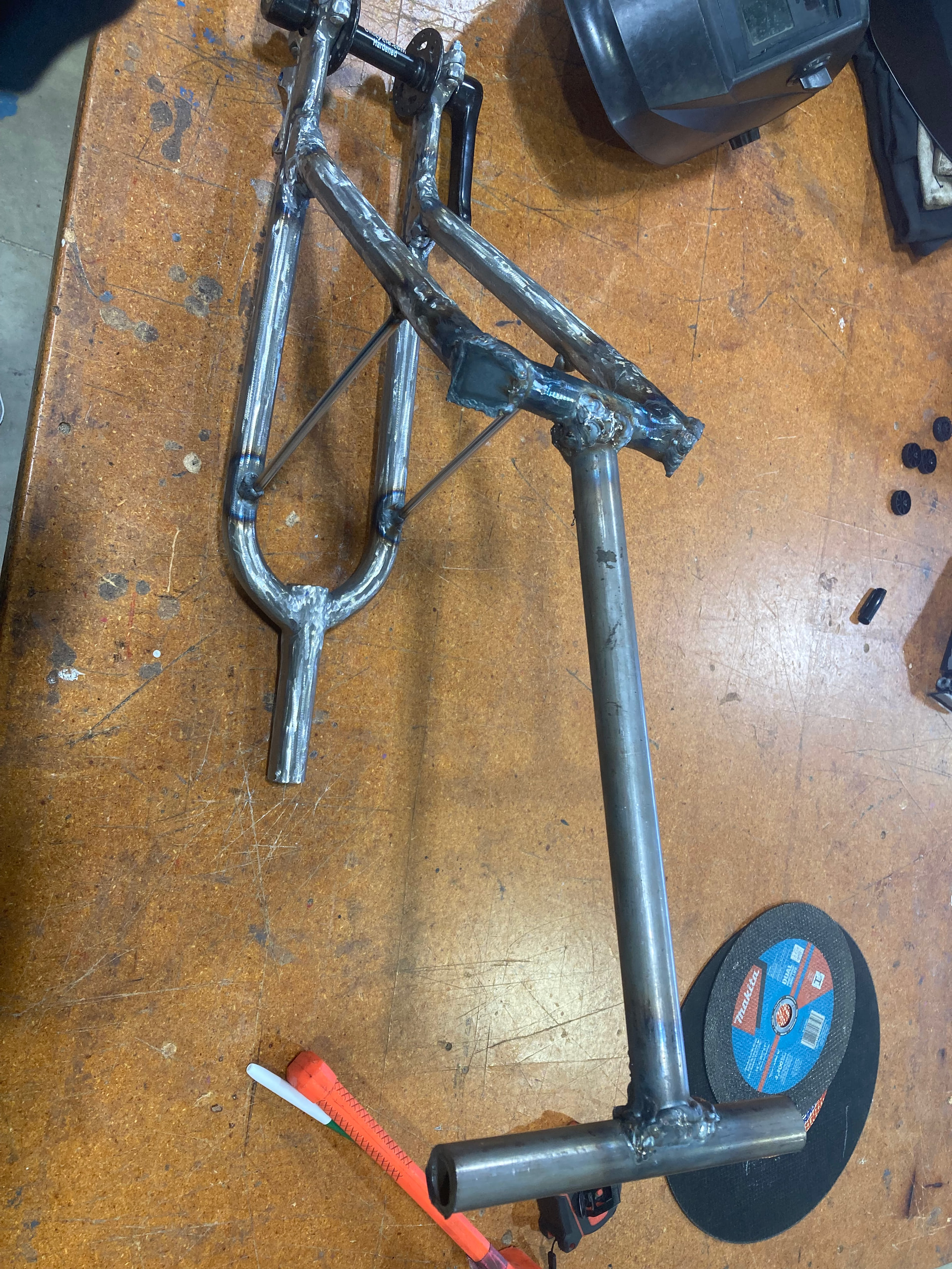

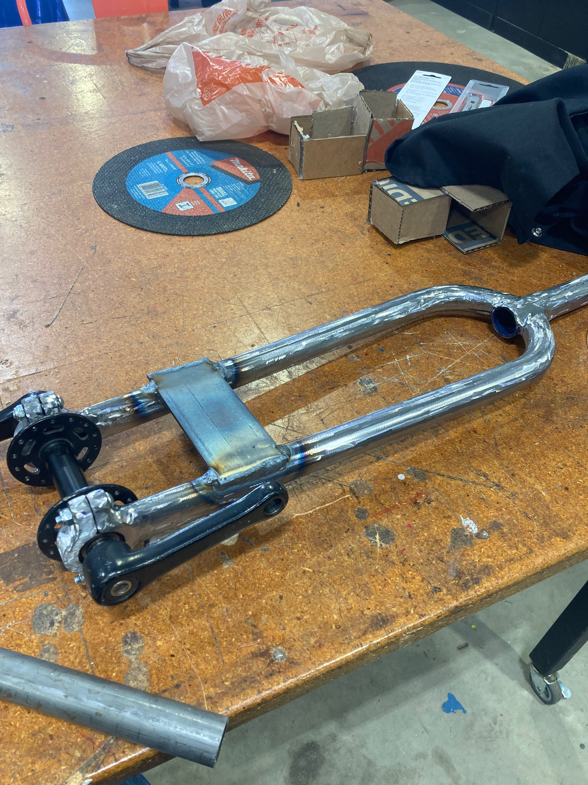

Currently what it looks like. I can probably finish it tomorrow

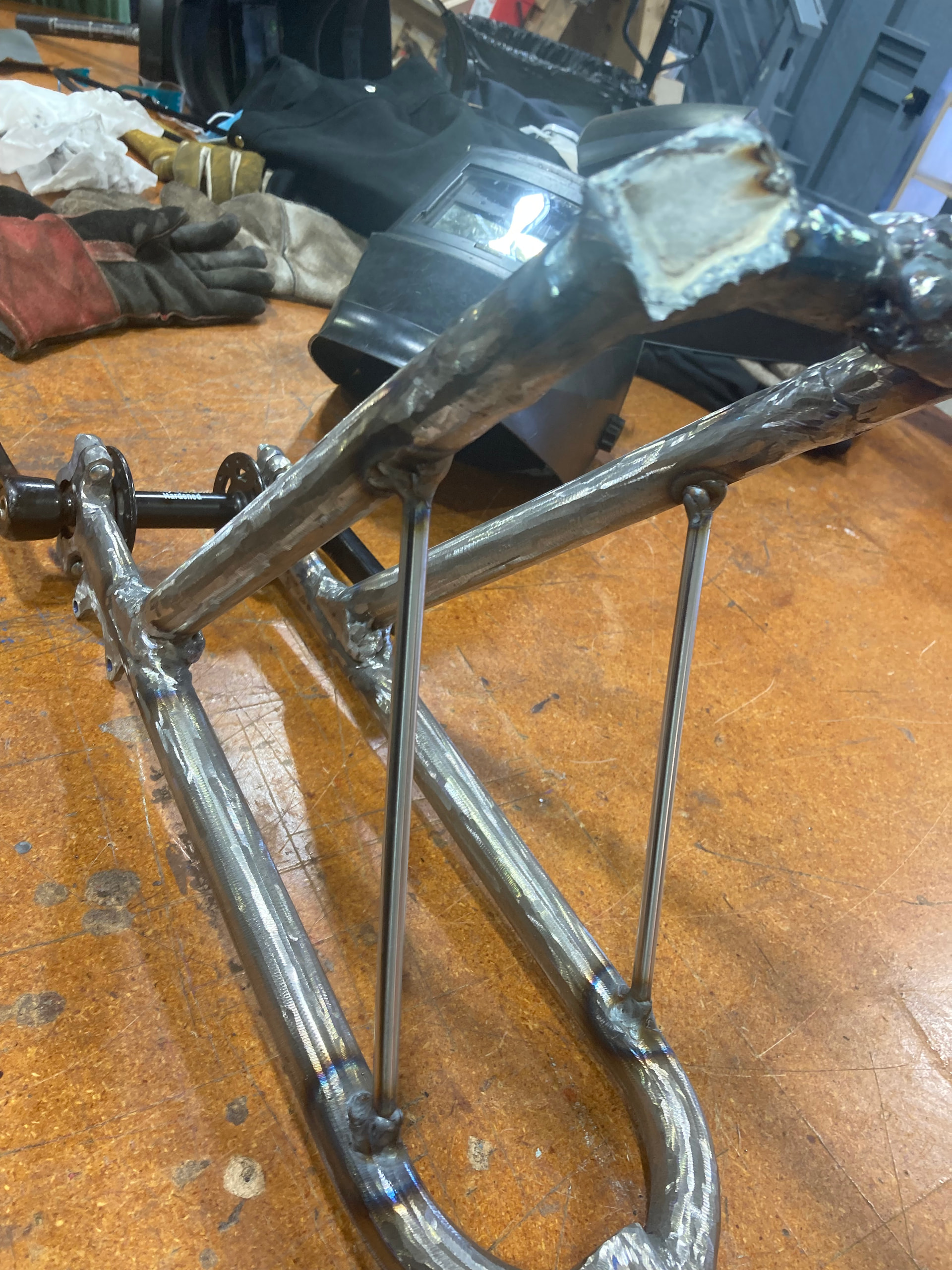

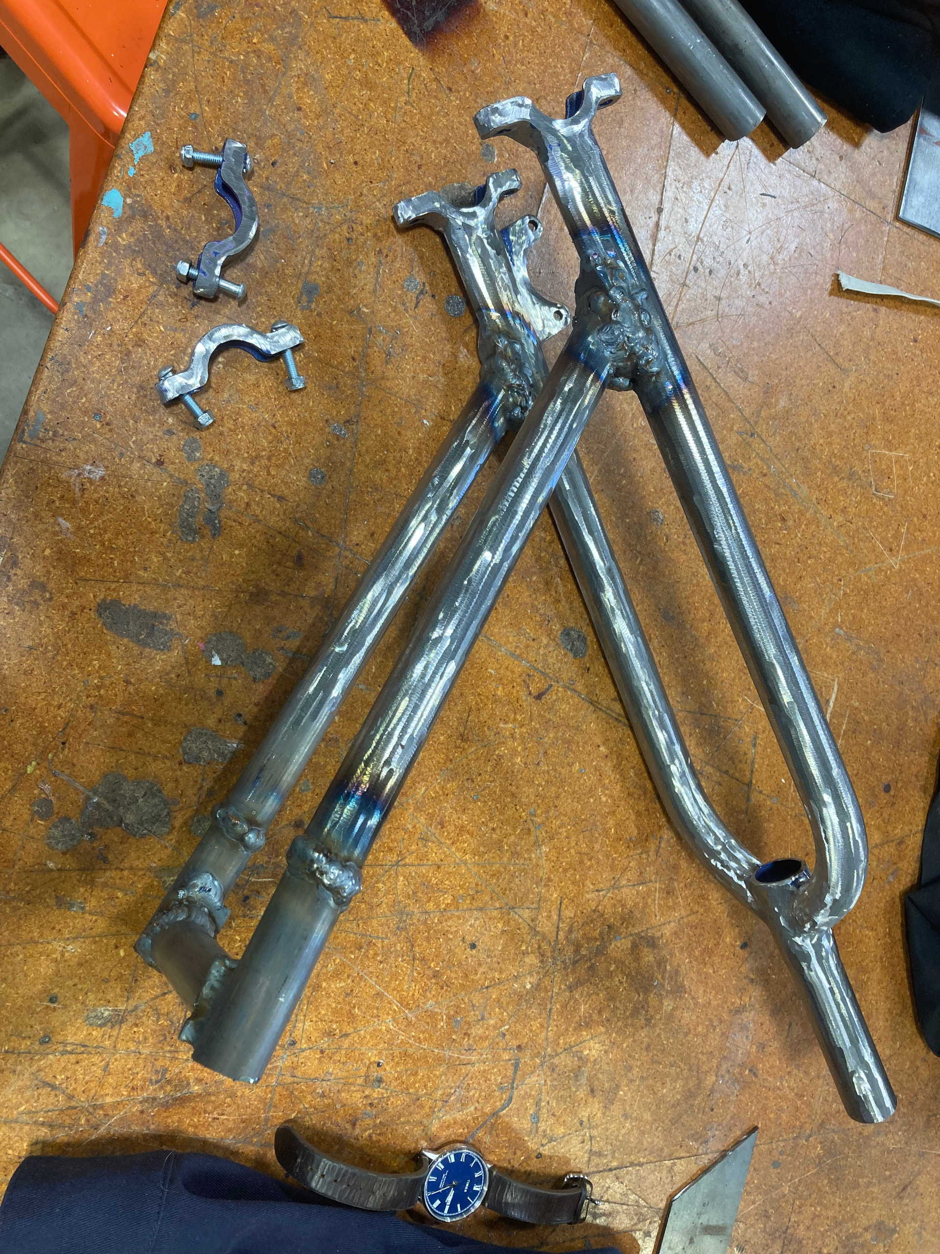

Finished welding! I now need to grind it down, sand it and paint
Not sure if its the angle but that looks like an insanely high bar placement?
