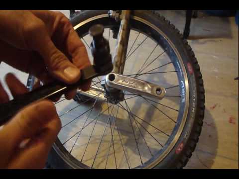

Just a little video showing Isis and square crank removal using a “Park” universal crank remover, with handle. There was a thread about the best tool and correct way to do it, so I thought this might help. ![]()
The regular park ISIS crank puller can also be used for square taper cranks. I could not find my puller for square taper a while back and just decided to remove the foot on the ISIS puller. All I needed was a tiny little allan key (I think about 1.5mm)
So if you have only one puller you can get away with the regular ISIS puller without dishing out the extra dough for the universal one.

The large size isis button will not go through the square taper opening. Does your “regular” puller (designed only for the isis?) have a removable button/disc? You mentioned a “foot”; is that another name for the disc? If it’s removable, then it is made for both isis and square. (And I thought it would be ok to post it in this forum, but maybe Gilby could move this to the tutorial forum.) ![]()

yah by foot I mean button/disk. Tomato, tomato.
It is not supposed to be removed but is assembled in a way that makes it easy to take off.
I have both a Park Tool ISIS puller and square taper puller. They are identical except for the foot/button/disk.
You could also use a square taper puller for an ISIS setup if you put a proper sized washer or coin in between the foot/button/disk and the axle.

Changed my default 127 for 114 Qu-ax cranks
Used a non ISIS crank removal tool -
Placed a 5 pence inside to make it work -
Had no issues… worked like a charm! Thanks for the tutorial!

I have a ISIS/Square taper crank removal tool with the removable button. But without the button it is not usable for this kind of hub as the hubs threadet bolt goes partly into the hole where the button sits normally and the crank remover would not push onto the bolt itself but only on the thread and destroy it. It was also not usable with the button installed, because the outer diameter of the button was bigger as the inner diameter of the part that screws into the crank and so the button could not be screwed far enough back into the outer part.
So I decided to do a little turning and reduce the outer diameter of the button. Now it works fine!
