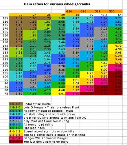

This handy chart inevitably pops up when discussing crank lengths (and the wheel size discussion that necessarily follows)
When it comes to why unicycle cranks are typically shorter than bicycle cranks, I think it mostly comes down to the fact that most unicycles are “geared” really really low compared to a bicycle. A single speed bicycle with an all-around gear ratio is running somewhere around 70 gear-inches, whereas even a Schlumpf 36er in high gear reaches only 55-ish gear-inches.
The average unicycle is probably more in the 20-30 gear-inch range, and our cranks are fixed to the wheel (99.9% of the time). This means that if we want to get anywhere at a good pace, we will be spinning, everywhere, all the time. Shorter cranks help facilitate that.
