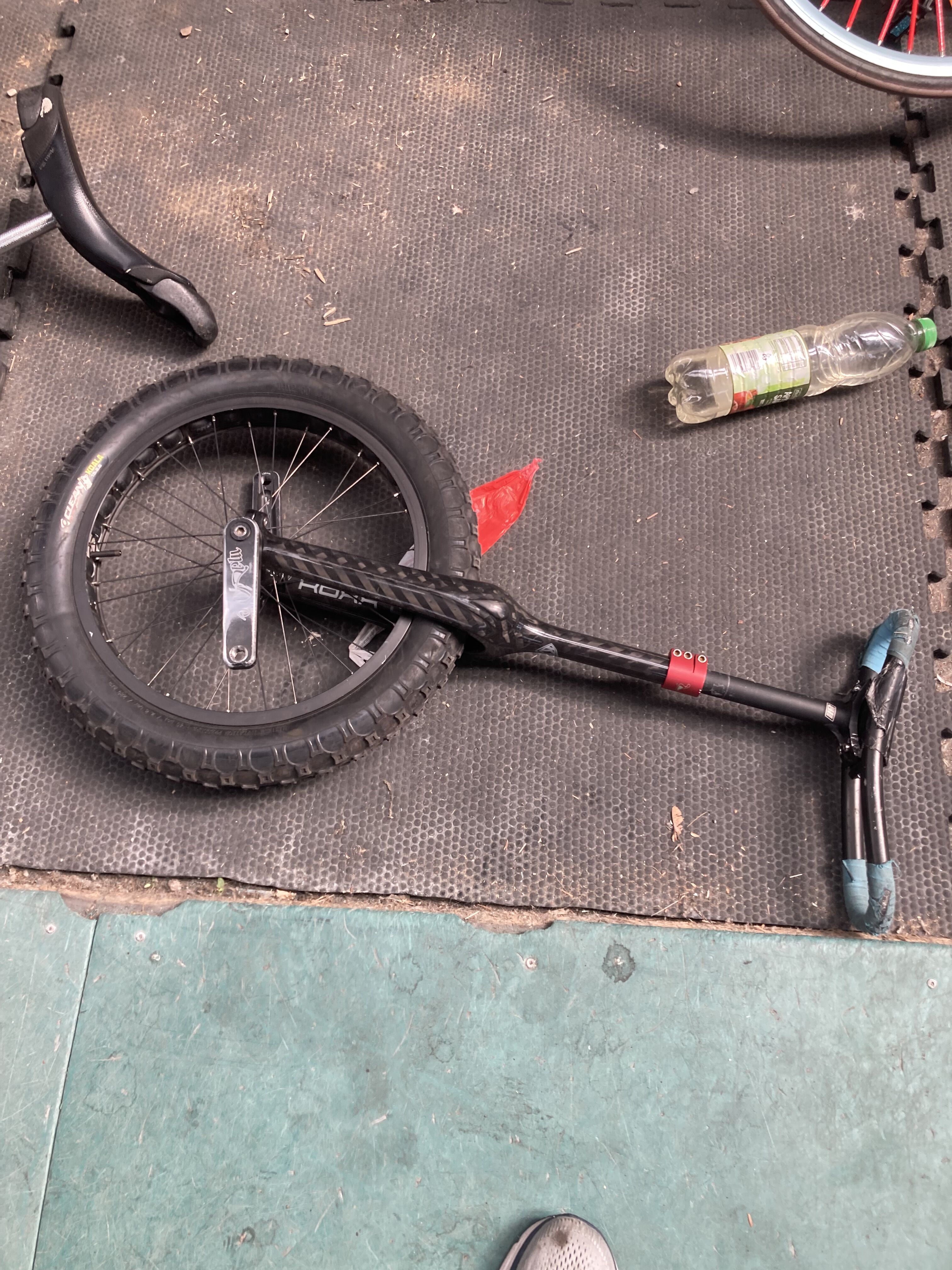

There’s several CF framed unis kicking around here. Koxx made one while they were still going and there’s a more basic one using CF tube and machines crown/bearing housings.

Koxx used to make carbon fiber frames
