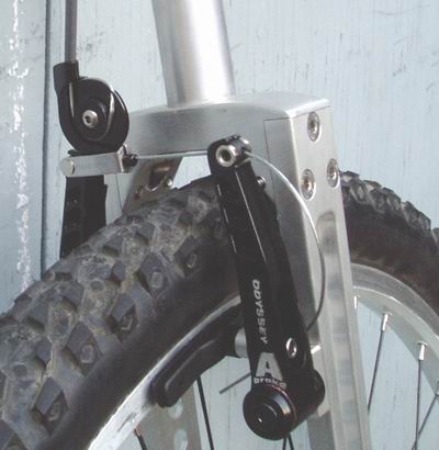

thats like the one i have…im in the need for cash latly (new project) i may sell mine. it black too,just like that photo.
heres a pic of it when it was on the Super 29er. the roller is there because i was useing a none V-brake lever. i can sell that too if you want it. it allows the use of any lever.
yup, that’s it. Quality bike parts (one of the major bike parts distributors) doesnt carry them anymore either. Cant find em on danscomp either. which is what leads me to think they’re done for. I dont think bikers like how heavy they are. which doesnt matter as much on a coker frame.
