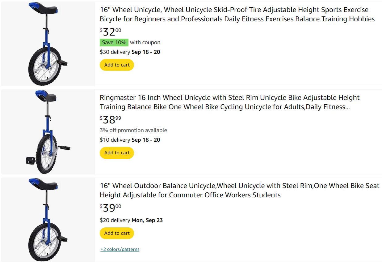

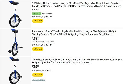

The thing that got me thinking though came about after some digging on Amazon.com. Out of curiosity, I decided to check out the least expensive unicycles they had to offer. And oh boy…
Pages and pages of what appears to be practically the same unicycle, under dozens of different names… Also, sub-$40 unicycles??

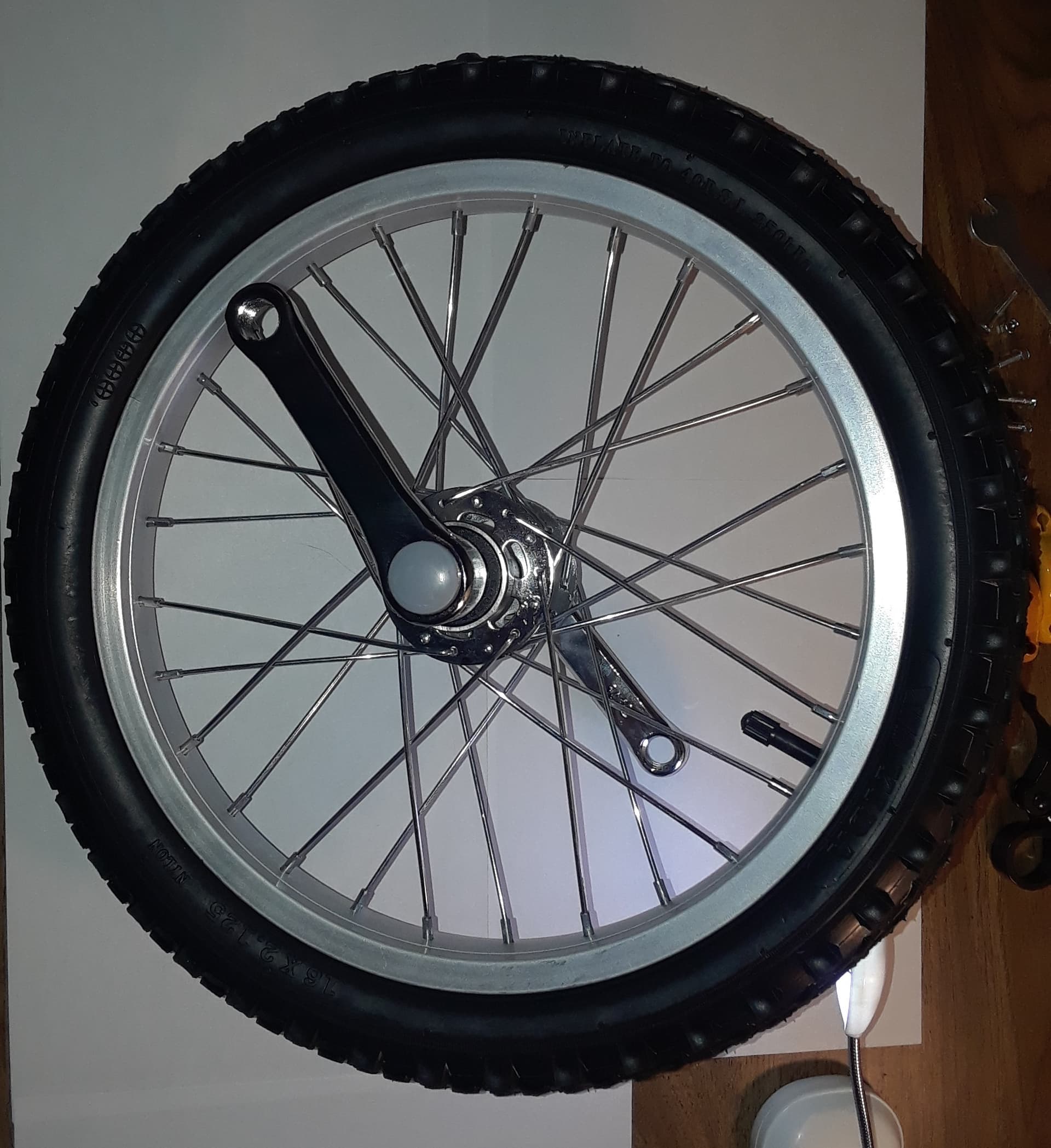

36 Steel Spokes
Count carefully…
Oddly enough, I found one posting that correctly stated that the wheel had 28 spokes.

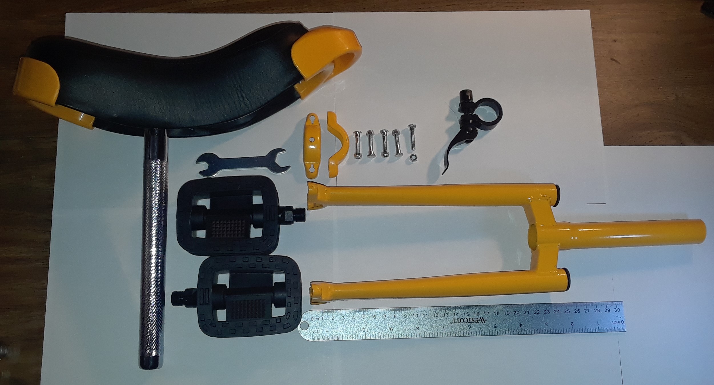

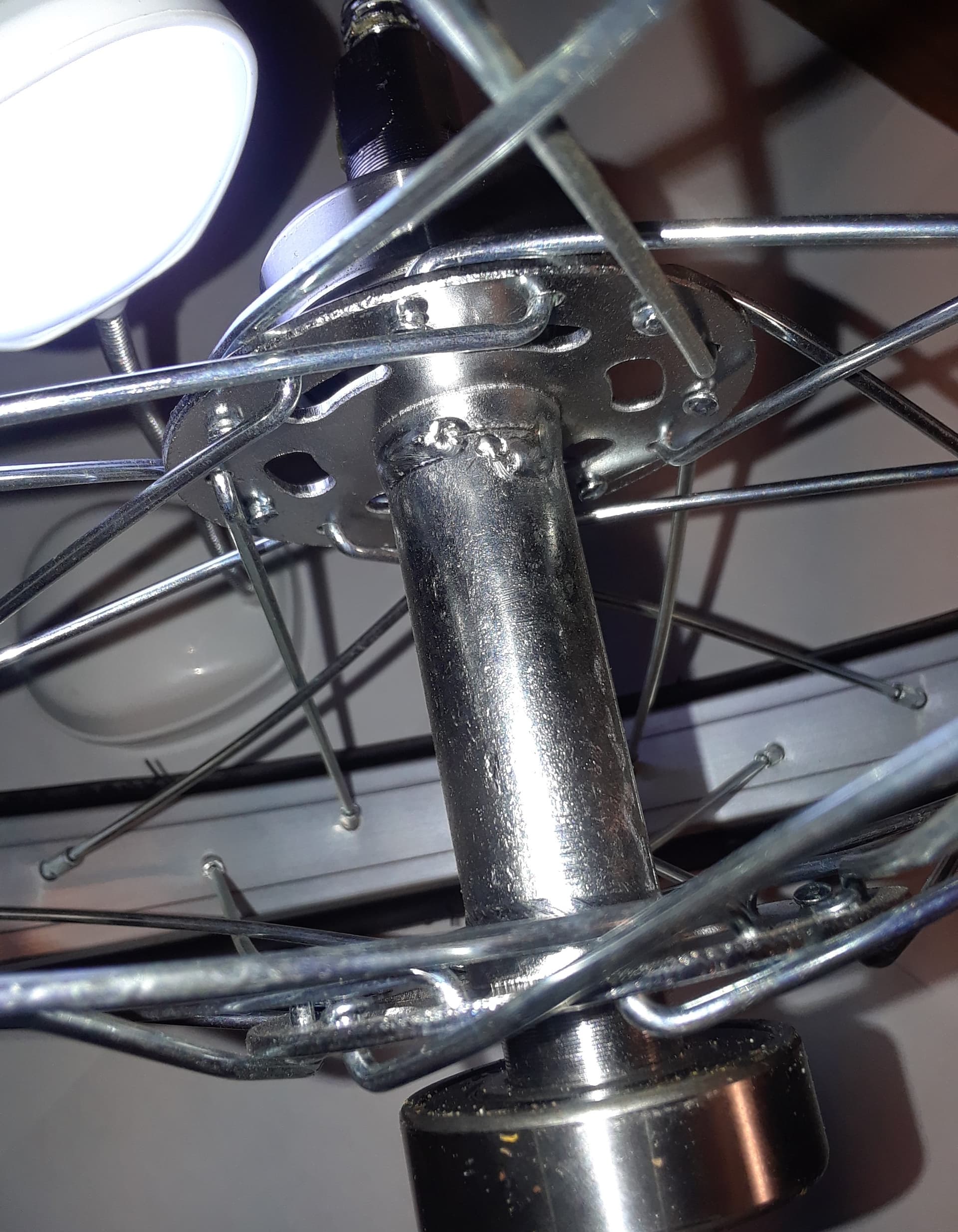

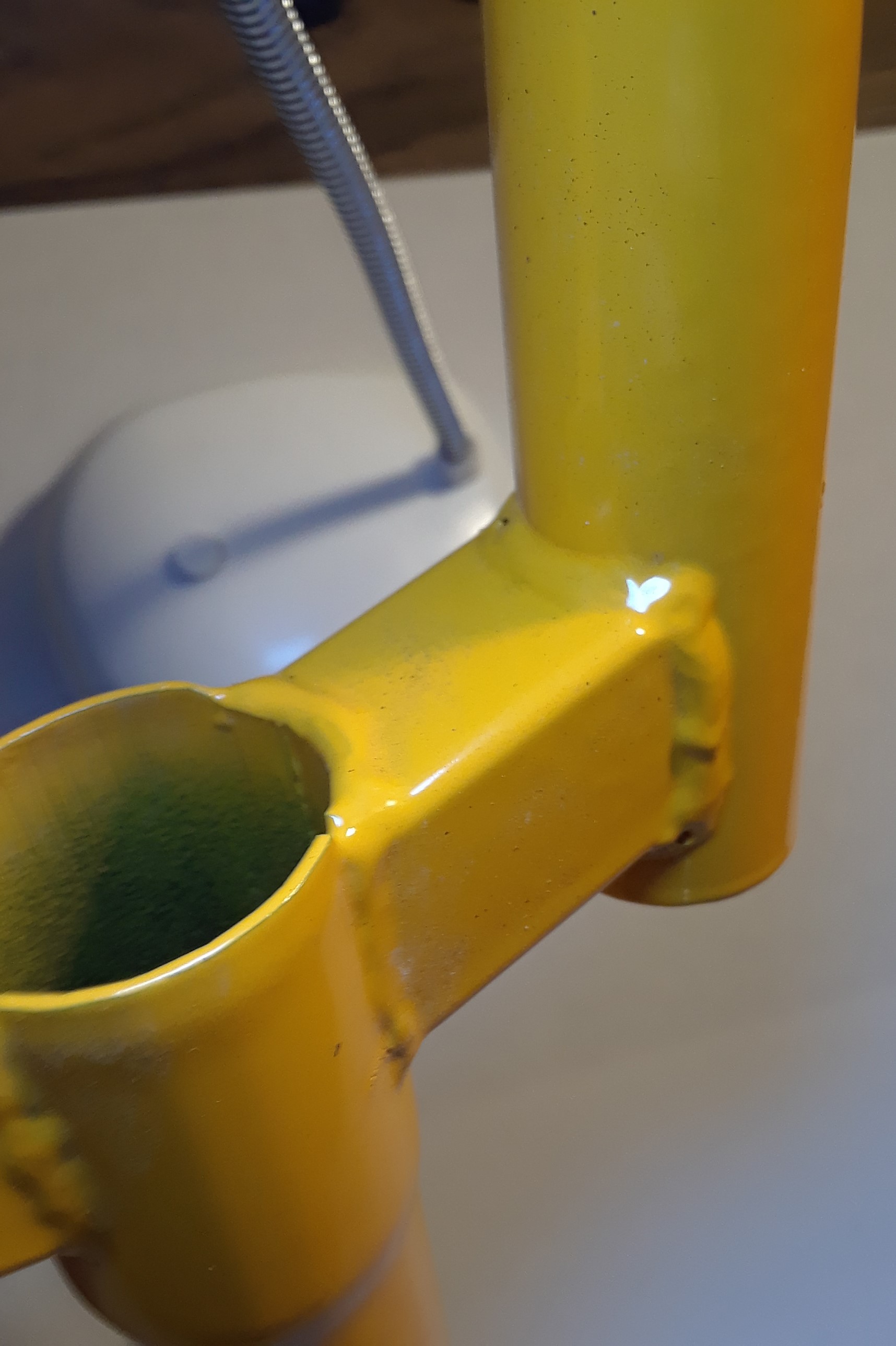

The first thing I did once I got the parts was go through the metal bits and inspect the welds.
There was one spot on the frame that didn’t look quite right, but other than that the rest of the welds were nothing to worry about.

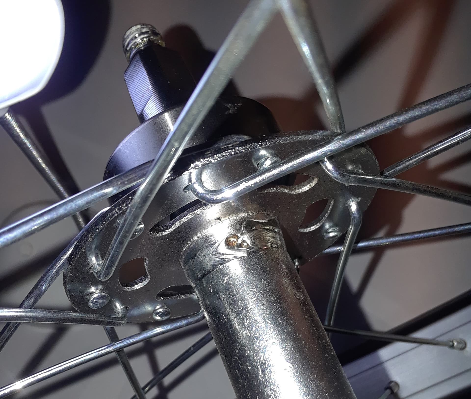

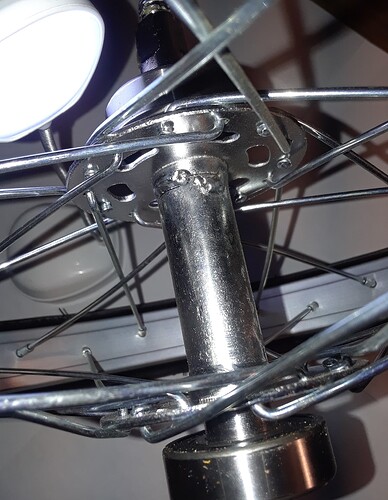

However, when I got around to the hub…
A section of the hub that doesn’t have a complete weld isn’t something I would have hoped to see. I haven’t noticed other iffy welds on the frame or hub outside of those pictured.

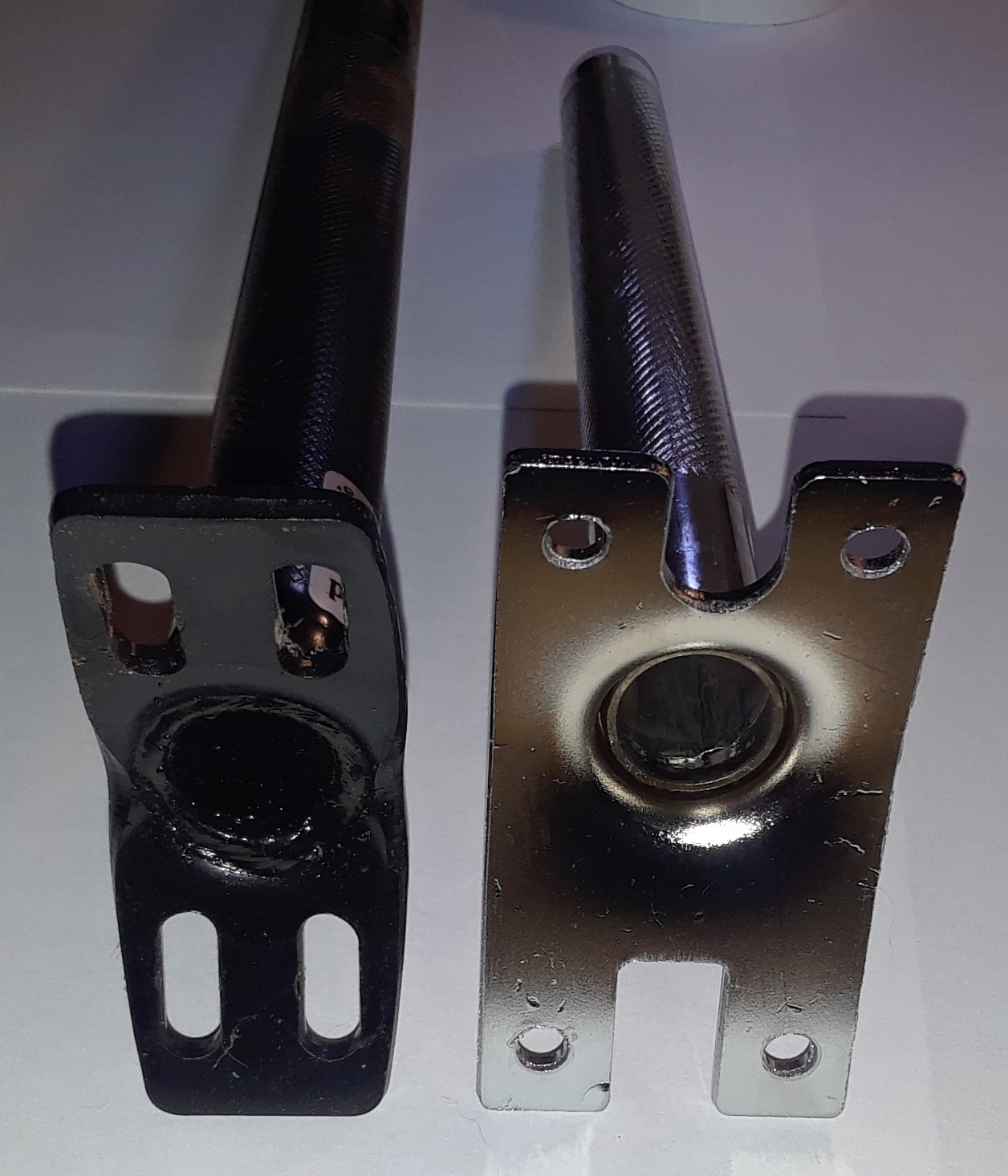

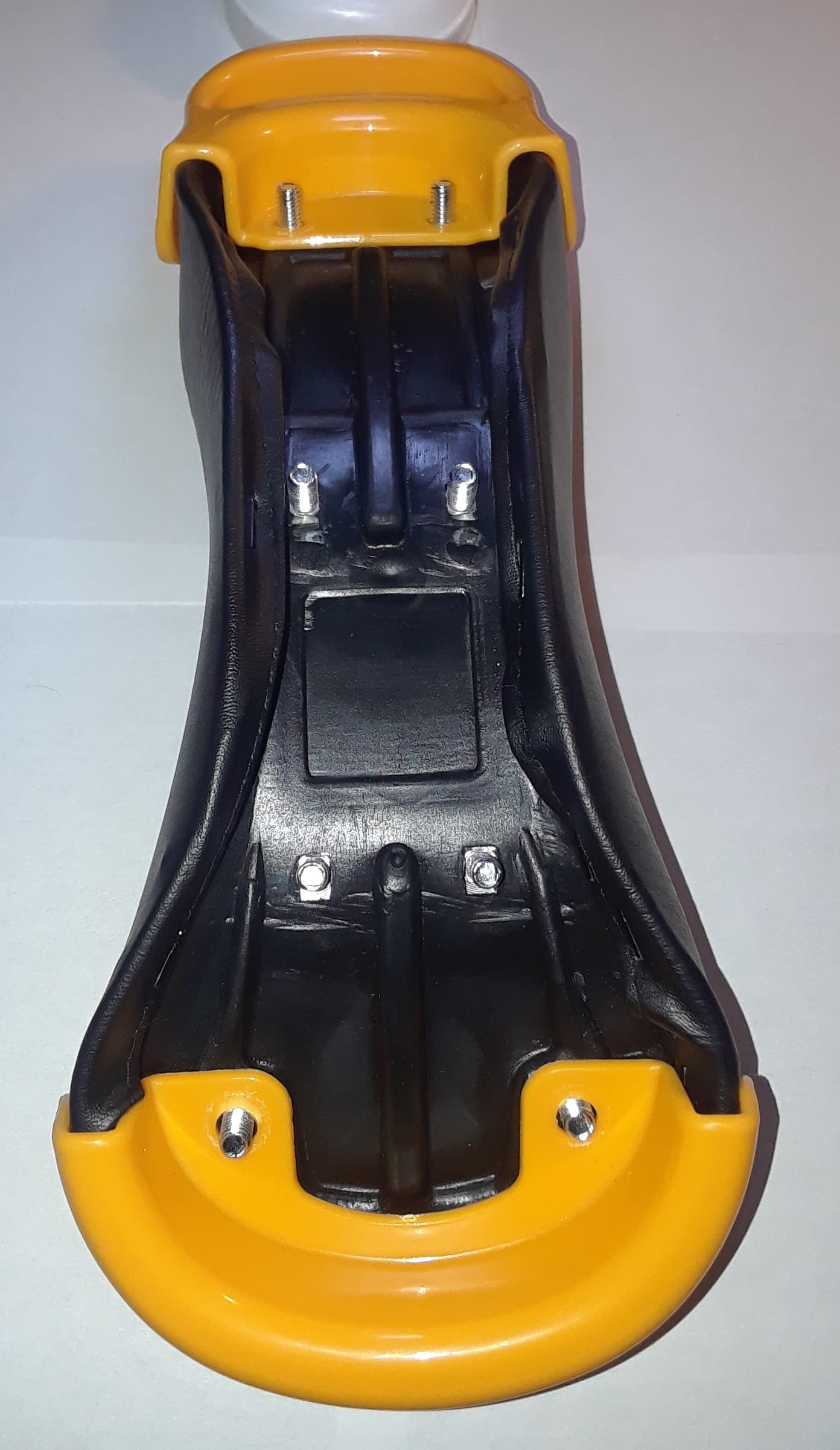

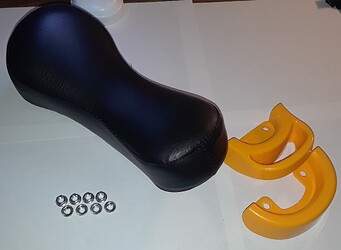

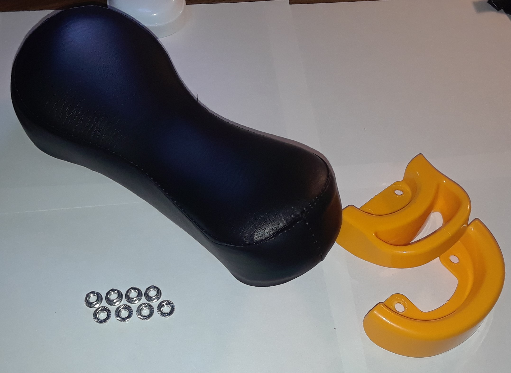

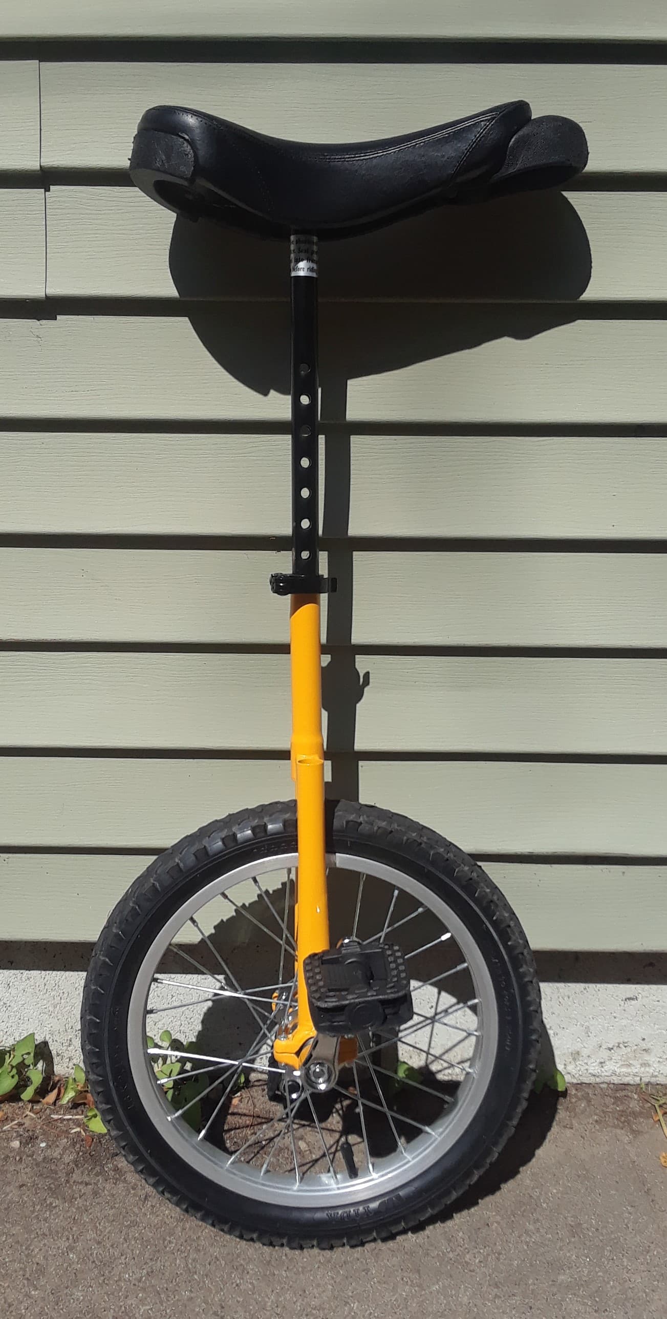

Another important thing to cover is the seat post. The one provided isn’t quite tall enough for me, but I was lucky enough to have one on another unicycle that made things a little better. But considering not everyone will have immediate access to a taller seat post, that will be an extra cost to those that need it. In addition, the seat provided isn’t compatible with the mounts found on UDC seat posts (or other similar ones)
The seatpost on the right belongs to the 16" unicycle. The seatpost on the right came from my Club 26", which isn’t compatible with the 16". The longer seatpost on my 20" uni that was compatible had an identical mount to the left one
I won’t be able to say much regarding how comfortable the provided seat is being that I’ll be using a different seat along with the longer seat post, apologies for that.

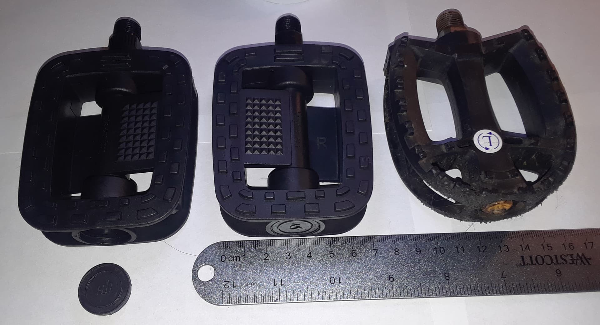

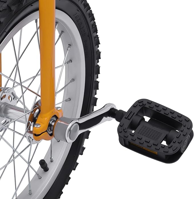

The pedals provided utilize the same threads as found on most other unicycles/bikes, so if you choose to they can be swapped out. Before I installed the pedals I tried turning them to see how smooth they were, and they were… Almost the opposite. They were quite stiff out of the package, but after some turns they smoothed out somewhat. My old beat-up pedals on the 26" were still somehow smoother…
The rightmost pedal is from the 26" Club for size comparison.
