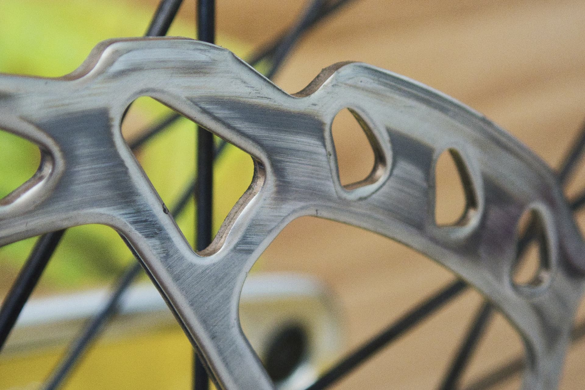

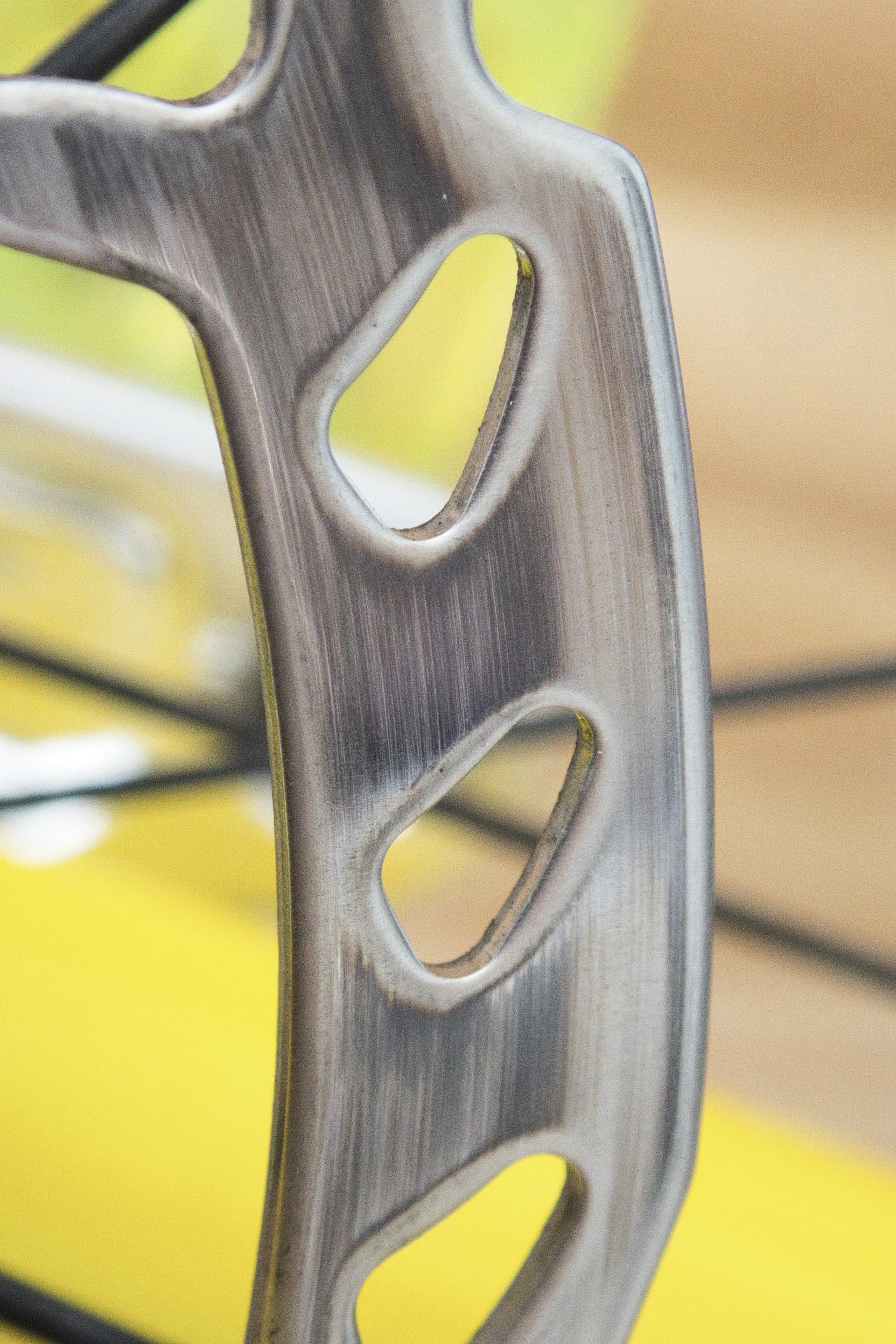

Absolutely sure. It‘s not that typical high pitch vibration that you sometimes get with disc brakes. Also, there’s no d’brake adapter on this Flansberrium uni. Yesterday I switched wheels between two frames, and the disk in question is now indeed on a uni with a d’brake (without Hugo strut). IWell, it behaves just the same.
Here are two pictures that should make my point pretty obvious, I think:
The white “halos” around the cutouts were never touched by a brake pad :frowning_face_with_open_mouth:
That was one reason for me to buy it. In case I want to try out metal pads later.
I don’t have complaints about the braking performance other than that disturbing vibration thing.

Is that from stamping the hole during fabrication?
It feels like the braking trace is a bit too low (isn’t it supposed to run over the cut outs??).
Maybe the IS adapter for your brake is too small and you need the next step up :thinking:
That‘s possible. But then, it does appear to run over the cutouts, even though the trace doesn‘t appear black towards the outer rim.
I have one brake where I already put shims between the adapter and the caliper, but I don‘t know on which uni it is. I’m sure that I didn’t mount a 180mm disc and a 160mm adapter, but maybe I mounted the adapter the wrong way around?

Either from stamping, or from polishing. When new, the disc was very shiny - not the surface with grinding marks.
