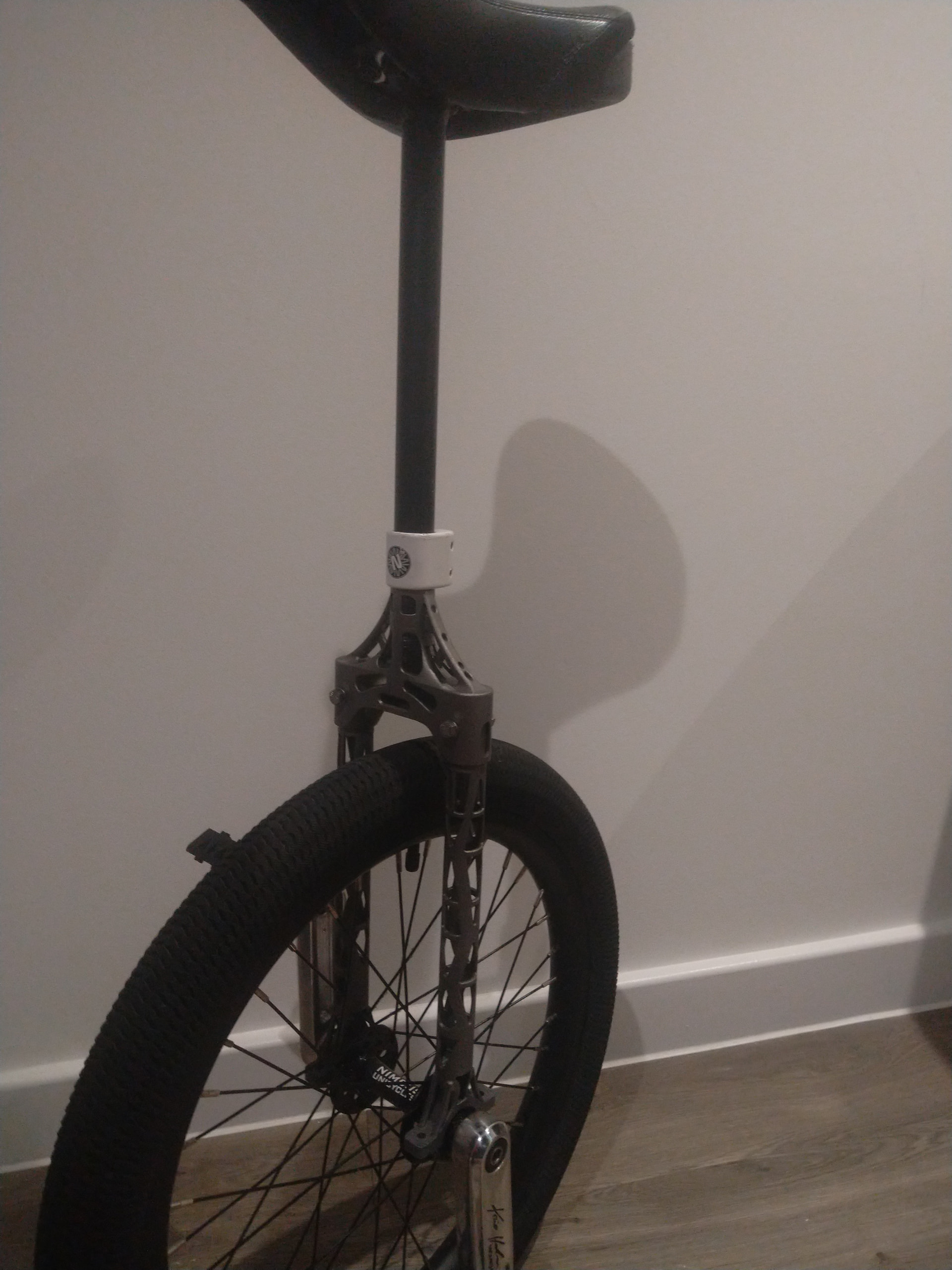

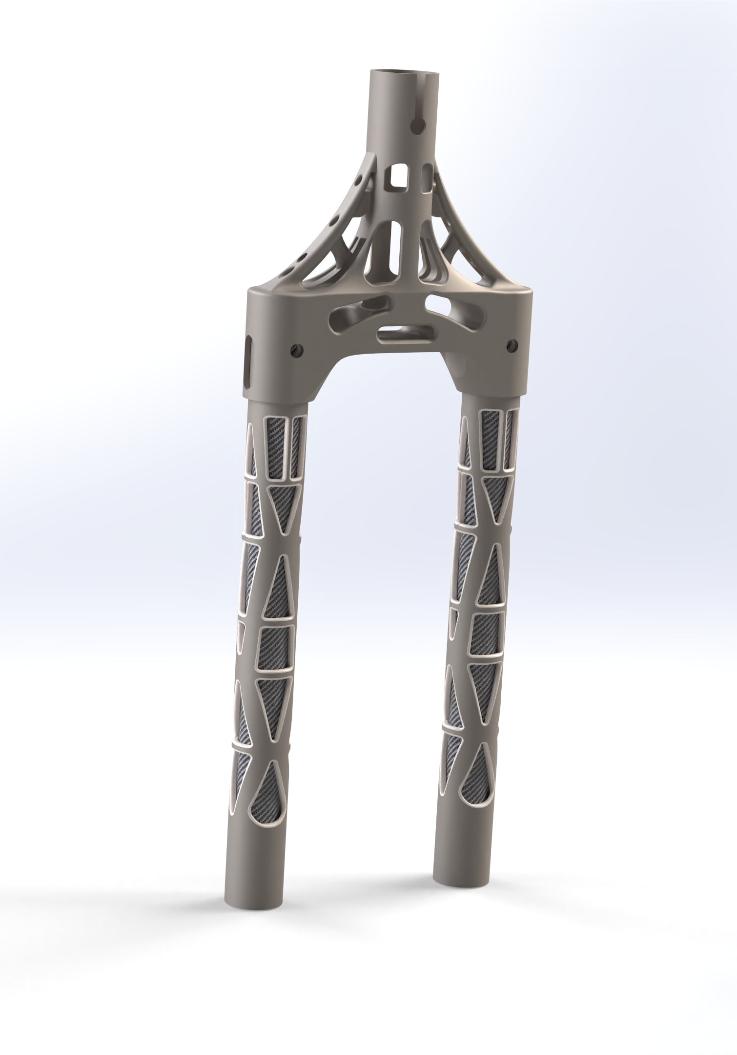

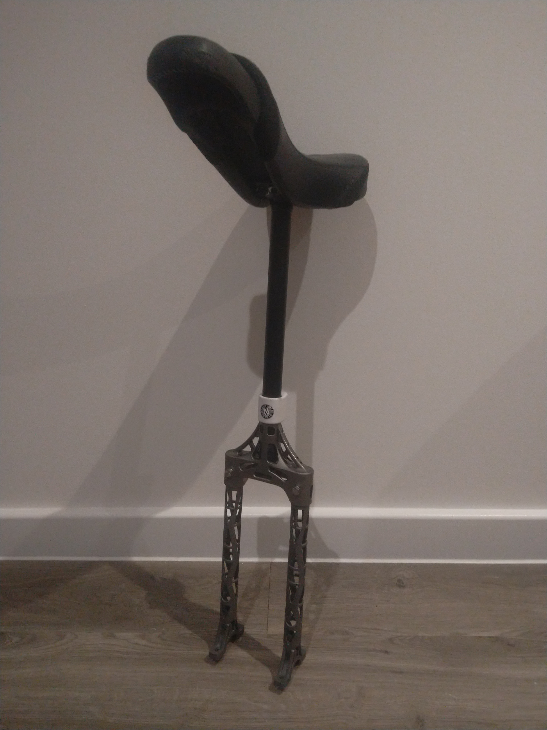

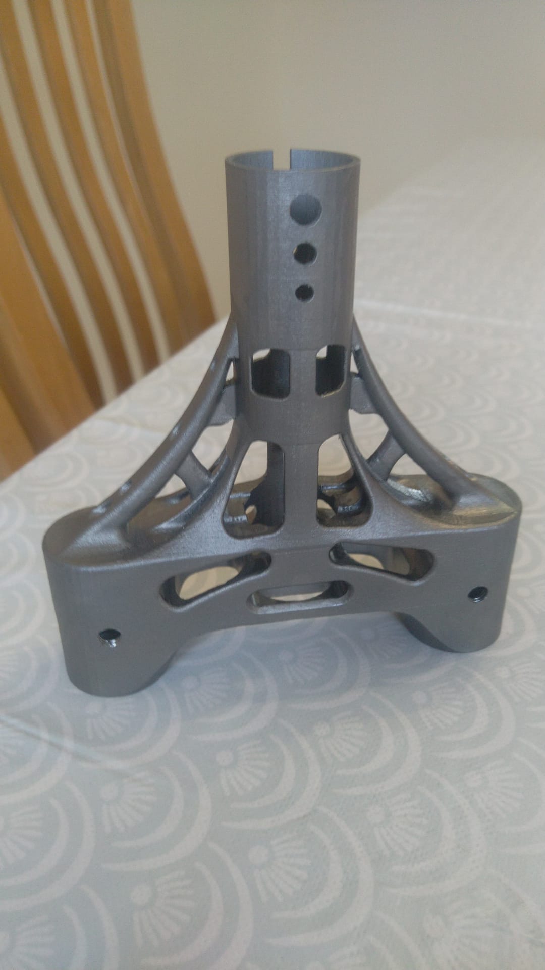

This is my first post I wanted to share with you as I’m engineering a titanium carbon unicycle with the legs being made from a carbon fibre wrapped titanium tube I’ve made the frame crown and the seatpost fits in so i got it titanium 3d printed I’ll try and update you guys along the way anyway here are some photos.
Plastic 3D Printed Prototype.
Titanium 3d print:

I wonder how rigid the connection between the crown and the legs will be. I assume it’ll be a press fit, with a bolt securing the leg. Is there a (ever so slight) taper on the crown side of the interface, or is it cylindrical? Or are there minimal ridges? Or…
Its going to be bolt fit just to line it up so i can get the lengths right and to hold it in place. then the titanium tube will be either brazed or welded onto the crown
I’m curious about the print. Did you go through a titanium printing service or do you have direct access to the printer?
Also to add, I love the uni :slightly_smiling_face: Looking forward to how it turns out!
yes i went through JLC-CNC it was pretty easy and cheap for what it was.

You wrote that you will braze or weld the legs to the crown. That begs the question what the CF is for - after all the titanium legs appear strong enough as they are. Or are they butted, i.e. thicker at the end that will connect to the crown, so that the CF is only applied to the bottom part? Or did I get something completely wrong?
it was going to be a part of the tube where the inside has a small tube of carbon fibre tube while the outer is mainly titanium I was thinking about doing something like this
But it will cost way to much to manufacture and make only spent £120 on the crown so far but this will add way more than rather being £40 for the titanium tubes this would be around £150 so probably one of the most expensive unicycle frames. I have a tendency of overengineering things and making things to last a lifetime but that usually ends with things not being cheap this. As I’m in university I had to save just for the fork crown for a while but in the end it may not be worth it although it would be lighter than the pure titanium legs it would probably give the same end result.

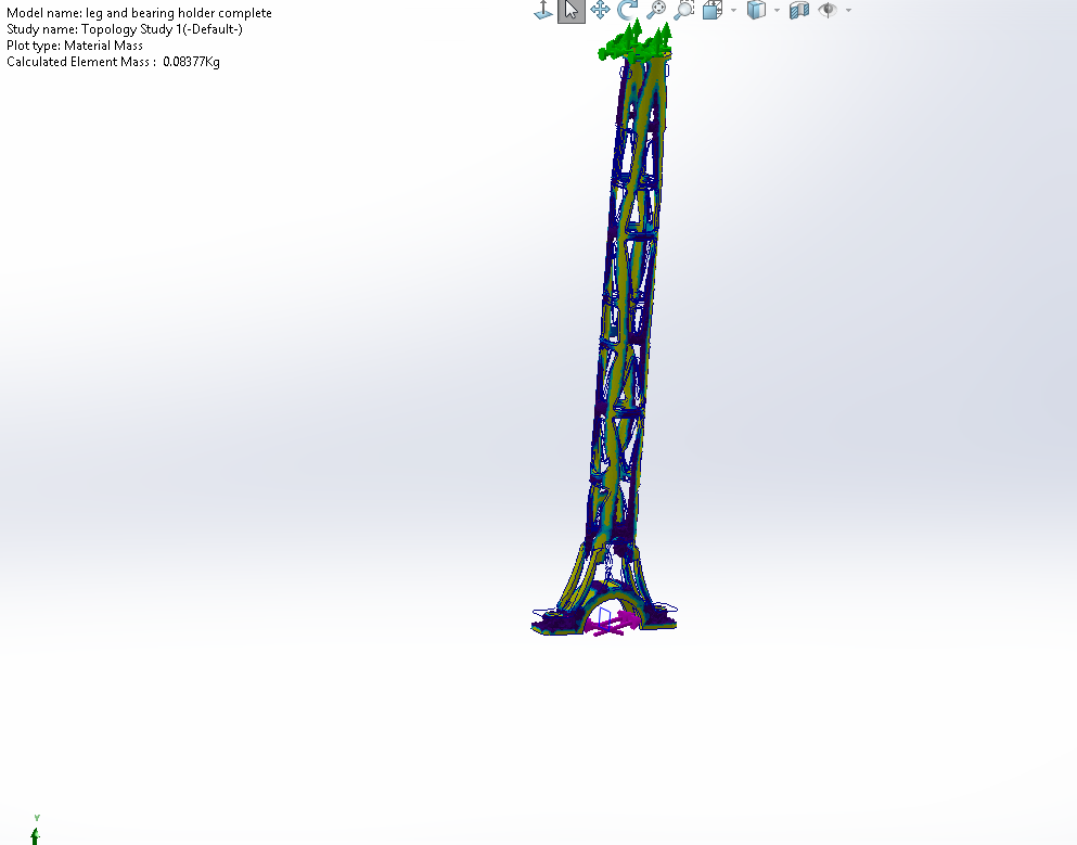

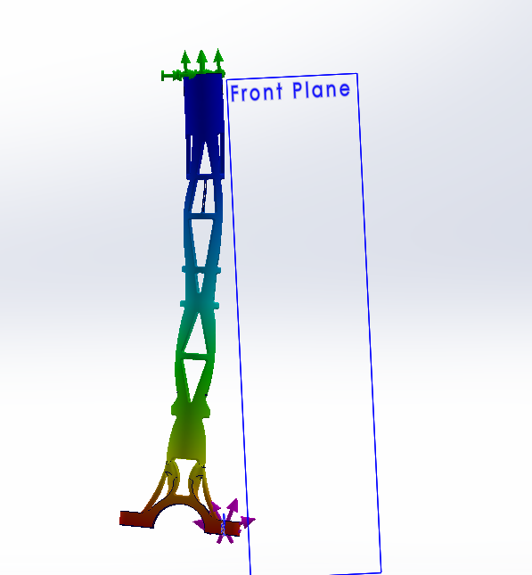

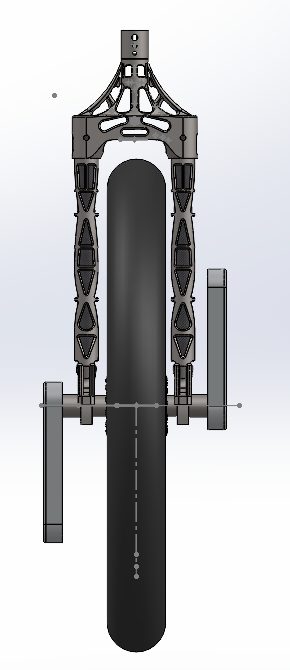

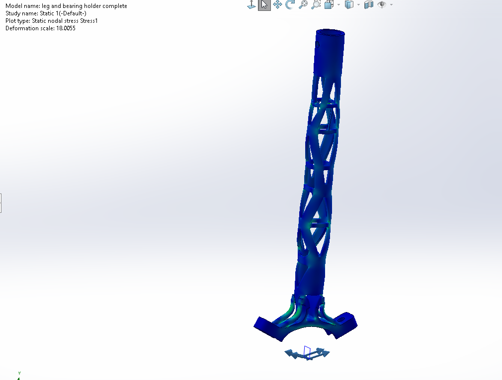

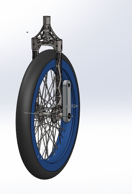

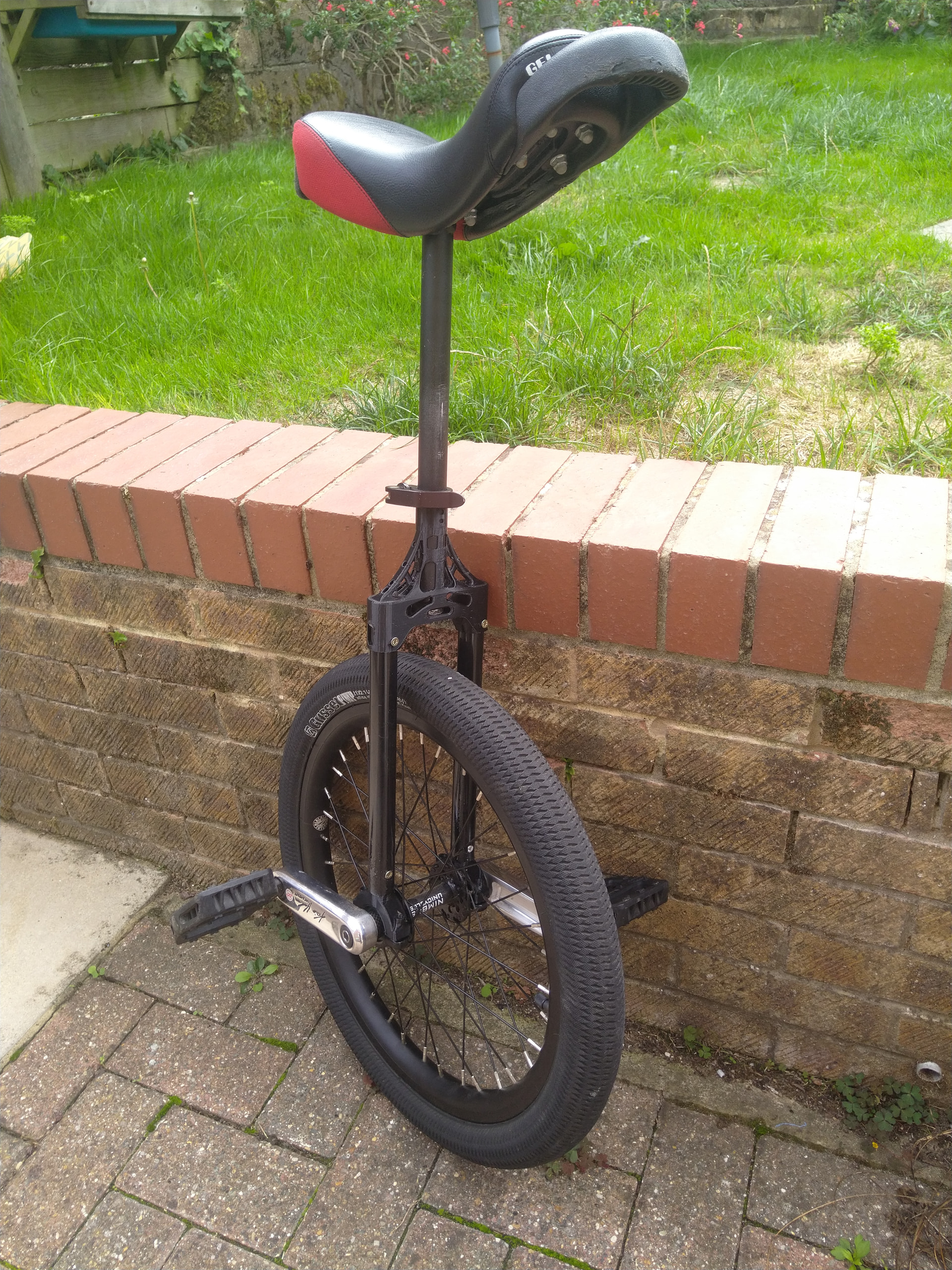

(BIG update) ive completed the frame doing tons of tests over the past couple of days here are some photos and improvements on the design. Its been made so that forces have been accurately calculated and been put on the frame to make one of the stiffest “lightish” frames out there using topology optimisation and tons of tests and simulation results. with reinforcements in areas that need it and doing tons of hours of studying the results and changing parts even calculating the forces to extreme measures that are put upon the wheels with simulated tests that where tested to 20 tons of force to see failure and areas that need improving.
Hopefully when I get the frame assembled and tested notoriously I will try to start a website and business to start selling the frames. This is if they past the testing results as its not guaranteed to be perfect on the first iteration. Now i just have to sell one of my unused unicycles to fund this.
Ah, I see, now. Looks really cool.
Follow-up question (but by now you were already expecting this, right): Are the CF and titanium parts already „sandwiched“ when the legs are welded to the crown? If so, doesn‘t the heat damage the carbon? If not, how do you sandwich the two components? After all a tight fit appears beneficial as far as sturdiness.
Anyway, very cool procect; crossing fingers it works out as you were hoping for.
