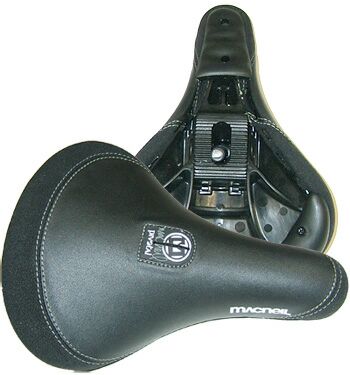

The concept JC describes is used on alot of BMX saddles, but with one bolt attachment into the center of the post, like the pic. You don’t have to use a serrated semi-circle mount, Scott Wallis’ is actually smooth and the 2 bolts provide enough clamping force.

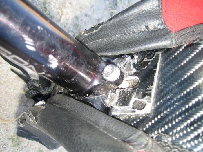

Here’s a picture of what it looked like on Zack’s old uni. You can see that he constructed a carbon fibre piece for it to work on the outside, but I don’t know what he did to hold everything in place on the flipside. I jacked this from unicyclejester.com:
Zack, Ryan, and I all did this. The way I did mine was I took the bottom plate of the thomson rail holder and sanded it until it fit the contours of the cf base. Then I drilled for the two bolt holes. I sandwiched two pieces of thick innertube between the plate and the base to keep it from scratching the cf. I was never particularly impressed by the results, but it did work. From an engineering perspective, i think the rail adapter is much stronger for a host of reasons.
