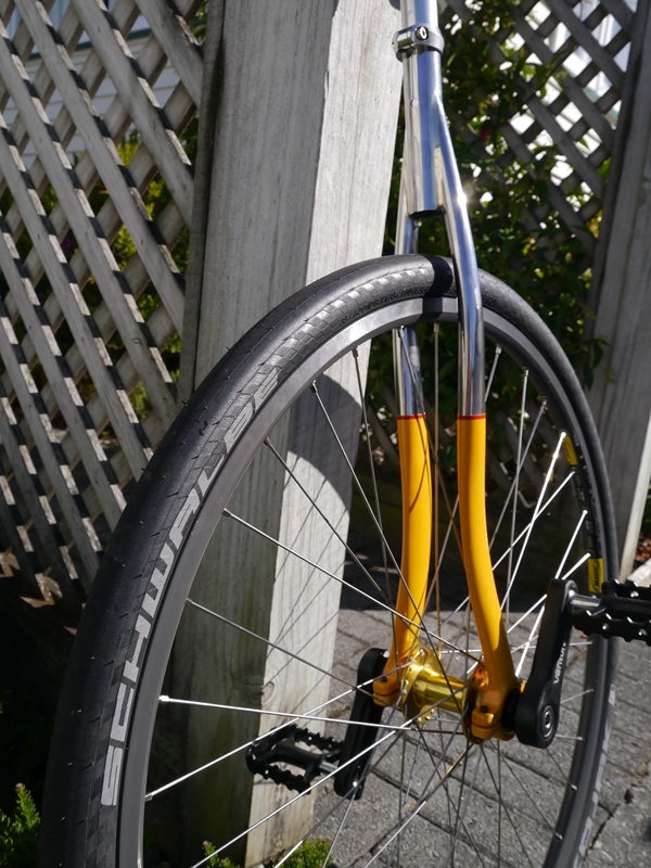

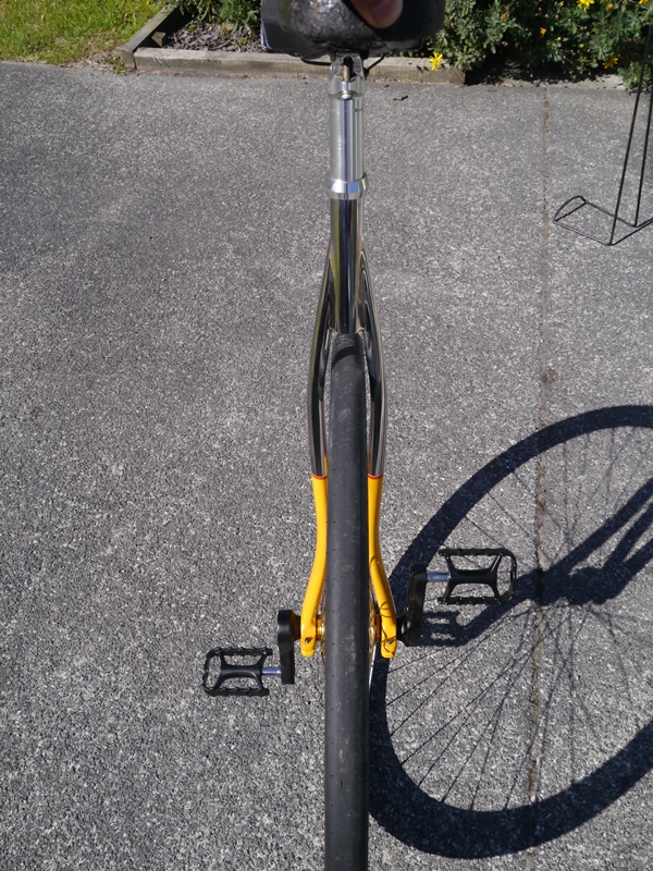

I’ve been busy building a custom 700c racer, using a KVA MS3 stainless steel tubeset. If you’re interested, here is my blogpost:

Where did you get the SS bearing holder? How were the SS tubes bent?

The Unicycle is custom built by a local frame maker, Anders Waiker from C3.
Most bicycle tube manufacturers produce a stainless steel tubeset, usually for their high end. They are quite popular among custom bicycle frame builders…stronger than Cromoly and corrosion resistant. We used a KVA MS3 road bike chainstay, which comes preformed in an s-bend and double butted. You can also get straight versions and mountainbike bends.

Do you plan to put a brake on it? If so, would you go rim or disc? If disc, looks like only outer would fit. Would there be enough room to weld on rim brake mounts?
Nope ![]()
Don’t need one, this is a standard unicycle.

bearing housing
Judging from the paint, the bearing housing is not stainless steel?
I was wondering the same thing, and why he painted it from the midpoint down, rather than keep it entirely stainless. Is that spray paint or powder coat? It also so shiny it looks like chrome!
I’m assuming they are Nimbus bearing holders. UDC sells them raw on their website for builders ![]()
I like the color like that, I think it adds a bit of personnality to the uni! ![]()
Painted fork ends were fairly common on older bicycles so I think it gives it a nice vintage touch. Very elegant and much better than if you’d just left it stainless.

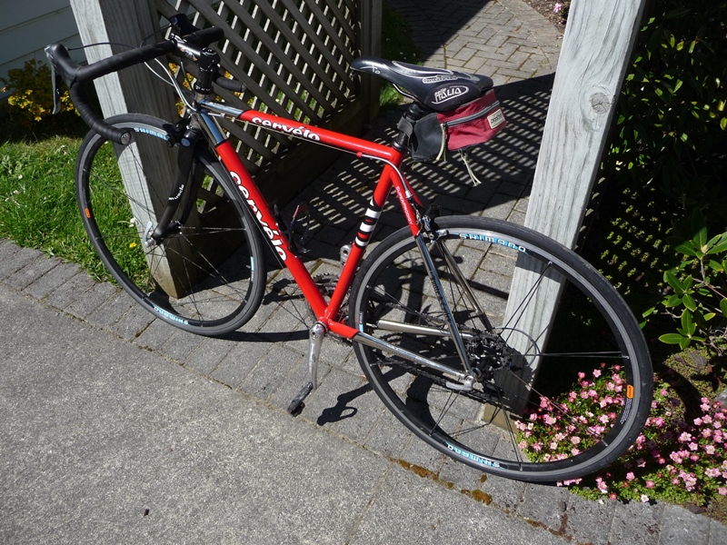

I don’t know about older bicycles; a lot of custom builds use that style. Check out the other SS bikes on his website. My Cervelo road bike is paint over chrome, with raw chrome on seat/chainstays and part of the top tube.
I thought if we went full stainless it would look a rather unfinished.
The stainless tubing has high chromium content, so gives it a chromed appearance once polished up. Yes, those are UDC bearing holders. We debated getting some SS holders machined, but it would have cost a few hundred dollars and we wanted to iron out any design issues for the first prototype.
It was a toss up between getting it powder coated vs spray painted. Anders suggested a spraypainter because it gives a more even finish, and the guy he uses is the best in the business. We had to send it away to another city to get it done though.
The custom frame came to NZ$740, including paint. Works out at the current exchange rate of US$507 (@0.6856).
