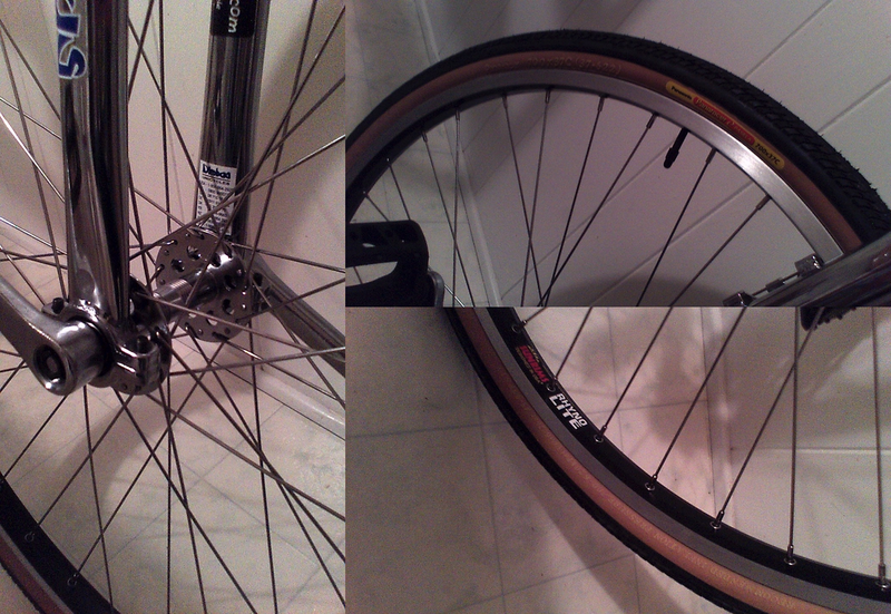

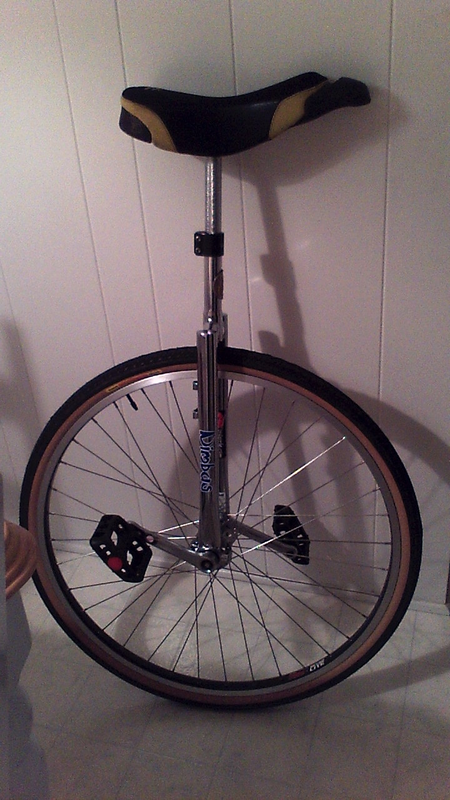

Here are some pictures of my new 700c road uni. I’ve been happy with the 26" x 1.75" Panaracer Paselas on my commuter bicycle and had wondered how it would be to use one on a unicycle. I went with a 37mm 700c Pasela tire and a Rhyno Lite rim for the uni. A while back, out of boredom and curiosity mostly, I had bought a “Schwinn Unicycle 36 Hole Square Taper” hub off eBay, so I used that. It has a classic look and seems good enough for light-duty use, the main unexpected drawback being that it uses non-standard bearings with 5/8" inner diameter. VXB sells them, though that added an extra shipping charge hit that I hadn’t planned on.
Laced cross-three, the spoke length worked out to a 292 mm, which is conveniently 11 1/2", a factory-supplied size so no custom threading or special order was needed. That was basically an accident this time but I will be trying to do it on purpose in the future.
The frame and saddle are from my 26" muni. I bought a Qu-Ax 29’er frame and saddle for this one, but then decided purely on aesthetics that I liked them better with my muni wheel so I swapped.
I didn’t have a lot of time for riding over the weekend but I did take it up and down my street a few times on Saturday and it felt comfortable right away. The Pasela has a compliant casing that seems to put a lot of rubber on the road per millimeter of width. I had it around 55 psi, and it felt nimble but stable enough. It rolled well over bumps and cracks and I could turn it when I needed to without nearly as much effort as the Hookworm on my muni takes. I was doing U-turns in much less than the width of the road right away, and I didn’t notice much trouble from road crown pulling it one way or another.
More later when I’ve had more time on it, but so far I’m pretty pleased with how it came out.
Looks nice. What size cranks are you using?
Thanks! Those are 140 mm. Basically guessed there but so far they feel good around my hilly neighborhood. I’m also going to try 125 mm at some point.
I really like the look of it, that schwinn hub might not be great but it has cool holes in it…
