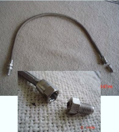

Hey Roger, at Amy’s request, I sent her a pic of my broken magura hs-33 brake hose fitting. here’s the pic. It seems to have been a rare, unusual defect/breakage, and I’m hoping you can replace this for me. Or maybe all I need is a replacement fitting, but the broken part is sheard off where it goes into the hose.
I believe tha a small part of the hose, containing the rest of the broken fitting, can be snipped off, then a new 2-part fitting connected with a hose crimping pliers? Please advise, thanks! Here’s the pic. It is the cross-over hose only that’s damaged; the main hose from the brake lever down is fine.
and how is that relevent to this conversation?
