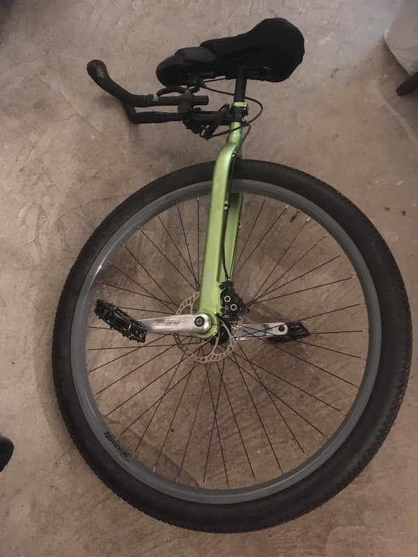

If I do this, I then anticipate I’d want to bring 3 unis - a 29er for distance races, my 27.5 muni for muni and a basic 24” uni for track events.
Now, I suspect lugging three unicycles on international flights would be very annoying.
Any suggestions on how to do this well? My 27.5 muni has an internal hub mounted disc but the 29er doesn’t, so that’s a bit of a hurdle if I was to try to bring 1 less frame. I imagine I can get away possibly with 1 or 2 saddles and seat posts though

You could disassemble all three, then strip down the 29 and 27.5 wheels to just the rims, hubs and spokes and then nest them around the 24" wheel. Done like that, all three would take up no more room than your 29er.
You’d have a couple hours of reassembly time afterward and you’d want to brush up on wheel lacing and tensioning too, but I’d wager there will be plenty of people at Unicon that would help you out.

But 3 unicycles >29" would fit reasonably well in a bike bag if you pack well - of course it’s not going to be a whole lot of fun to carry that bag, but you’ll only have to do that a very limited amount of time, I’d personally not stress about that too much. Will cost you extra for the extra luggage, but it’s hard to avoid that..
Thanks for all the responses. I now think I may be able to just bring the 27.5 as a result and borrow others which will be much easier. :slight_smile:
