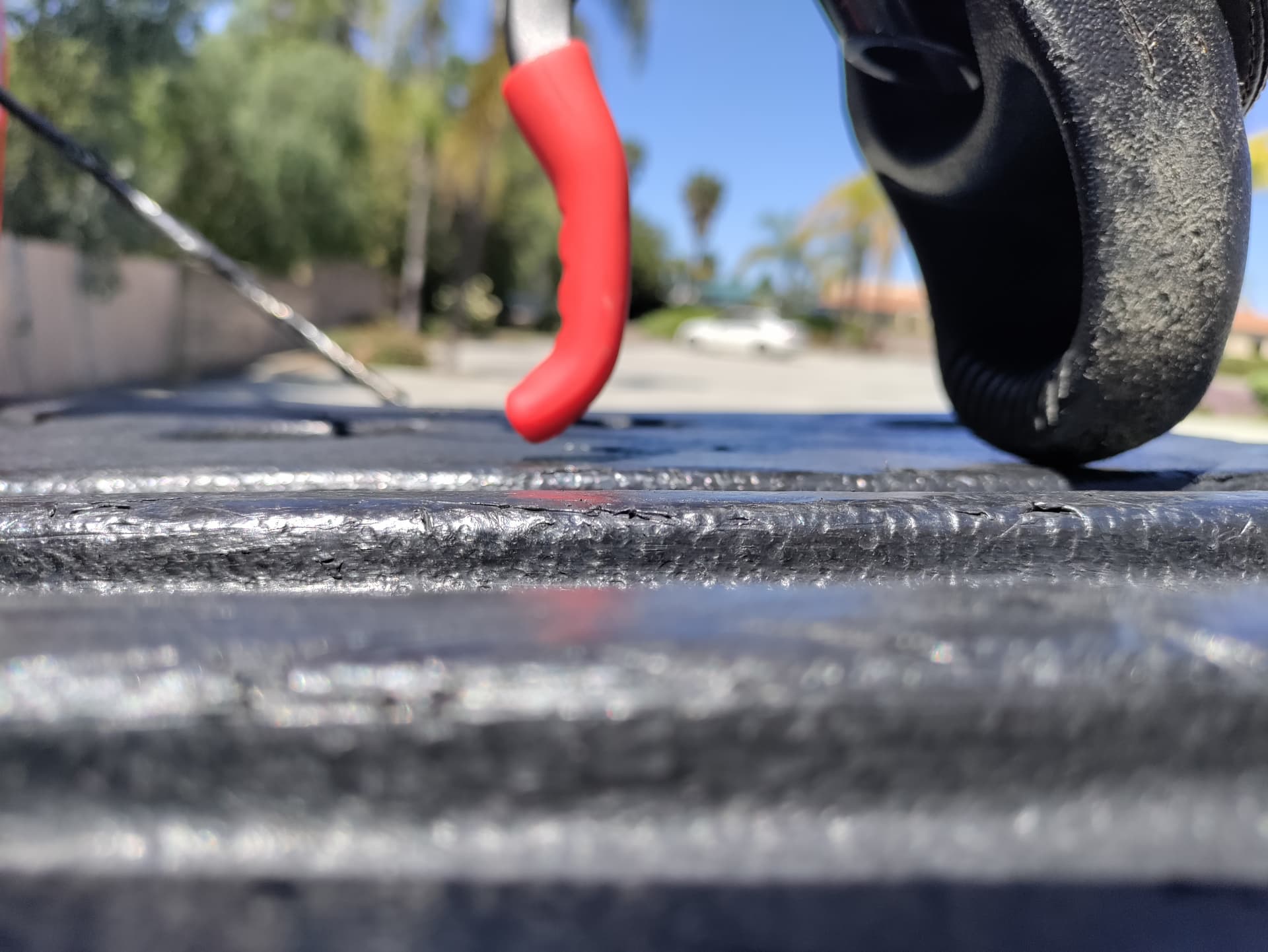

I have had the braking power decrease several times after UPD and the front bumper impacts the ground fairly hard. I have the brake lever recessed enough so that when a front bumper strike occurs the lever is not affected as shown below.
When an impact occurs the braking force decreases, instead of engaging after a ¼inch of lever distance it’s takes ¾inch and the braking affect is less. Some times to a point where I can’t hard lock the brake and stop the rotor completely. I need to take out my Allen wrenches and adjust the brake lever via set screw inwards so the brakes engage where I expect them to.
