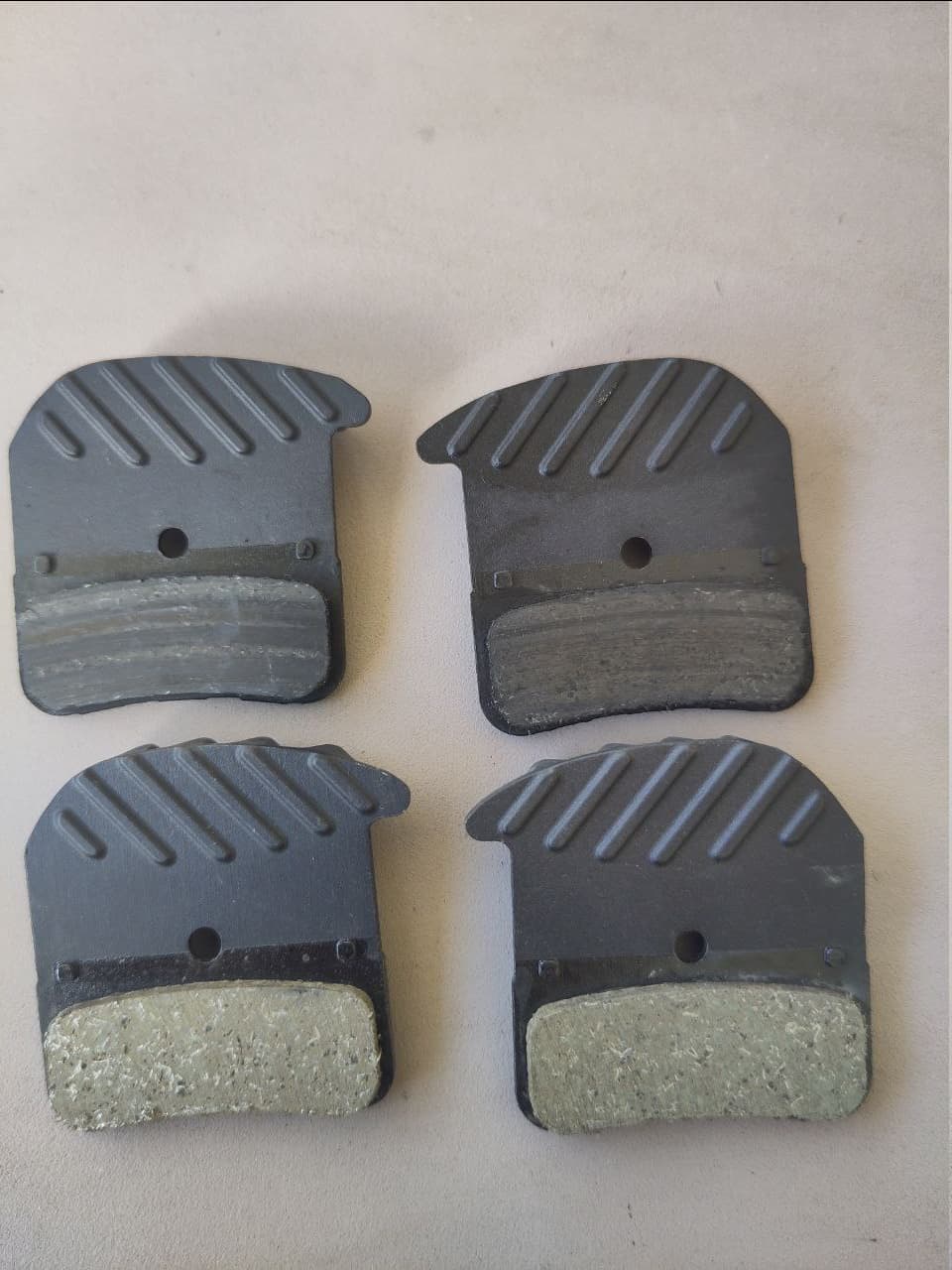

Just a picture of my probably-contaminated pads next to brand new pads:
The upper ones look like sinter metal pads and the lower ones like organic. Or am I wrong?
You are wrong. Both are organic. I also have a pair of metal pads if you want me to take a picture for comparison.
So the color change is from the oil contamination? :hushed_face: wow
I think so, yes. Yesterday, I have cleaned my rotor with some Muc-Off disc cleaner. The towels I used turned black, too. I guess lots of Schlumpf grease has leaked from the hub and contaminated the rotor and pads.
