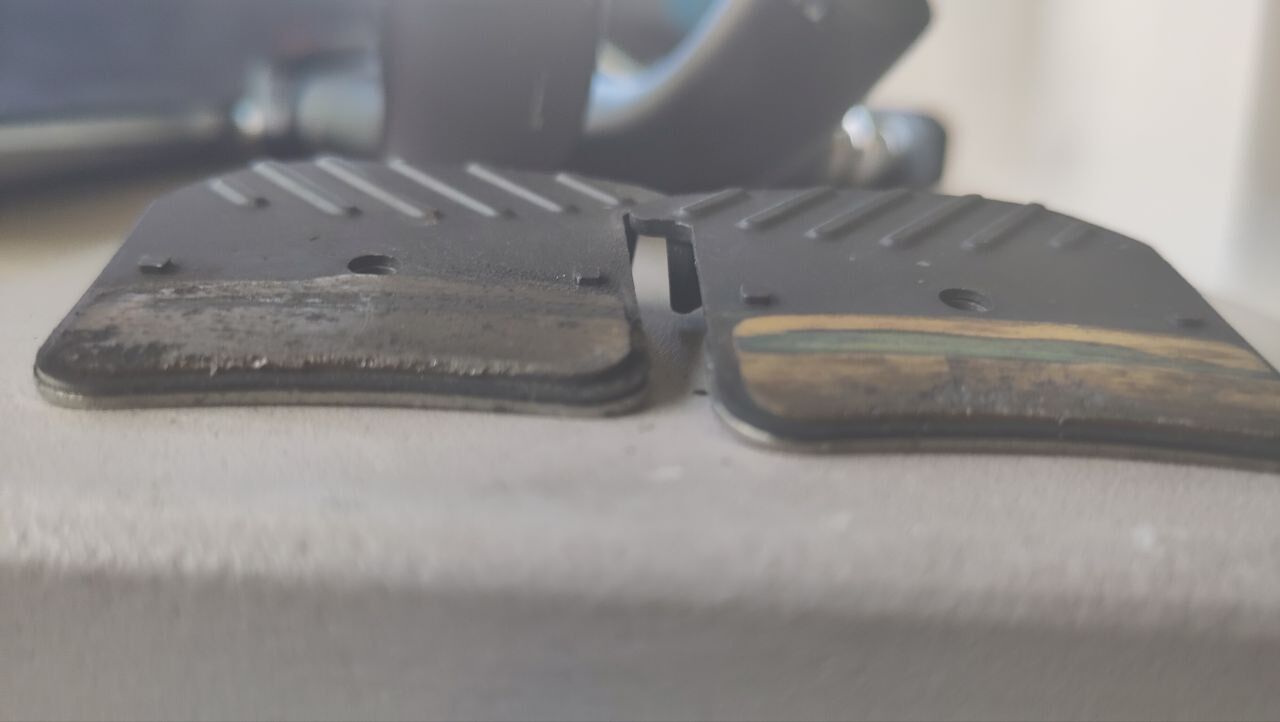

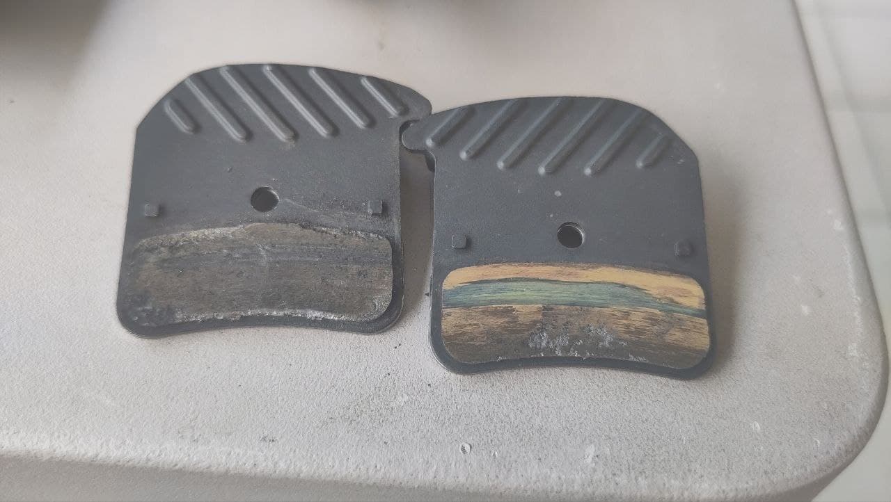

Just a few pictures of my metal pads after a few hundreds of km on Schlumpf’s first rotor model. Don’t they look nice? :grin:
I finally took some time to replace them with organic pads (on the rotor @aws kindly sent to me). I hope the brake power will come back! I’ll give them a try today during one of my daily trainings :grin:
Did you wear through those pads entirely?
I would say there is still a bit of material. But one of them seems to be glazed (is that the right word?).
I think I’ve rode a bit less than 500 km on these… So, not much for them to be so worn out.

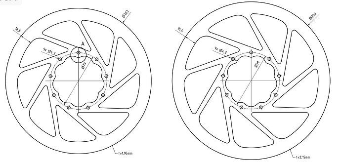

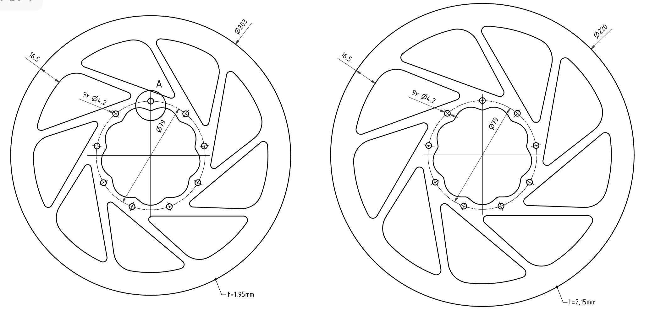

I’ve had to politely chase BrakeStuff twice on this and the first time I was assured designs would be over to me in a matter of days. More recently I was asked again what size I’d like to try first. I stated 203 as that’s probably the most useful asymmetrical one if we have to one at a time.
I’ve not heard back since. I don’t want to become a pest or annoying so I’ll leave it for a bit. But I am wondering if I need to message again….
Update on these rotors.
As the option to get more rotors made in this testing phase wasn’t really possible - the idea of my ordering them for my own entertainment (while very tempting) wasn’t a logical step and my skill in geared riding let alone braking is minimal at best.
So I’ve gone with the option to have @Maxence and @toutestbon test out the 220 and 203 rotors respectively.
This to me feels logical as everyone will then know how much of an improvement these asymmetrical rotors and sizes make for geared wheels - principally on G36ers.
The unicycling geek in me is a tad crestfallen that I won’t get to see one of these new beauties in the metal - but I think they’ll end up working very well and perhaps after testing with maybe a few tweaks to design, we’ll all be able to place direct and official retail product orders from BrakeStuff.
Prices should be in the 75-85€ region I think.
Mid-stage design photo to give an idea. These will have a Shimano style hole punch design on the rotor braking surface edge.
