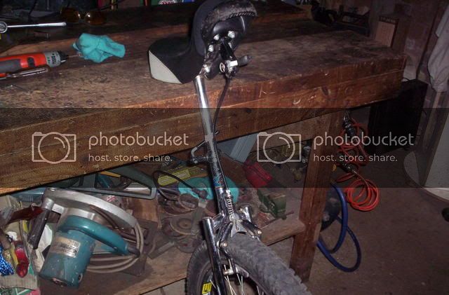

after doing a 2km downhill on the road to get to my offroad trails I decided I would like to try some brakes.Being a stubborn scrooge with scottish ancestry I scrounged around my collection of discarded bike bits and came up with this.I generally use my brakes as a drag down hills it is controlled by an old racer gear changer so it has a friction lever ,you just set it to match the hill and cruise down the hill like it is flat.Only very occasionally do I use it while muniing.
The details of this are:-
Magura mounts cost £20 / $40.
Mine cost me £3/6$ to get them brazed on by the local welding shop. What you need to do to get it cheap is prepare it a bit, then it’s only a 5 minute job for the welder (bike shops will sometimes do magura mounts, but typically for more like another £20):
1)Work out where the mounts need to go on the frame.
2)Sand off the top layer of chrome from where the tabs on the brake mounts touch the frame.
3)Clamp the mounts onto the frame using hose clamps (I needed a small block of wood and a hose clamp for the size clamps I had hanging around). The hose clamps cost 50p each from a hardware shop.
4)Make sure it’s all in the right place. Having a bolt in the mount helps here as you can see how straight it is. The specifications for where it has to be compared to the rim are on magura.com
5)Make really really sure it’s all in the right place
6)Take it to the welding shop, say any chance you can weld the tabs on these mounts on, and how much.
You can alternatively get v-brake mounts put on, cost something like £10-£20 2 of our local bike shops can do it, so I guess it’s just a matter of asking round your local bike shops until you find one that can.
