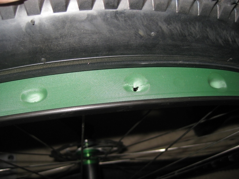

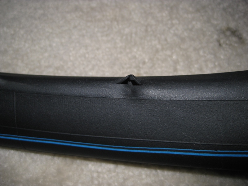

Last week I left my unicycle in the car while at work. When I returned and pulled it out, the tire was flat and there was a hole in the rim strip through one of the holes in the rim.
I didn’t find anything sharp in the car that could have punctured the rim strip and tube, so I think that it may have just gotten too hot, the pressure built up, and it popped.
Can the rim strip be patched, or do I need to replace the whole thing? I’ve attached some pictures of the damage if that helps.
Thanks.
I wouldn’t try to patch the rim strip specifically, but you could put Velox cloth tape or nylon strapping tape over that rim hole.

This exact thing happened to me this summer several times, after leaving my KH20FL in the car. I took off the rim strip and found a stray peice of thin metal near the border of the drilled hole in the rim. I took a plyers and cut it off, then everything was fine.
The heat of the car must have been causing the tube to expand enough to get cut by that piece of metal. Take the rim strip off and line up the innertube with the rim. You may find a similar defect.
