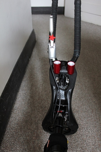

Ok, I do see how your bar could bend the rails with that description. The stainless bolt head visible in this pic goes through a drilled hole in the lift handle and into a steel threaded barrel welded at an angle into the Black Cock shaft. This solidly connects the black cock with the saddle stiffener and creates a much stronger handlebar than one that is left un-bolted. The bolt head is countersunk into the lift handle so it won’t snag on anything. The layout for this connection took me a while to figure out, but it works great.
With the red and white color scheme, that one looks more like a doggy dong to me. :roll_eyes:
As intrigued as I am by your design, I’m going to stick with the T-bar for now. I like having two handles offset from center, to make it easier to grasp them from the side. Your design would have to be at least 10-12" longer for me to reach past my own personal attributes to use it. ;):smiley:
(Hmm, sorry if I’m coming across as a bastard, I realize I’m not qualified given that I’m nowhere near Portland. :slight_smile: )
Hmm, that doesn’t do anything to reinforce the rails though… only the handle. Am I right? Is the plastic handle the extra link between shaft and plate? I don’t have much faith in that plastic.
In my design I wanted to be able to use the lift handle. I don’t see that possibility in your design.

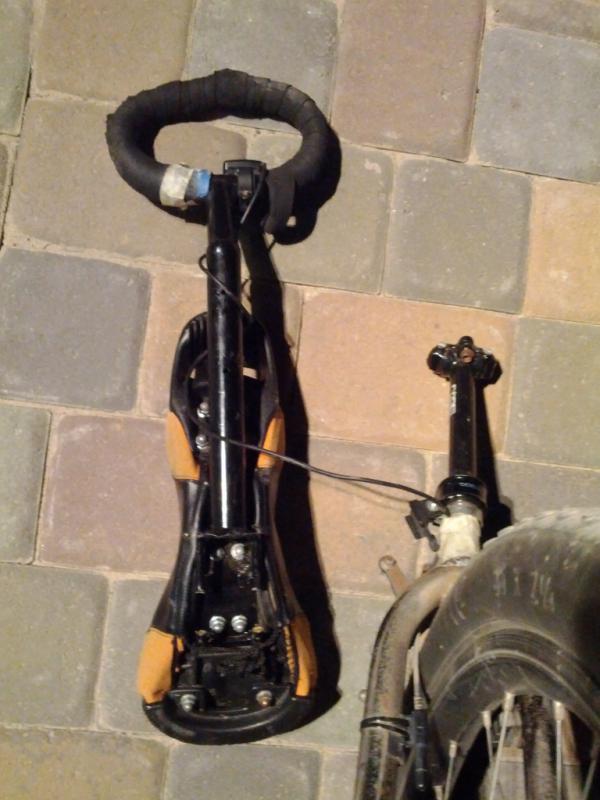

Here’s what’s left of my design. I really liked it… it was made from some drop-handles from an old 10-speed. It offered a number of hand positions, worked well with a computer and a brake, and lasted for quite some time. I might try building a second version once I get my man-cave sorted…
Whoooah, I think I’ve punished my black cock pretty hard over the years with UPDs and drops, but it still looks pretty good and all its parts are straight and intact. . .OOh man, that looks like it saw some hard living! Ouch!

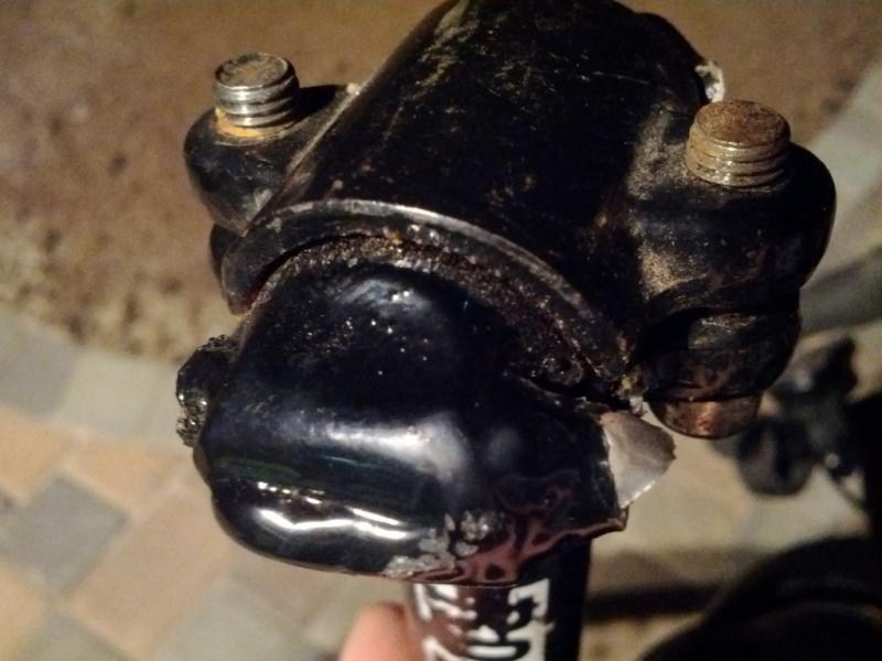

One possible difference is that I run mine with Thomson seatposts which have a really big/wide grip on the rails and help to better spread the load on the rails.

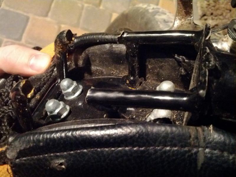

I’ve done a couple hundred km of Coker muni and a ~500km tour of Vietnam with that rig, in addition to lots and lots of smooth rolling on pavement. Overall, I’m happy with how long my handle’s lasted, but disappointed that I have to take it out to the field and shoot it…
Yeah, this post only grips the rails in two places… the interior of the clamp is hollow. I’m no materials engineer so I can’t tell if it would be better to grip more of the rail… but in either case the rails have to bear the entire load of every drop and fall.

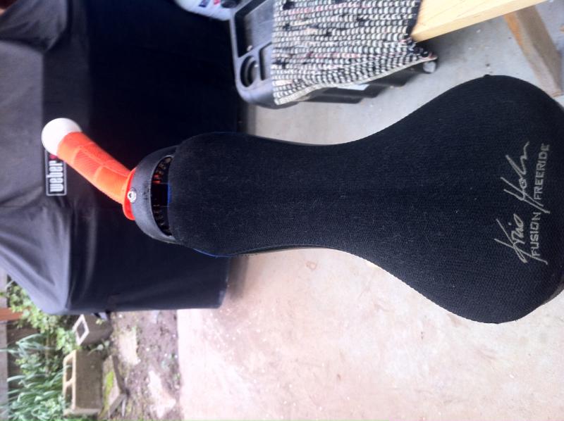

Tis done
I left the grip off so the brake lever can be slid down into position. . .then the grip goes on.
