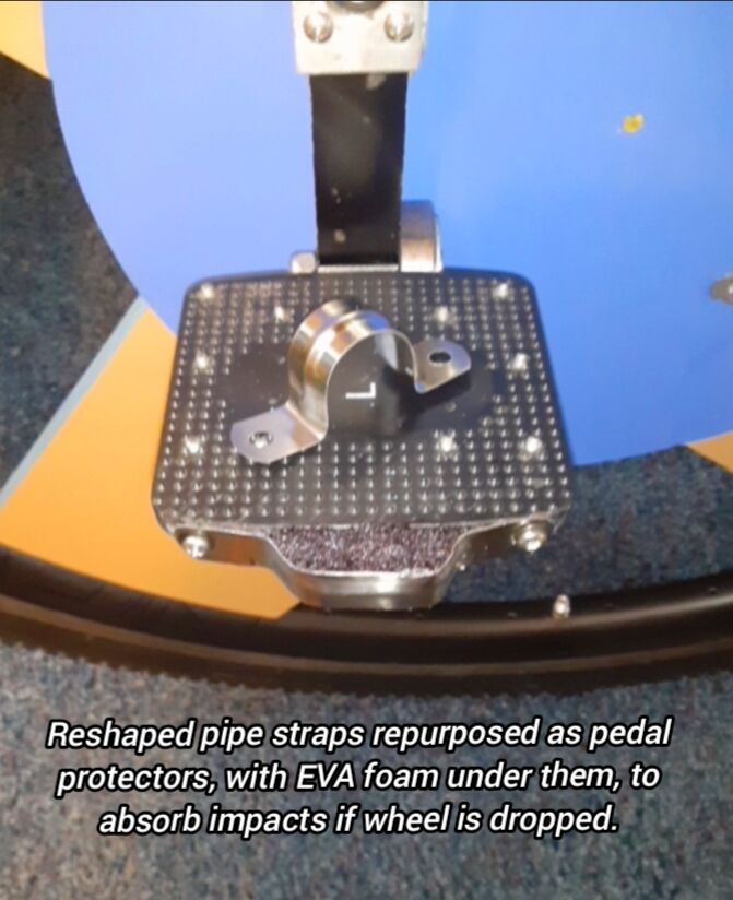

3/4 inch pine is solid, and should not present any issues. Last build used only 1/2" thick plywood and it lasted for years. I did modify and reinforce the Lunicycle leg shield/foot plates that I had. I replaced the cheap plastic vertical section with 1/8 inch thick aluminum flat, and also replaced the restrictive cup at the top with a much wider, straight pad. It works great! Also made pedal protectors to absorb impact in case wheel is dropped.
