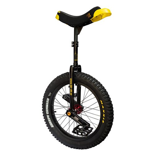

When I bought my trials, I got this 19" QUAX
I’ve had a lot of fun with it. It is great for hopping. Also had a few 10K rides with it. I don’t experience with the other trials unis, but as it fits my usage, I don’t need anything else.
