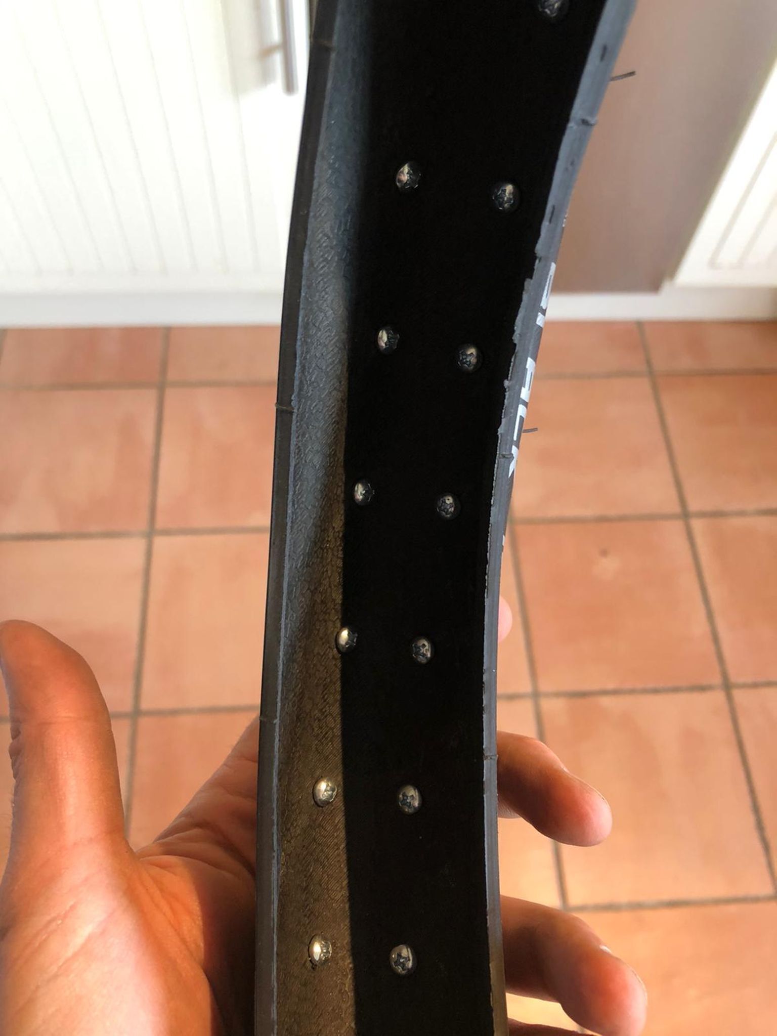

Ok @saskatchewanian 11 years later and I did it. Thanks for the guide. As it happens, this time it was not for a unicycle but I am replying here because you still you inspired me.
Screws through the tyre, shown from the inside:

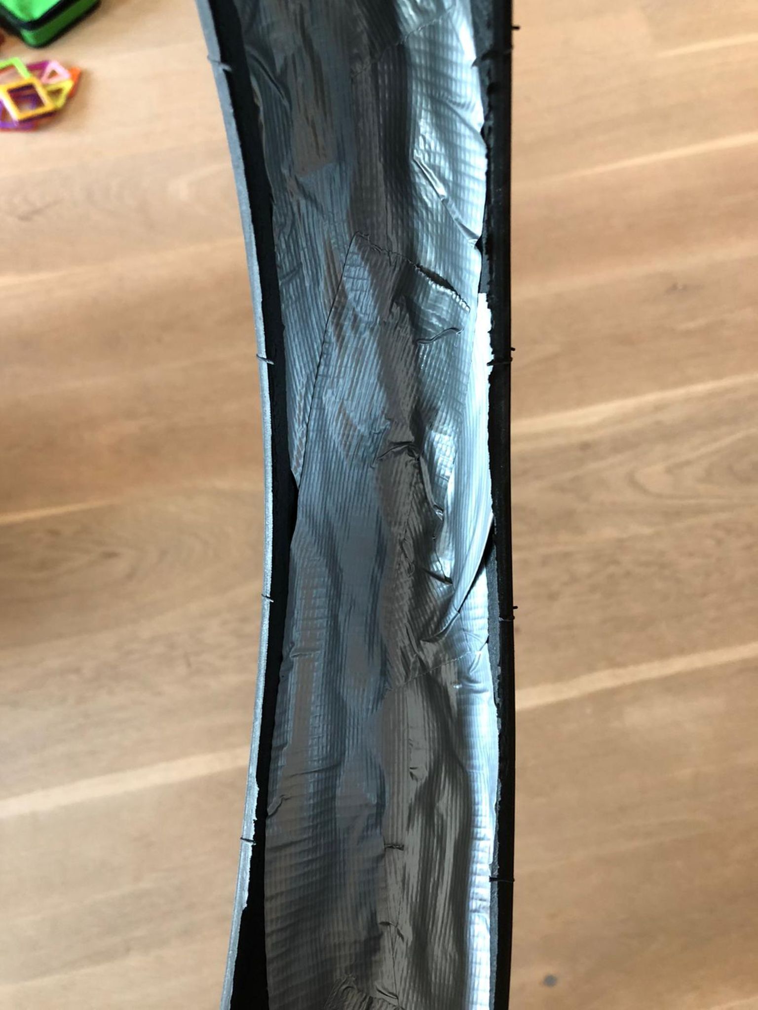

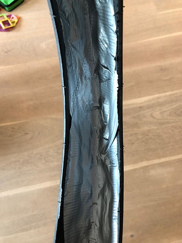

Duct tape fixes everything and in this case provides the first line of defense against pinch flats caused by flexing screw heads:

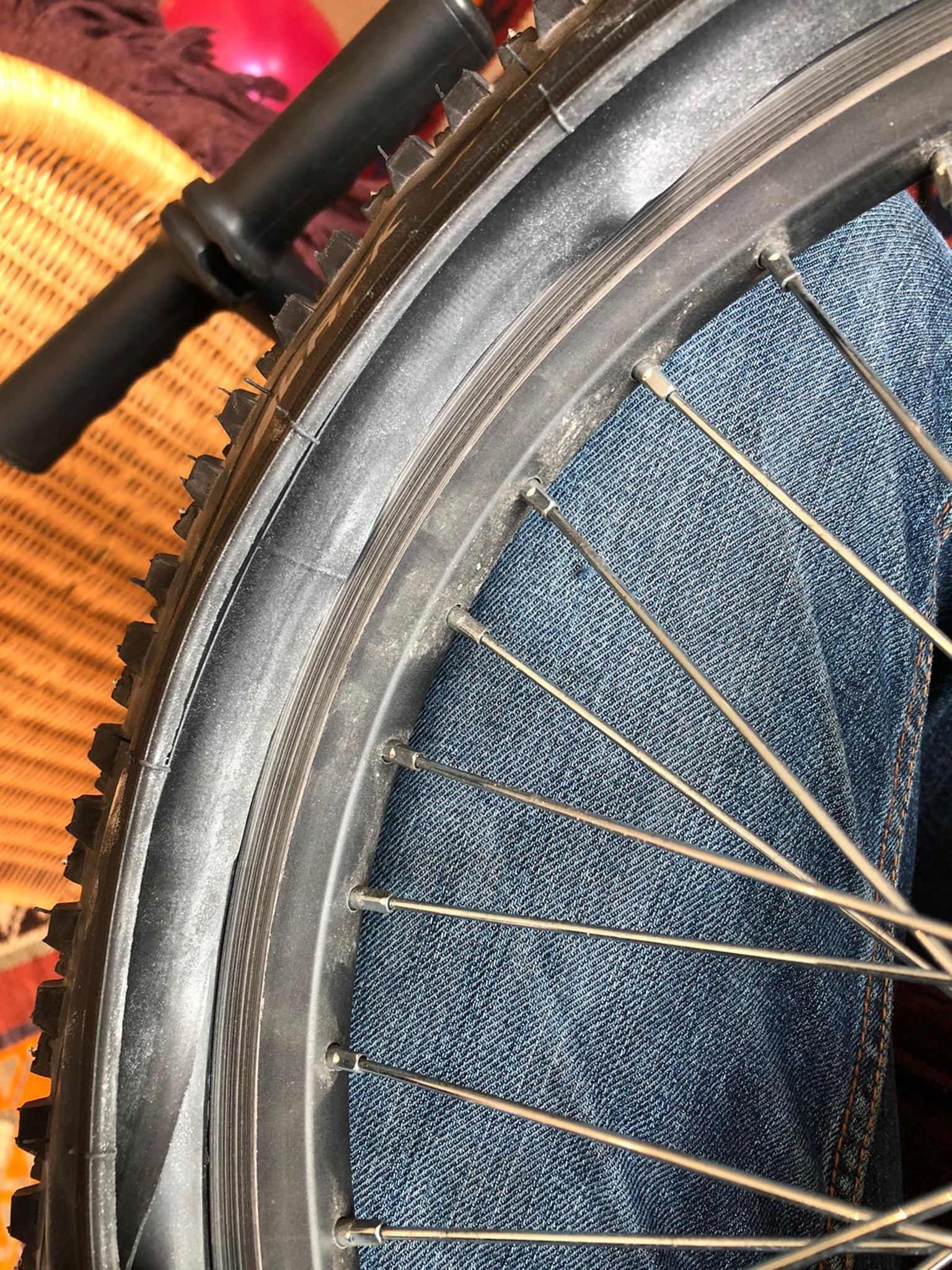

Two inner tubes here. The first is cut open and used as an extra liner for even more protection against the screw heads:

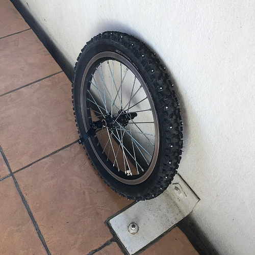

The finished, studded tyre, mounted on the wheel:
