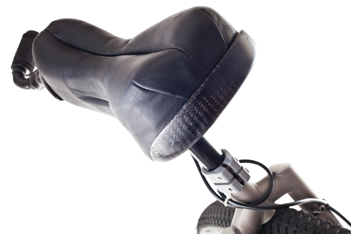

Wallis Road Relief & KH w/Air
The Scott Wallis Road relief is a great design, and loving it on my 36er! Depending on your riding style, aggressive Off Road, Distance, or a combination of the two, this is a REAL nice high end option!
For MUni & 29XC, I use a Nimbus Airsaddle with KH base for the cushy ride. Perineum pressure is a non-issue with air, but I’ve heard too squishy side to side for some, not me.:slight_smile:
