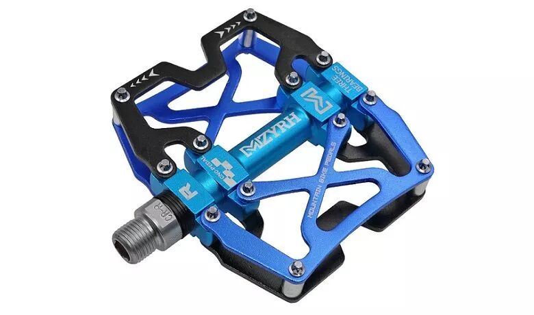

I’m currently using MZYRH’s and they seem to be alright. They’re light, pretty grippy and have held up to abuse so far.
There are various pedals on the market where there are different sizes available (crankbrothers for example). Getting bigger pedals could also allow you to place your feet further outwards without having to use the extenders…
That might be a solution too. I’ve got unusually wide feet, 11/5E, so they tend to overlap both sides of a standard pedal. It doesn’t normally cause a problem, but on a unicycle it means I have a smaller target to aim for when I am mounting and that the edge of my shoe is very close to the crank.
