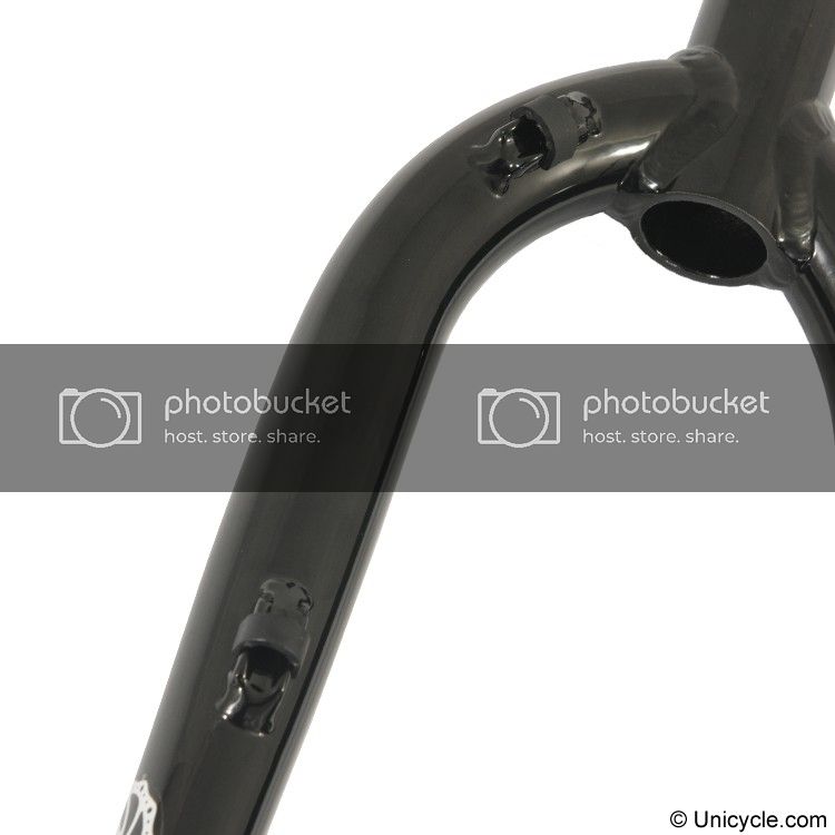

Aren’t these the brake mounts?

Nope those aren’t brake mounts. They are guides for the brake line.

Those are guides for the disc brake’s hydraulic line (which are nice to have).
