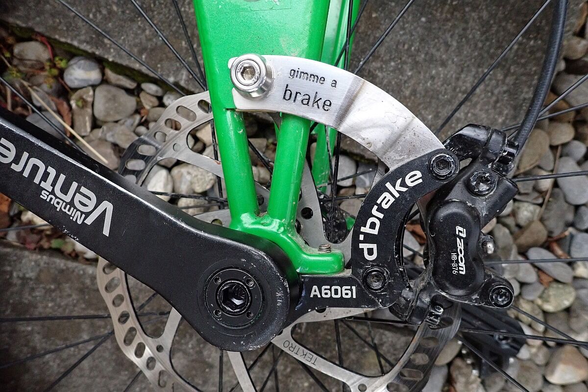

I’ve got a d’brake adapter on my Oregon - because that’s the way UDC implemented a disc brake back then. Now I’m not a hardcore municyclist, so take it with a grain of salt when I say that for me it works well. Like you said there’s the issue with vibrations, but that can be dealt with by adding a “Hugo strut” / “Hugo Strebe”.

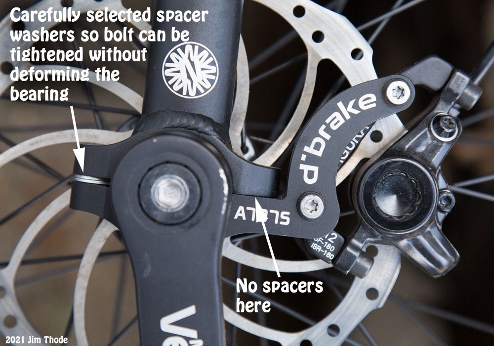

This is how I “beefed up” my adapter. Really simple and works well.
The washers are a good idea, even for normal bearing caps. The brake-induced forces are pulling on the screw you put the washers on. Yet, anything that keeps things from moving helps to fight vibrations, I guess.

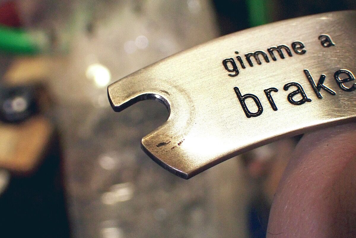

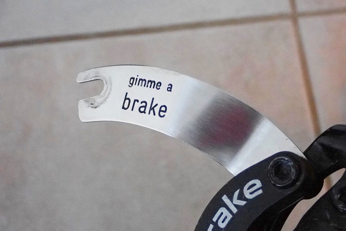

I went the Hugo strut route with my “gimme a brake” :wink: adapter:
My implementation isn’t perfect because it is bent so it attaches to the back of the d’brake adapter (the bent portion is just right of the text). If I were to do it again, I would bend it 1-2mm in the other direction, so it would fit to the front of the adapter. That’s aesthetically less pleasing (at least for me) but the whole thing would be stiffer.
Anyway, for my style of riding it does what it’s supposed to do.

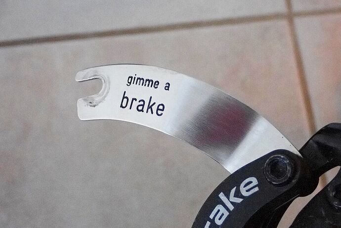

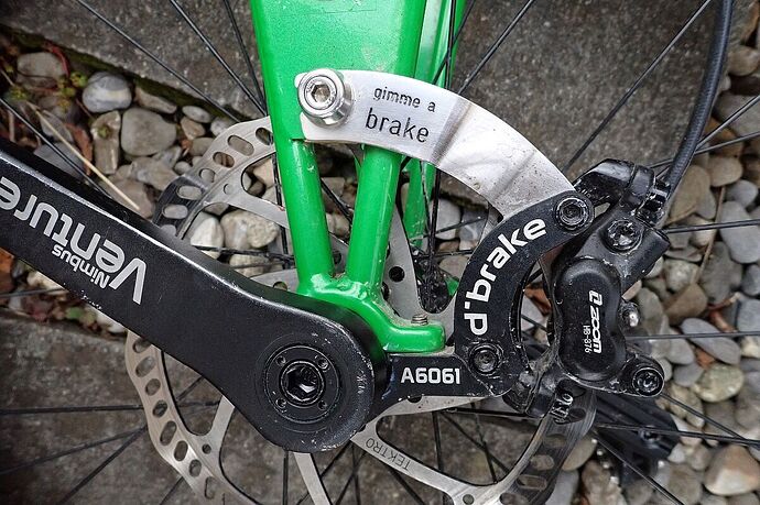

Couldn’t find my pictures of the manufacturing process, but while changing the tire today I took some photos of my adapter:
Front:

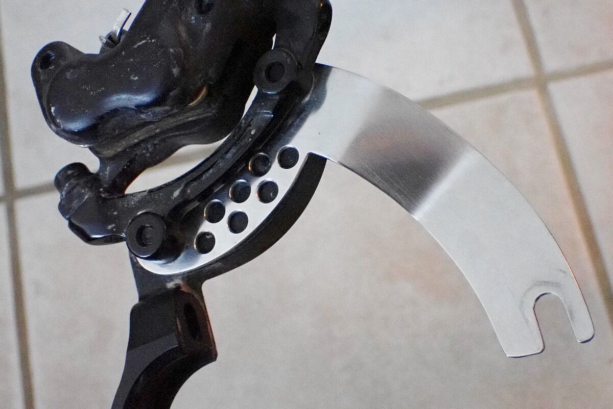

Rear: (planned three triangle shaped cutouts, but the stainless steel was such a pain to machine that I opted for holes instead. The adapter is fixed with both screws of the brake IS-PM adapter so as to keep its position relative to the brake when I remove the whole unit.

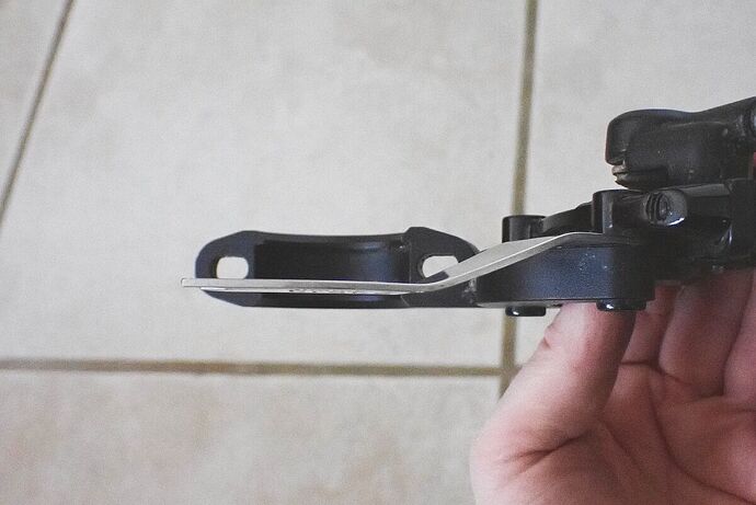

From above: (you can see the bend. Wouldn’t do it like that anymore, if I were to do it again)
The one screw that fixes the Hugo strut to the frame doesn’t have to be fully unscrewed to remove the d’brake, thanks to this being a slit rather than a hole. But the two lips were too long (I knew that from the start, but was too lazy to sand them down - until doday), so that removing the d’brake-brake-gimme a brake-combo was a pain. After adjusting that it works like a breeze.

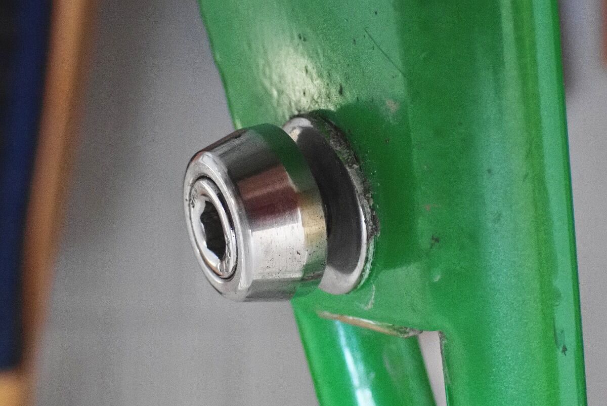

Screw and washers:

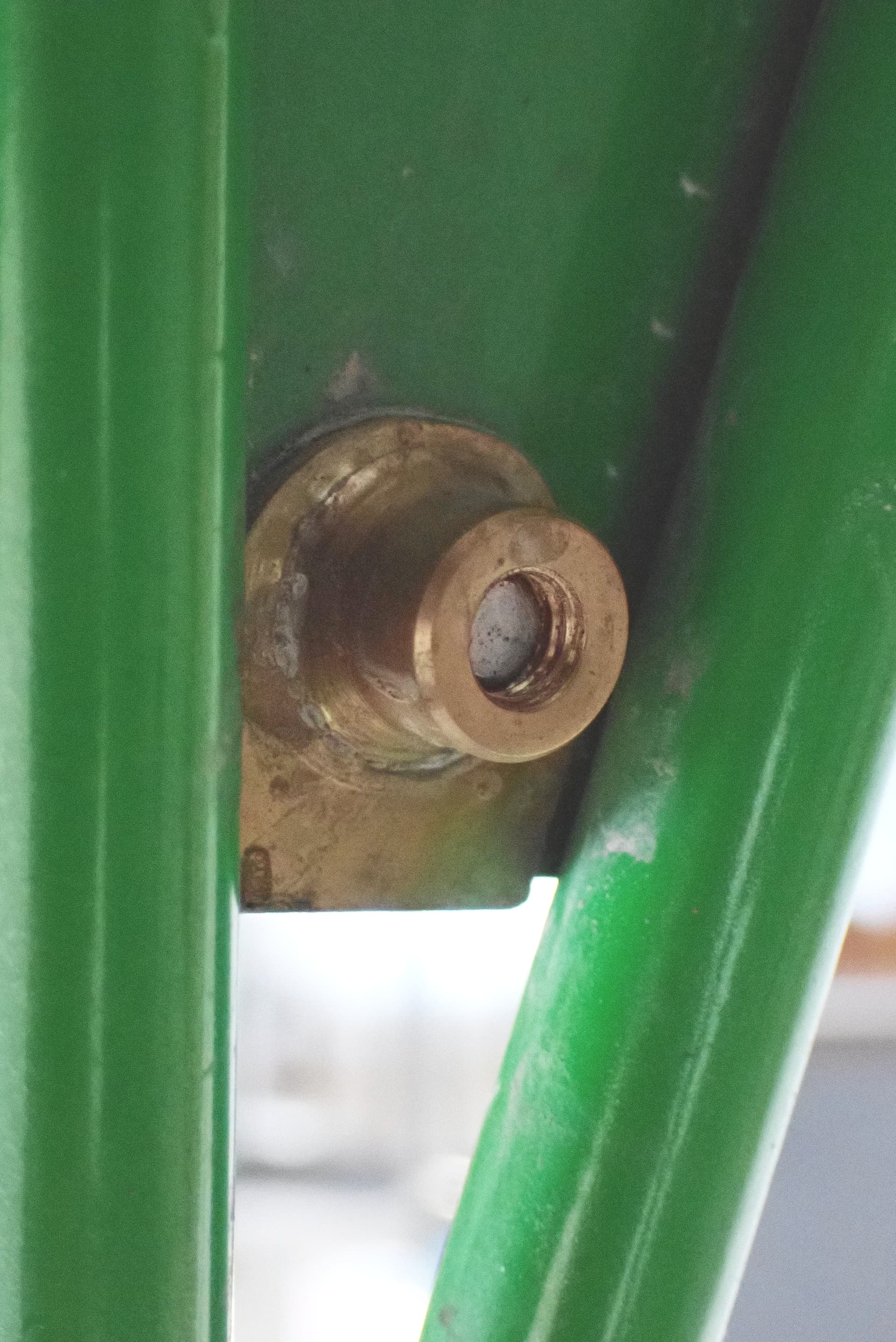

Nut on the rear side: (my first soldered piece, and it holds up well, so far)
you should add “gimme a KitKat” on the other side
