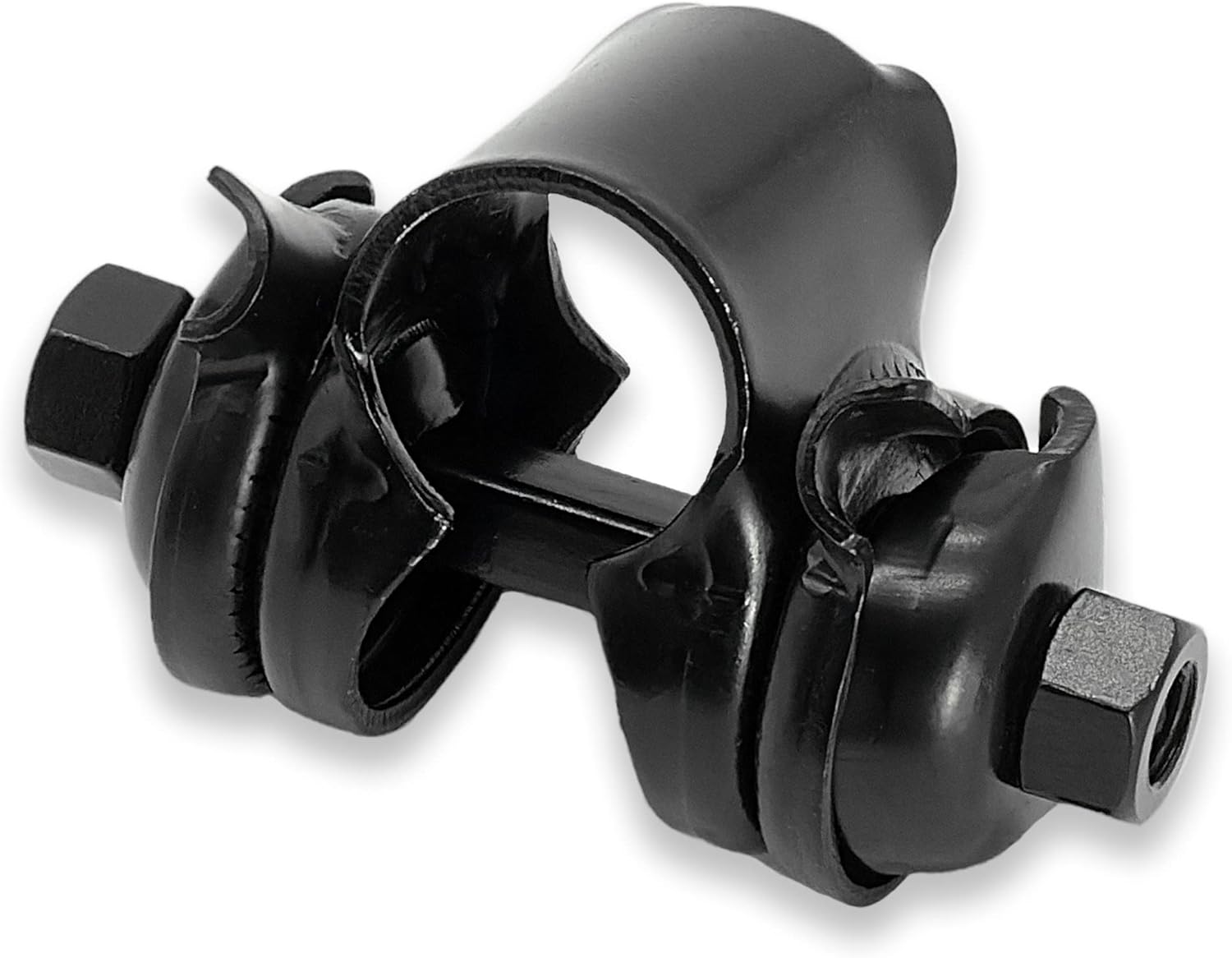

Such a seatpost could be your solution, if the rails are long enough fo fit two seatposts:
https://www.alltricks.de/F-11946-tiges-de-selles/P-298100-trek_sattelstutze_fur_madone___domane___emonda_175mm_offset_20mm_schwarz__2slot
Those things might also work:
But even if the rails are long enough, I doubt that they’re strong enough to not get bend or broken by those extra forces from the handle, especially when you use a very long handle.

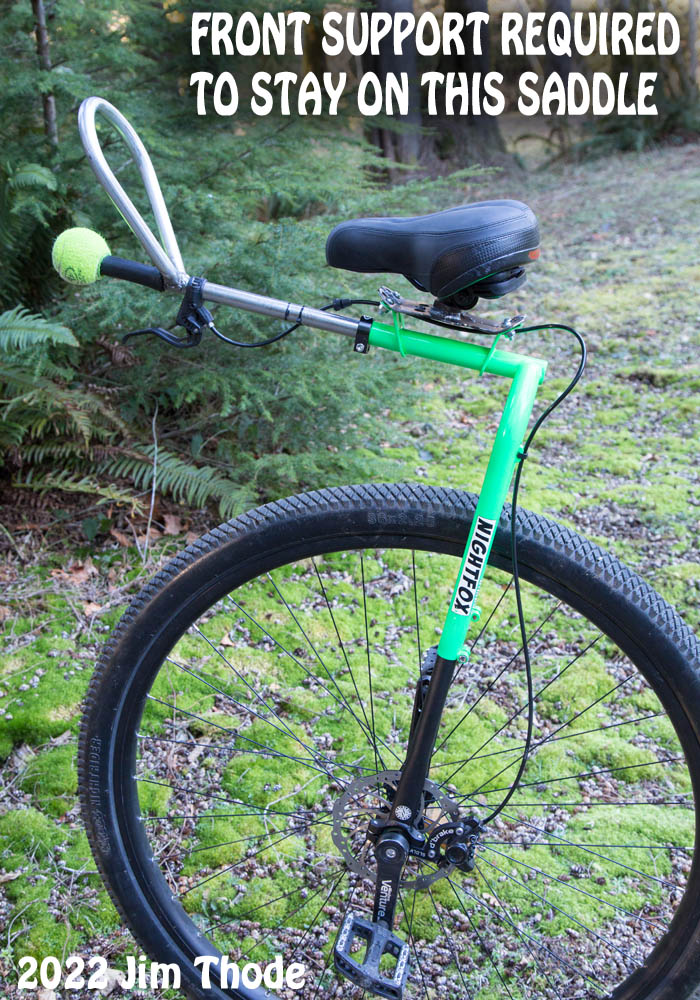

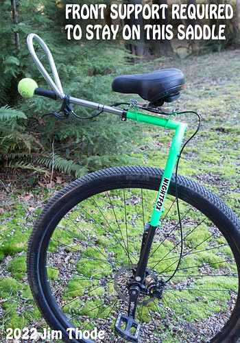

A handlebar is quite easy on a Nightfox. It requires a little fabrication but the attachment to the frame works well. More details on this set up here.

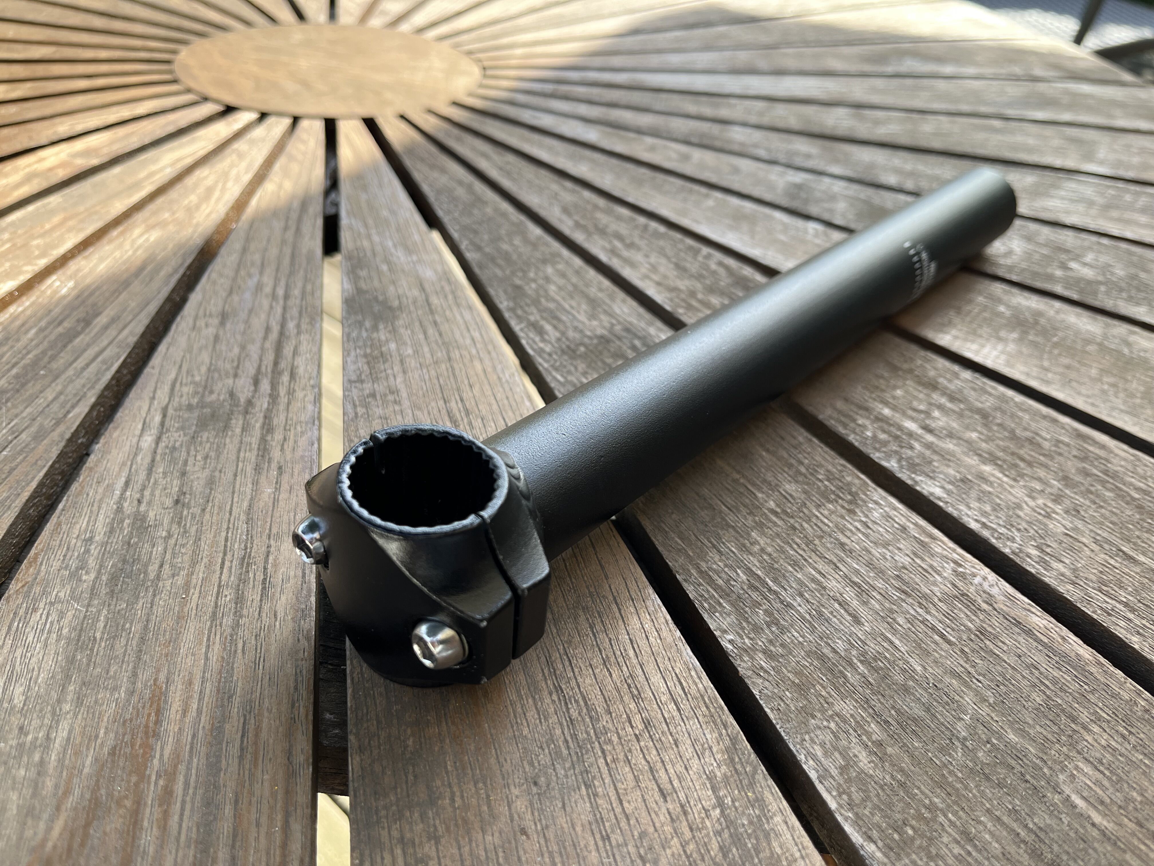

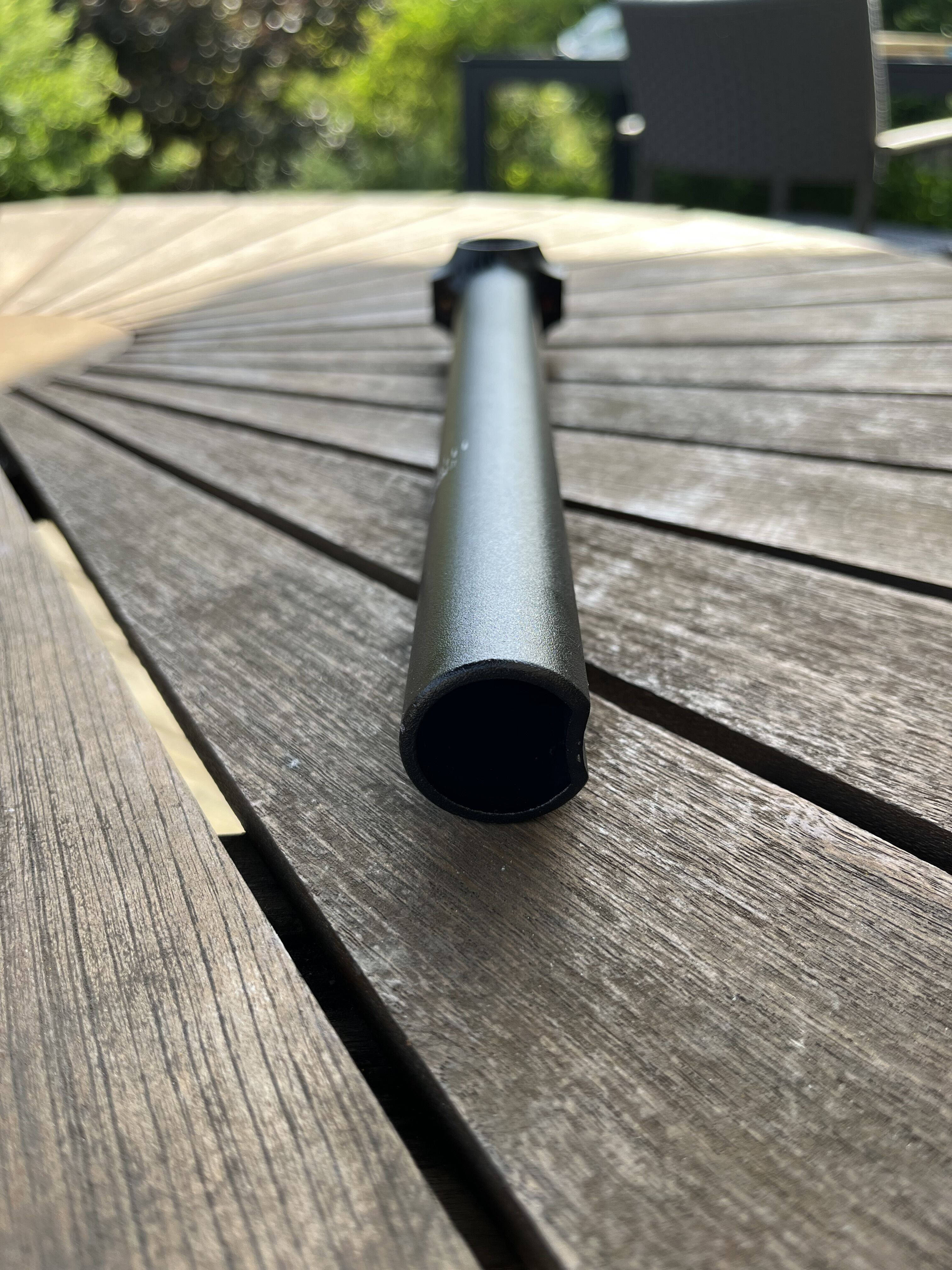

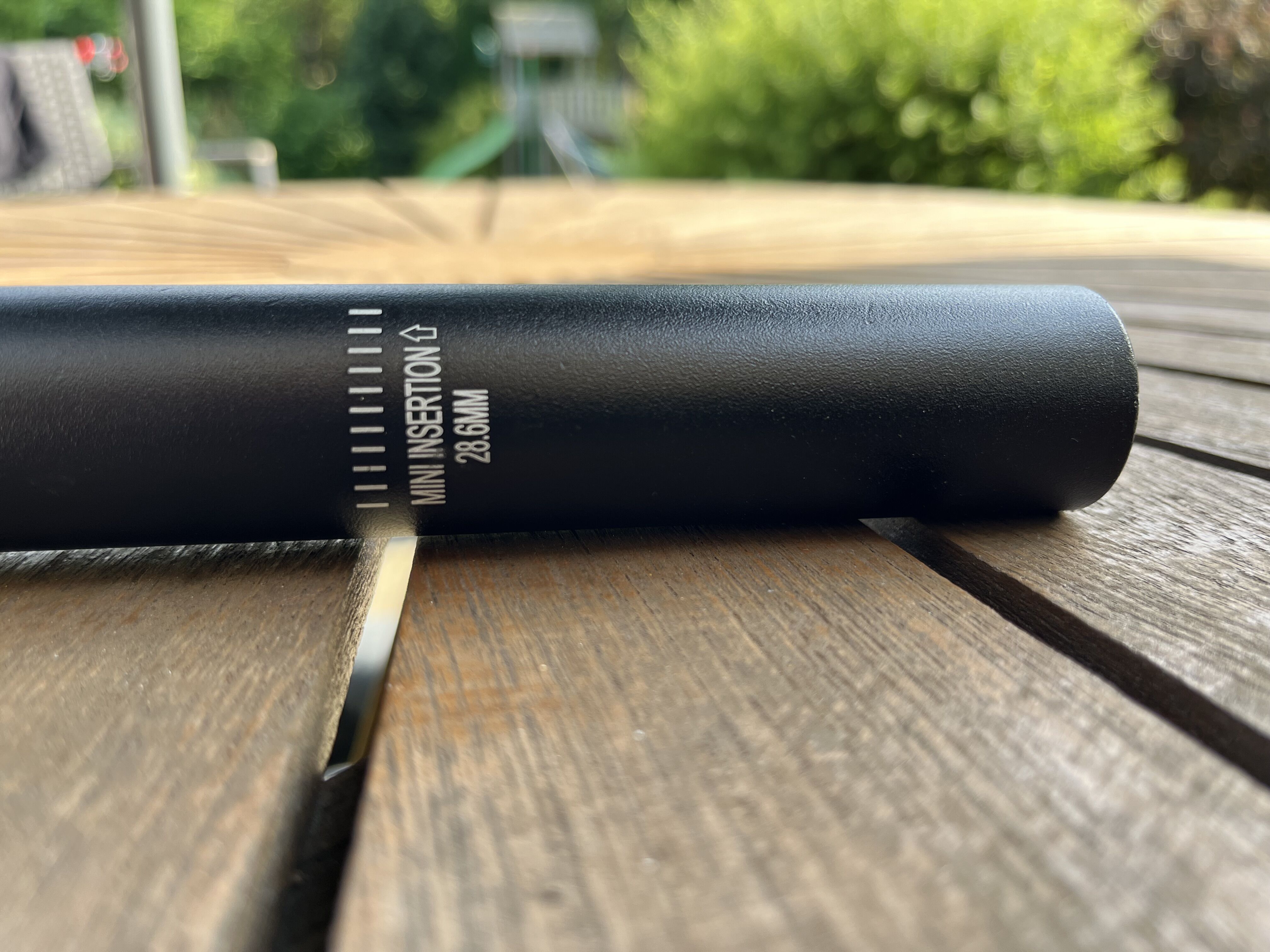

I know I have been sharing my solution in different forms in various threads so here we go again… with some possible suggestions for an even better “adapter”.
This “adapter” which can be sourced on aliexpress (search for “folding bike stem”) clamps a 25,4mm seatpost and has a 28,6mm (1 1/8") tube attached. And as can be seen on the pictures its not round but has an indent on one side.
Optimally it should rather clamp a 27,2mm seatpost using four instead of two screws, be perfectly round and the tube should extend slightly longer.

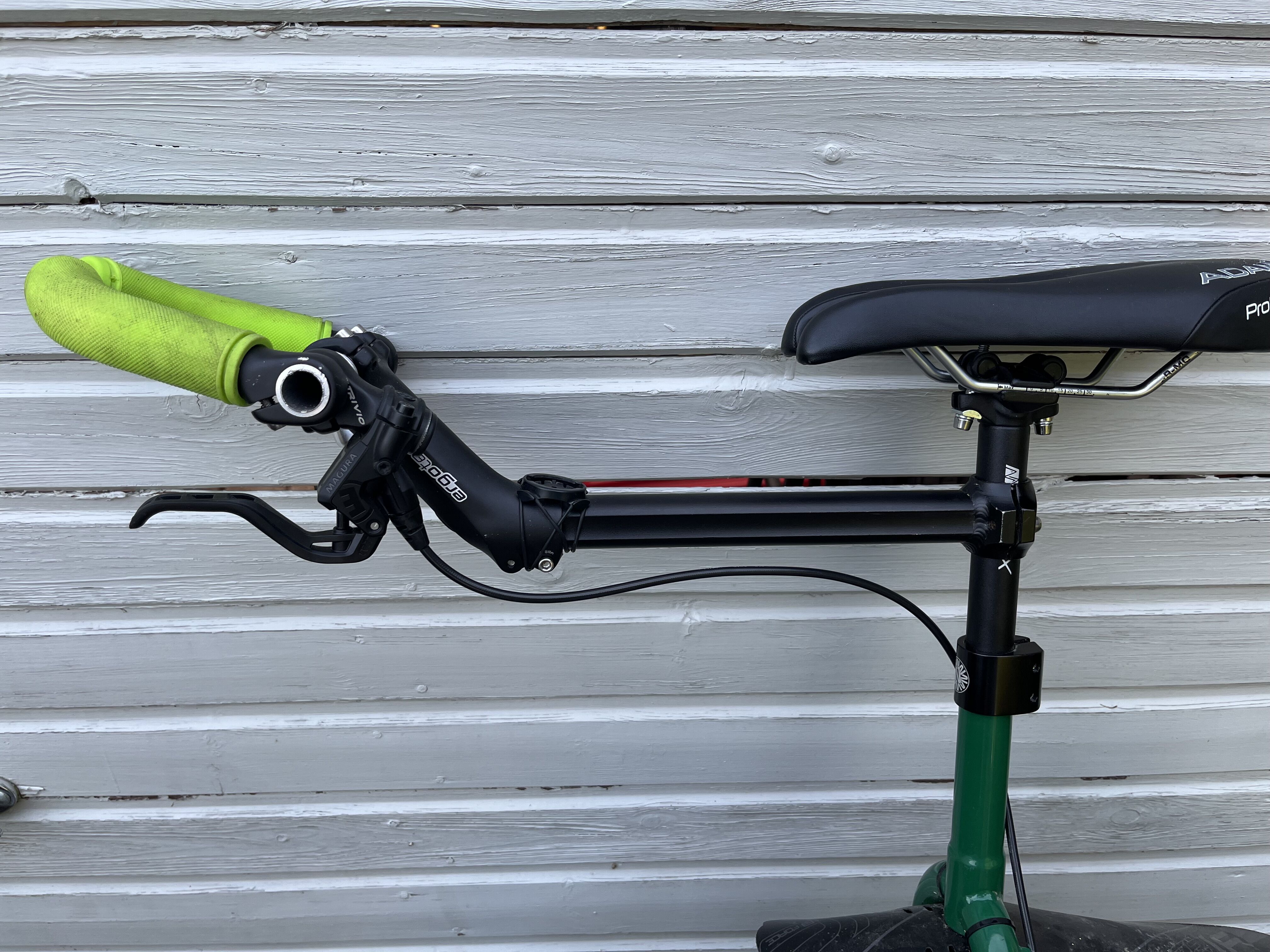

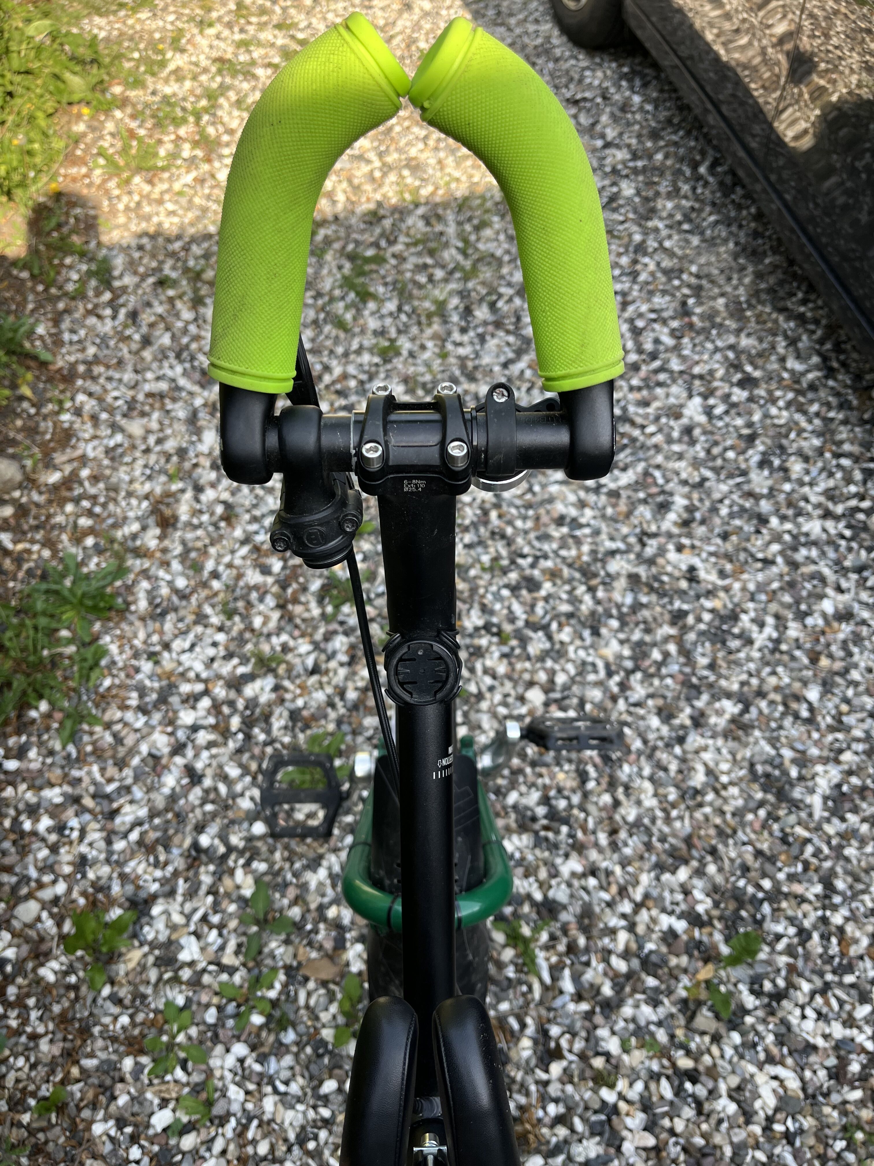

As seen below it mounts a regular bike stem (as it clamps 28,6mm) and then on the handlebar I use a 25,4mm to 22,2mm shim.
Another possible adapter could be designed very similar but with an internal diameter of 22.2mm and then a (seat post) clamp could be used to compress the tube to hold a KH T-bar. This would also make for a clean solution that is easily adjustable in length.

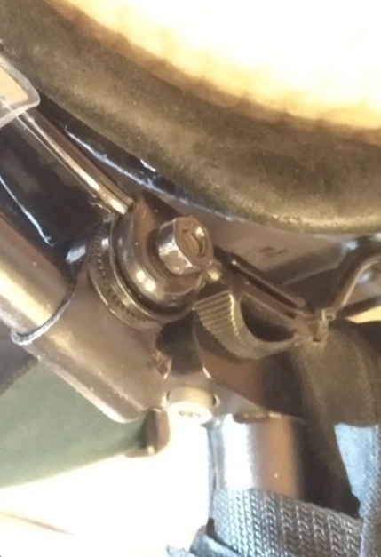

The simplest way to fix a handle bar on bicycle seat.
Only attach second underseat tube to a saddle. This tube will de directed forward.
