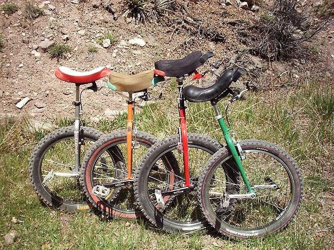

I have done quite a bit of brazing and am self taught I wanted at first to put a set of brakes on a sem xl unicycle and then started building my own unicycle , I have since built six unicycles. I am puting in apicture of four of the unicycles I have built the red one with the magura brakes is mine the others I have built for friends. I start with a mountain bike fork that I have removed the brake mounts and with heat I bend the fork straight then braze on the united bearing holders, then with an oval steel bar and a hammer I pound out more tire clearance also using heat, then I braze the brake mounts back on for a 24" rim. The brazing takes some practice and the metal needs to be clean and you need to use flux, but with a little practice you should do fine, the best would be if you can watch someone else do it to get your flame adjustments corect. good luck, Dan wilson
