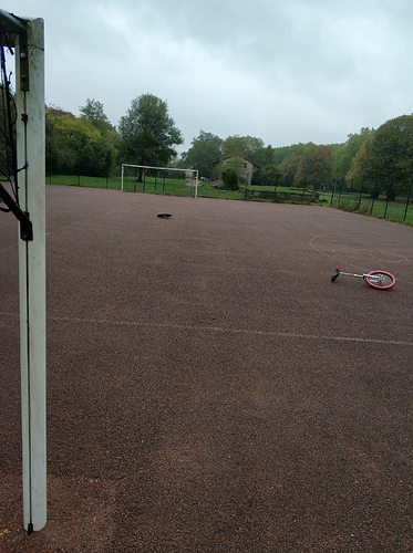

The heat wave is gone, now I am three hours into ultimate wheel training. This is the farthest I got on my UW from the goal post:
I was sooo happy I left the ultimate wheel lying there for 10 minutes as a proof that I got there!
To sum up: training in shorts is a bad idea, jeans at the very least is a must! At the moment I land at least two revolutions with 90+% success rate. It is quite rare to go beyond 4 full revolutions. My legs are tortured, but it is a tremendous fun.
