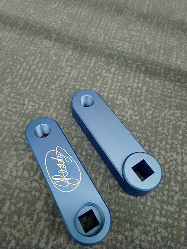

So I made these unicycle cranks at school, their 82mm (I know it’s a weird measurement, don’t ask me why it’s 82 and not 89 or 75 cause I cudnt tell ya) anyways I’ve put them on my spare unicycle thinking that I could use them to learn some freestyle riding and tricks, I’m an intermediate street umicyclist and my normal uni has 114mm cranks in it, I love them and think their perfect for skatepark riding. Perhaps some 110s or 100s wud be fun to try one day at the park but anyways I digress.
My question here is what unicycle tricks either greatly benefit from or require ridiculously short cranks? I know most advanced freestyle riders use short cranks but the only reason I can think of is to avoid pedal scrapes when making sharp turns. I’m keen to experiment with this new setup and learn some tricks that justify its existence.
