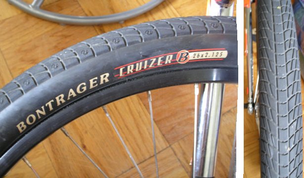

My question is this: who out there has had good experiences with street tires that might be considered unusual for unicyclers. For example—on my 26er, I was not at all happy with several tires I put on it, including the Hookworm and the Big Apple. I was hopelessly wobbeling and veering toward the left side of the road. Then, in a bike store, I came upon a Bontrager Cruizer, and it made a huge difference—I was riding totally straight. It has a great flat profile—and excellent, excellent sidewalls (see picture). An unbelieveable tire.
Now that I ride a 28/29er, I am once again looking for a comparable tire. I currently use a Michelin Transworld City 700 x 47c, which is fine, and rides pretty straight, but it is not as good as the Bontrager Cruizer. Even though the frame on my 28/29er is a Sun, I can see that I do have room for a bigger tire. Unfortunetly the Bontranger Cruizer does not come in a 29 size. But still, the way it behaved does make me think that it’s worth it to try other tires than the ones commonly discussed here.

Nice looking tire, but I’m surprised that you like the square profile on a uni. No accounting for personal preference, I guess.
On a 26" for the road, I love the round profile of the hookworm, and on my 29er I prefer the Big Apple.
I use the Schwalbe Marathon XR on my bicycle - it has the same sort of profile as the Bontrager you have pictured there. I’m using a 42-622 on my bike, but it is also available as a 50-622. I’ve always thought they were a little too “flat” across the tread area for a uni, but you might want to check them out.

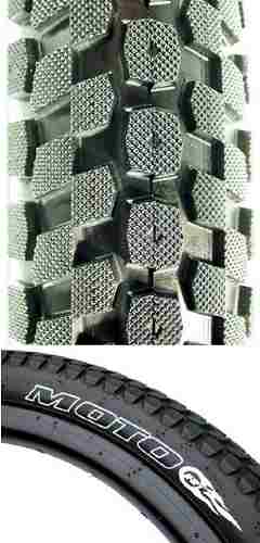

Was in a bike shop and saw DMR MotoRacer RT 24x2.2 for £15.99.
Really thin sidewalls, so thin in fact DMR call it a “skinwall”, but I got the tyre at 70psi and it runs sweet!
Lovely grippy tread, and remains smooth to ride. A lot of street (bike) riders use these tyres I believe.
I’ve not taken this uni off road, but have cut across a field a few times on it. When doing this with the hookworm tyre on, a few pedals into it and it lost all grip and slid around. But with the motoracer on, I just kept going.
I don’t know if anyone else has tried these but I reckon it makes a cracking uni tyre! And they go up to 26x2.5 I think.
