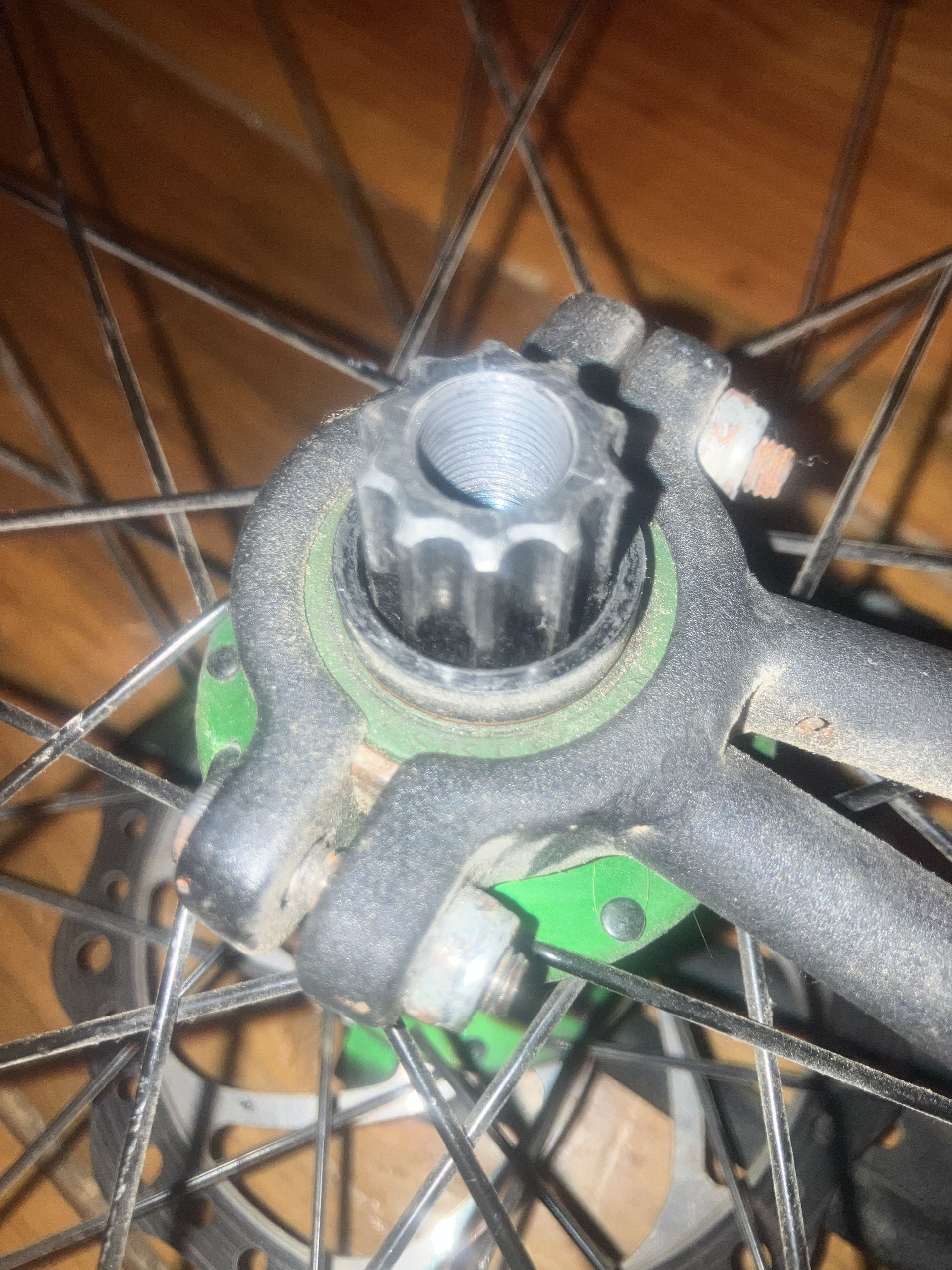

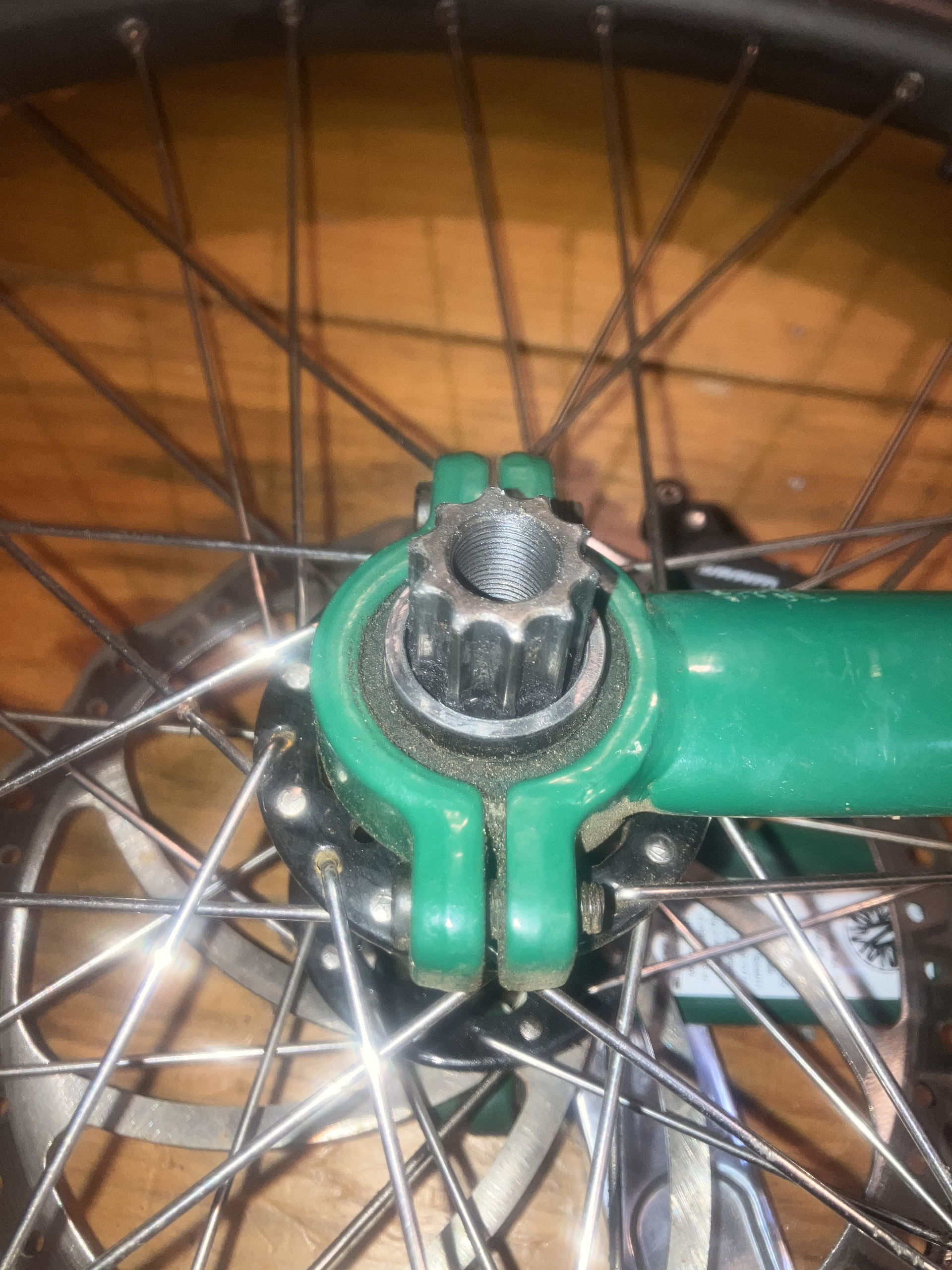

I have a Nimbus 27.5 bought in 2021. I recently bought a V-frame Nimbus 36, age uncertain. I tried to swap the KH Moment cranks from the 36 onto my muni and the splines engaged 2/3 of the way and stopped. Then I tried the (KH spirit) crank from my muni on the 36 and it bottomed out with no tightening. Could there be that much of a discrepancy? I think I need more spacers if I want to try the Moments on my muni, but seems like a big difference in fit.
Sounds like wear on the Spirit cranks. Are the spacers on both unis the same and does the same thing happen when you try to seat the Spirits on the Muni?

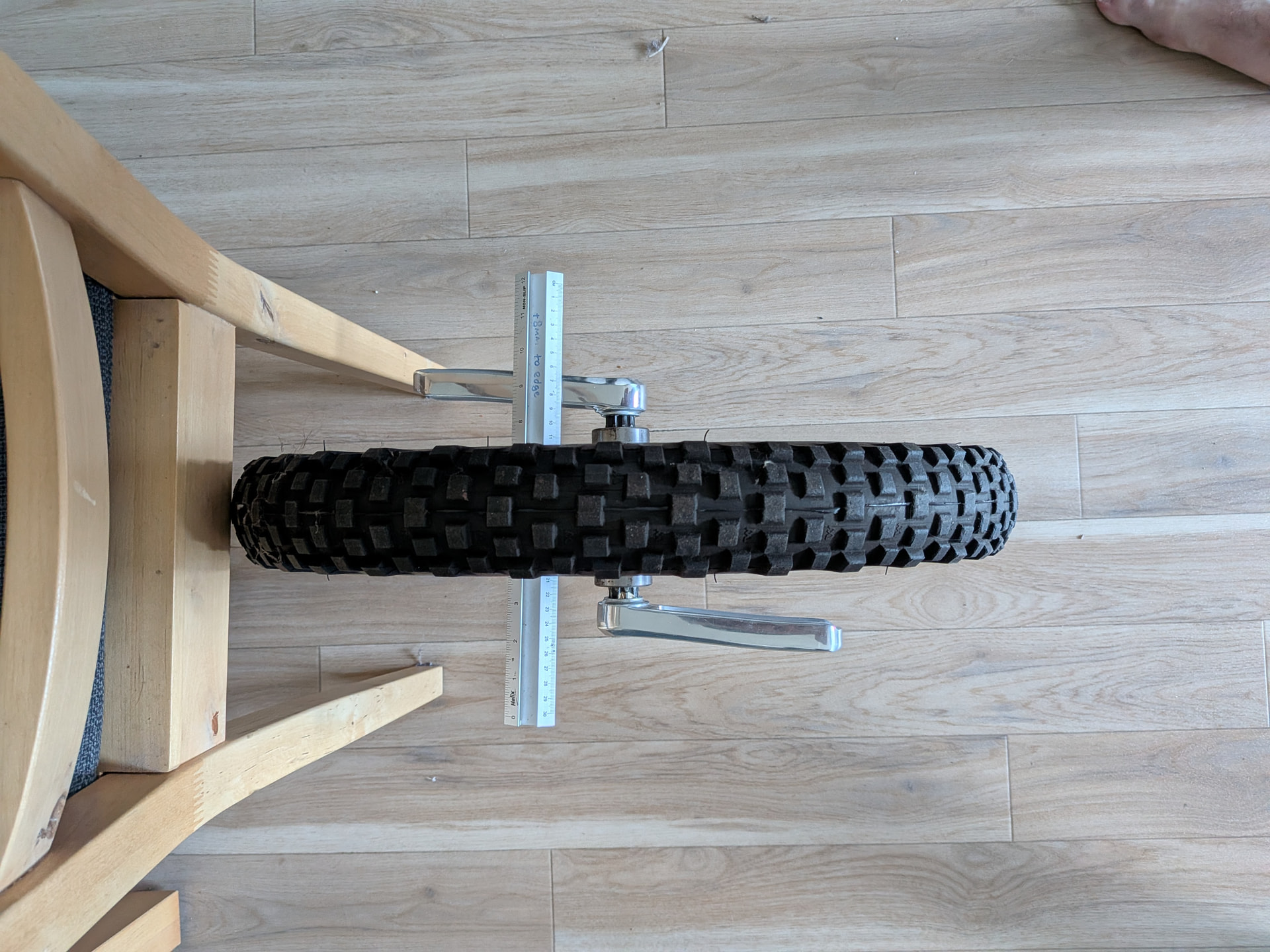

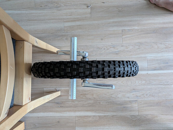

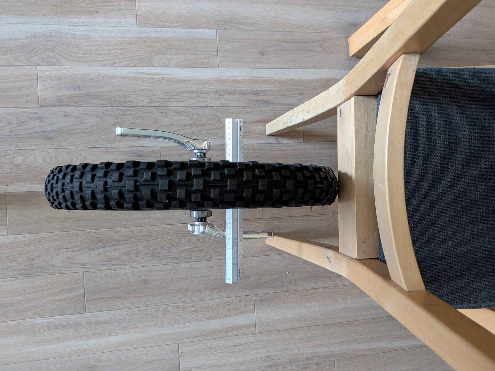

For the conspiracy side, I’ve pulled open my spares box and taken pictures of a brand new set of Spirits and a 1 install set of Moments. There are no spacers on the hub. While the intent was to measure using the ruler (which you can do if you choose), from eyeballing, the 2 sets slide on to a roughly similar point.

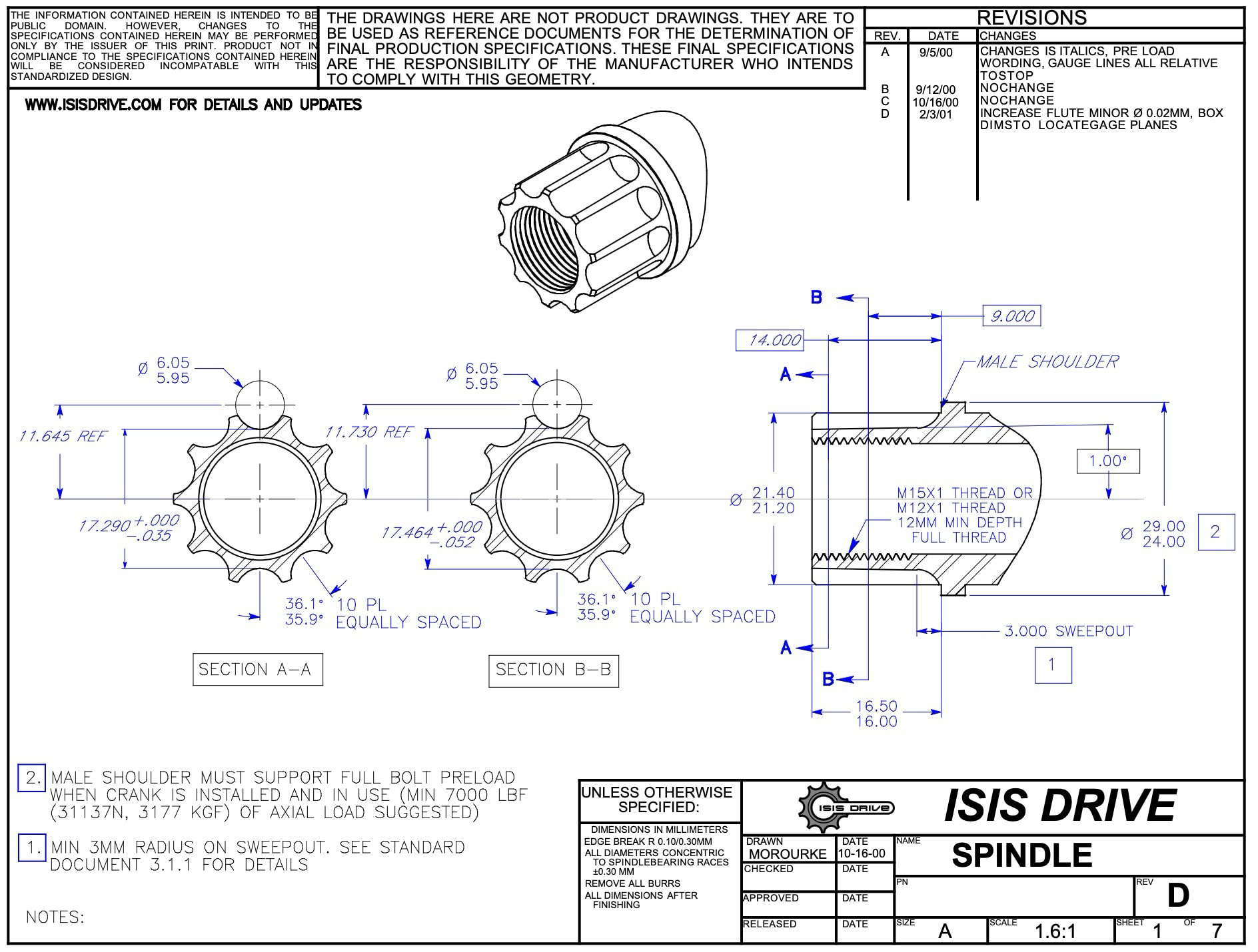

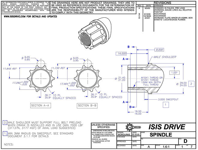

OK, that sounds more like interface tolerance. I’ve attached the specifications for the interface below. According to the specifications a 0.175 (f) - 0.26mm (b) variation of the recessed part of the splines is acceptable. That recess is supposed to be a 1 degree slope so (assuming my maths is correct) a .175mm height difference is a 1cm seating difference!
Roger at UDC UK said that there is an agreement between unicycle manufacturers to work to a tighter specification (can’t remember if it’s hubs, cranks or both) but you could still easily have a different tolerance between the 2 with both being in spec.

Thanks again for the response and helpful suggestions, you confirmed what I suspected and now I don’t feel crazy! The drawing is also very cool to see. It’s amazing how much engineering knowhow has to go into something as ‘simple’ as a unicycle. I will look into purchasing new cranks. I was not aware of the 10-install lifespan of a crank, that is also good to know. Cheers!
Some years ago I modelled the ISIS interface in CAD in order to make an ISIS to square taper adapter (no it was not a good idea, just a bit of fun) - it certainly took some head scratching to figure it out.
