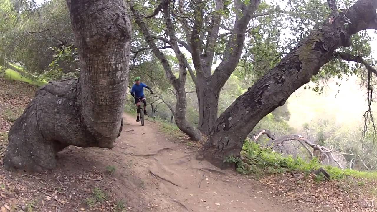

( Have you seen the video’s posted by Chad Hinkle ?. He’s unicycling with a friend and he has a freewheel uni )
Thanks for the comment! Although it takes me a long time to learn something I like to think I’m a good teacher, especially for people like myself who may not get physical things naturally. I try different things until I find out what works and as much a possible break them down into simpler parts.
Thanks! That’s me in Chad’s video! I had just switched to a larger rotor so my riding wasn’t the best but it was a good snapshot of a freewheel unicycle in the wild, at least of my conservative riding style. Next time I’m going to hop over those tree roots.
Doh :roll_eyes:
I knew there couldn’t be two people as crazy as that :smiley:

Freewheel Unicycle Helmet Cam - Hazard Peak 6-8-2014
Chad may be working on a real video, but here’s some raw helmet cam footage from a ride we did yesterday on Hazard Peak Trail and Manzanita trail at Montaña De Oro in San Luis Obispo County, California. Most people are not going to want to suffer through this!
